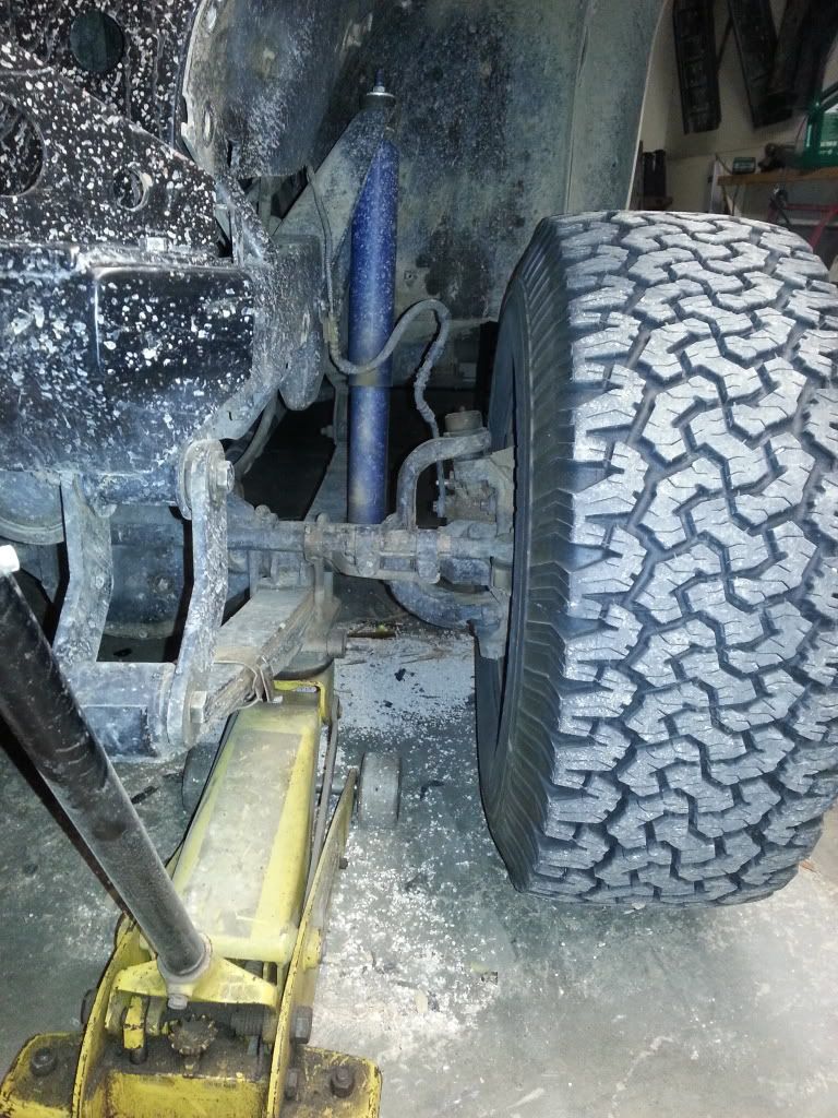

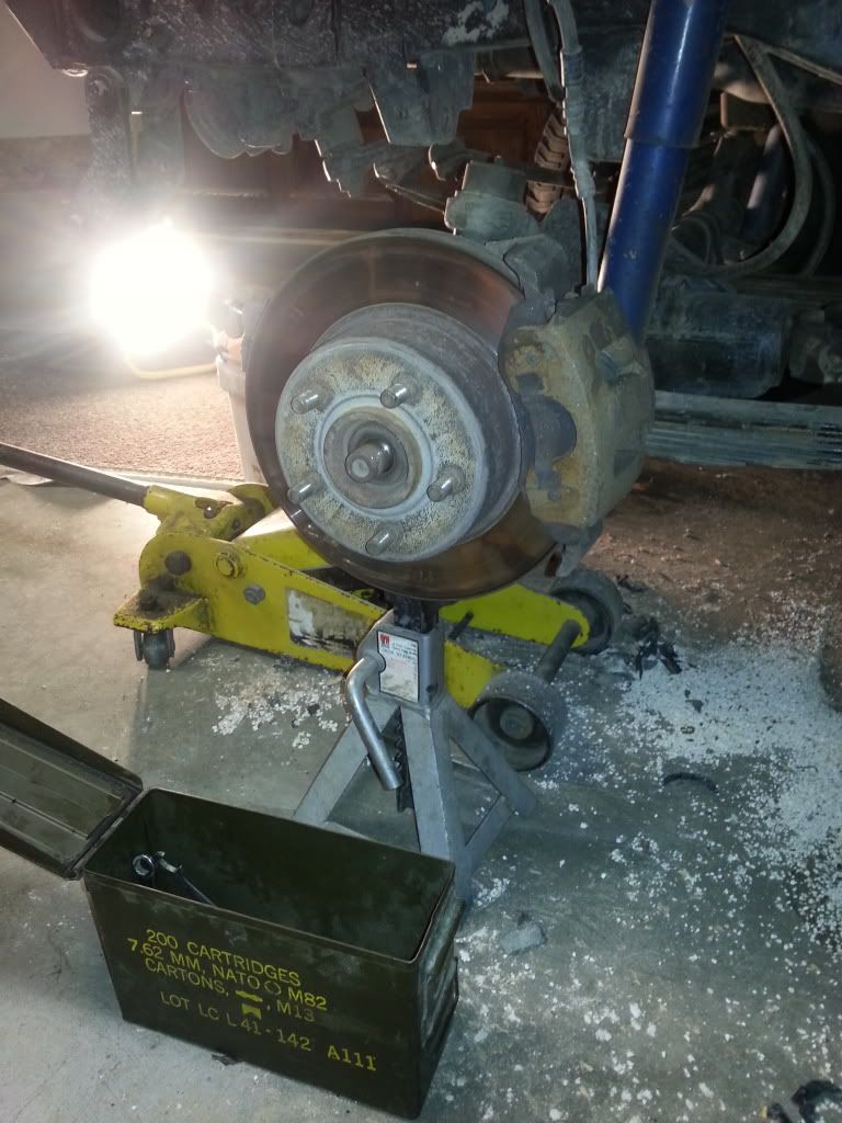

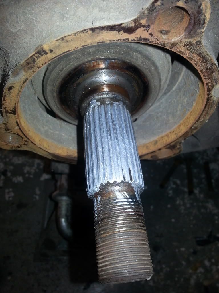

Nothing spectacular but I changed out a bad unit bearing for a good one. Quick little job turned into a 2 hr wrestling match with the axle shaft and hub damn thing didnt want to come out.
Made sure I put lots of anti-seize on the splines .
Putting the caliper back on I like to use a c clamp and push the piston in a bit to make it a little easier on me.
All buttoned back up.
