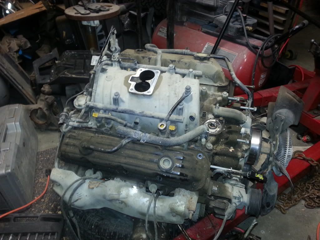

Thanks bud I was beginning to think people quit reading my thread. Here is the new to me motor. I Plan to open it up and see how things look amd if she checks out I will button it back up and start the swap not a bad deal for only $150 just need bellhousing and computer for a manual, a in tank fuel pump and a **** ton of other things I plan to make my own motor mounts like moparfreak did.
Heres to a fun fall of wrenching!!

Yeah congrats dude on the new purchase im going to be taking my time with this swap. I read almost every night searching and studying this I hope it will go smoothly with very few hiccups.
The scrap yards around here suck and the only mopar guy in town is a huge dilweed we exchanged a few words last week when I tried to explain the swap to him and he just kept telling me I didnt know what I was getting myself into. This isnt my first rodeo so wont be going back there again what an arrogant prick!!
If I didnt have craigslist I would be sol. Im finding not a lot of dodge rams find there way in to scrap yards and if the do its an automatic.
This motor came with a pretty well intact wire harness minus the computer, I already removed the valve covers and watched the rockers move as I turned it over, other than some carbon build up this motor is pretty clean. I will remove the oil pan and check crank and rods too before I bolt this baby between the frame rails and fire her up.

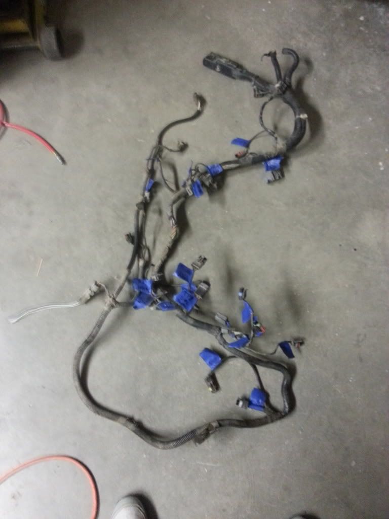

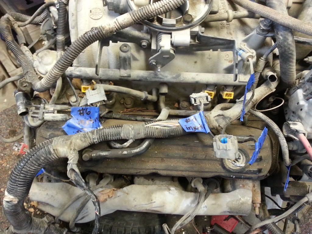

Started pulling the wire harness and labeling everything so I can remember where it came from and where it goes back. I need to start studying the harness and how I need to wire it with my jeep harness.
As soon as I get this harness off I will start cleaning the motor up check everything and make sure its good to go in as is, or if its going to need a rebuild. Fingers crossed its in good shape.

Got the harness completely off and labeled, some plugs were already disconnected but I have some good ideas what they go to. It went fairly easy

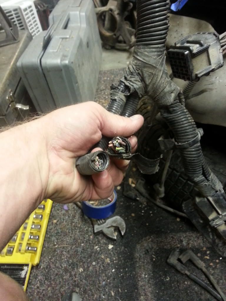

The PO did cut these wires he said its where they went into the firewall. Hopefully he didnt hack something I needed ha ha
Started removing some crap so I can get in there and clean it a/c compressor off, alt off, and associated brackets. Im done for the night.
I got to clean up my work space,what a dump!! Then get the 4.0 off my engine stand and get this pig bolted up so I can do a compression test then drop pan and check rod and main bearings. Wohoo!! Im making progress.

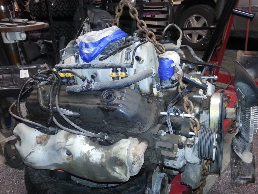

I spent the night degreasing and cleaning up my motor and shop I think I will take the day off of work tomorrow and hit the garage an clean and organize it without any interruptions from wife and kids. Then I will feel comfortable carrying on with this swap.
Its pretty greasy
That's the wires you're going to identify and label. They will be spliced into the corresponding wires on the yj bulkhead.
Sweet thanks. I need a schematic of a '93 grand cherokee and hopefully I can identify where they go. Does anybody know where to get these?
