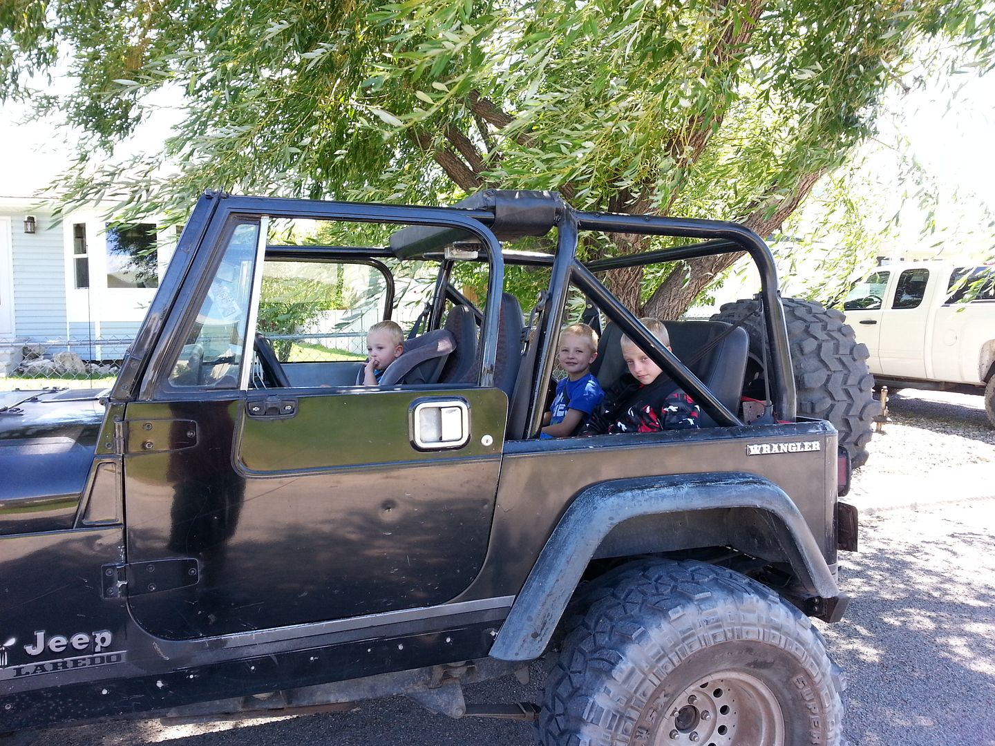

Got her back on the road today and ready for this weekends wheeling trip.
Then took my boys for a ride
