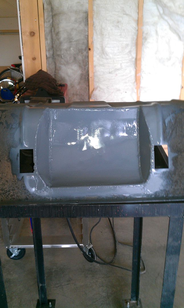

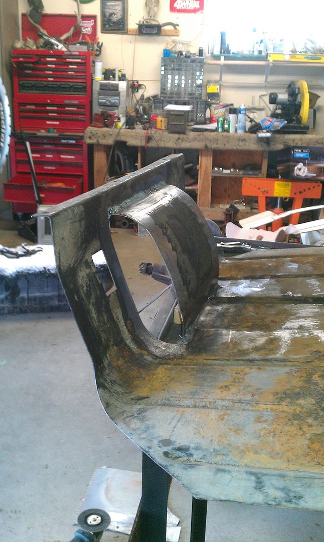

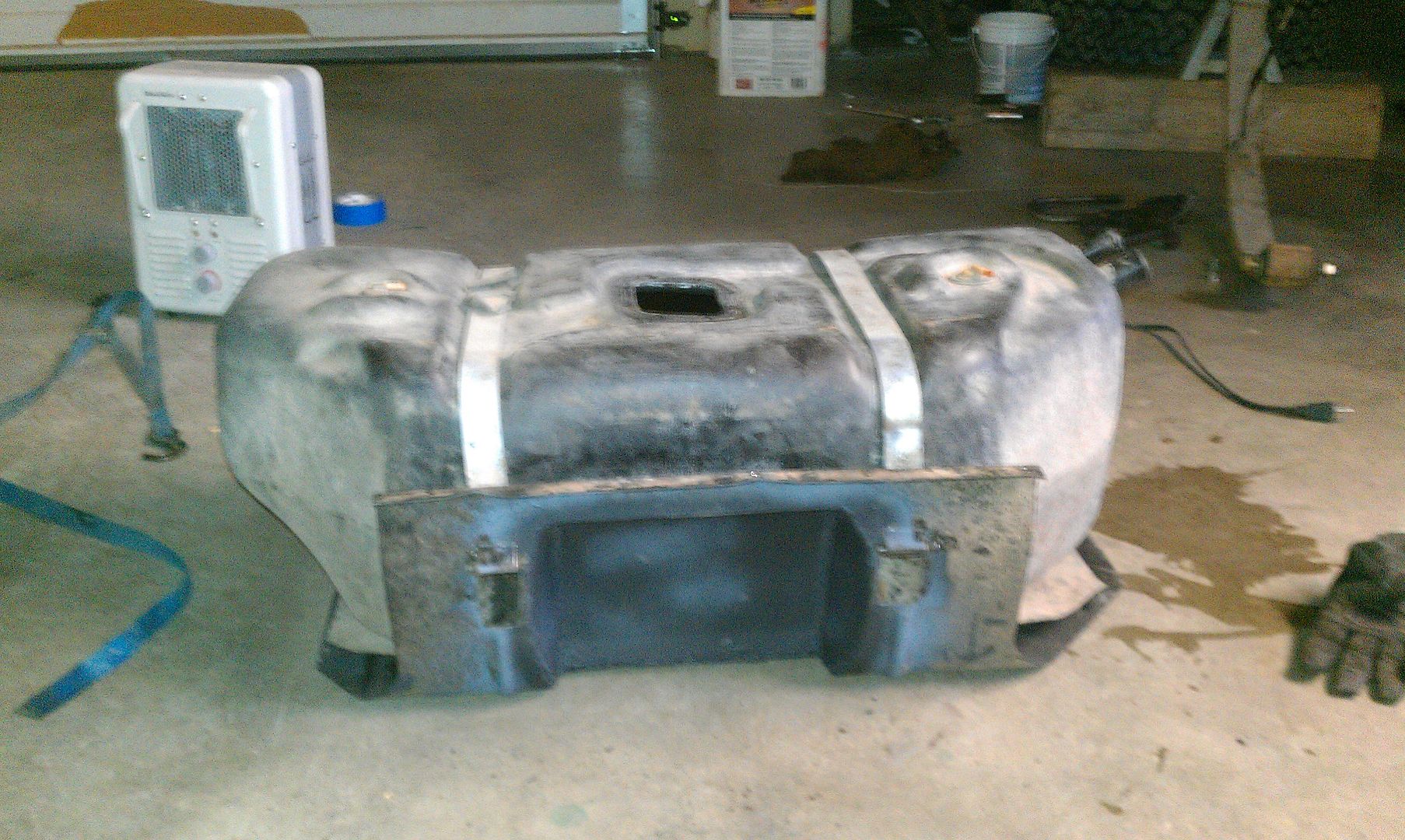

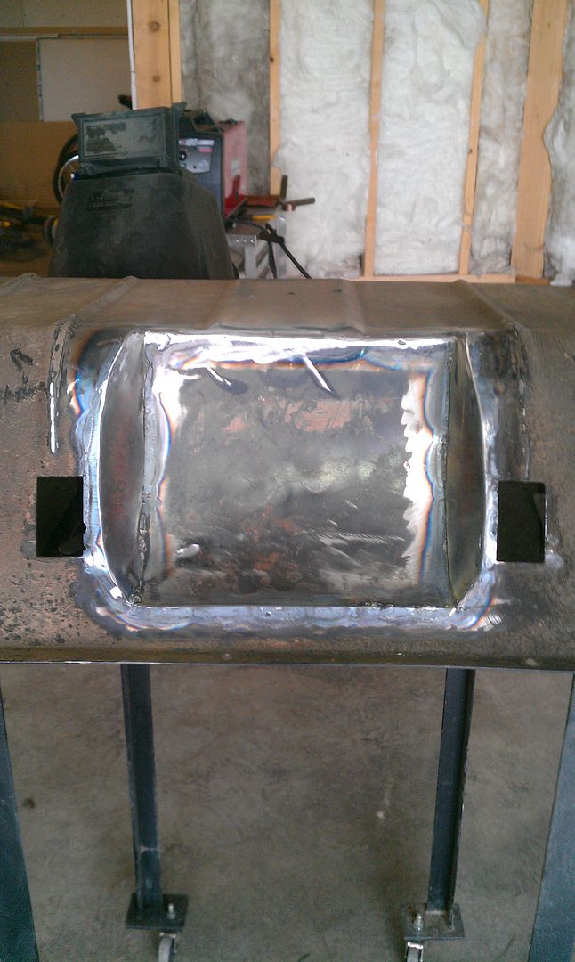

Since the 8.8 went in I knew I was going to have diff/tank issues I couldn't afford a bling stretch tank so I used a thread on pirate4x4 on how to make my stock tank work. So I got to work.cut out the basic shape into the skid I cut out about 3 to 4 inches then rotated the piece I cut out 180*.
welding in the sides:

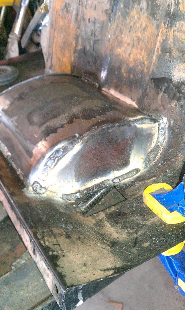

welding up the outside:be sure not to have any sharp or abrupt edges so as not to cut or score the tank
Primer:

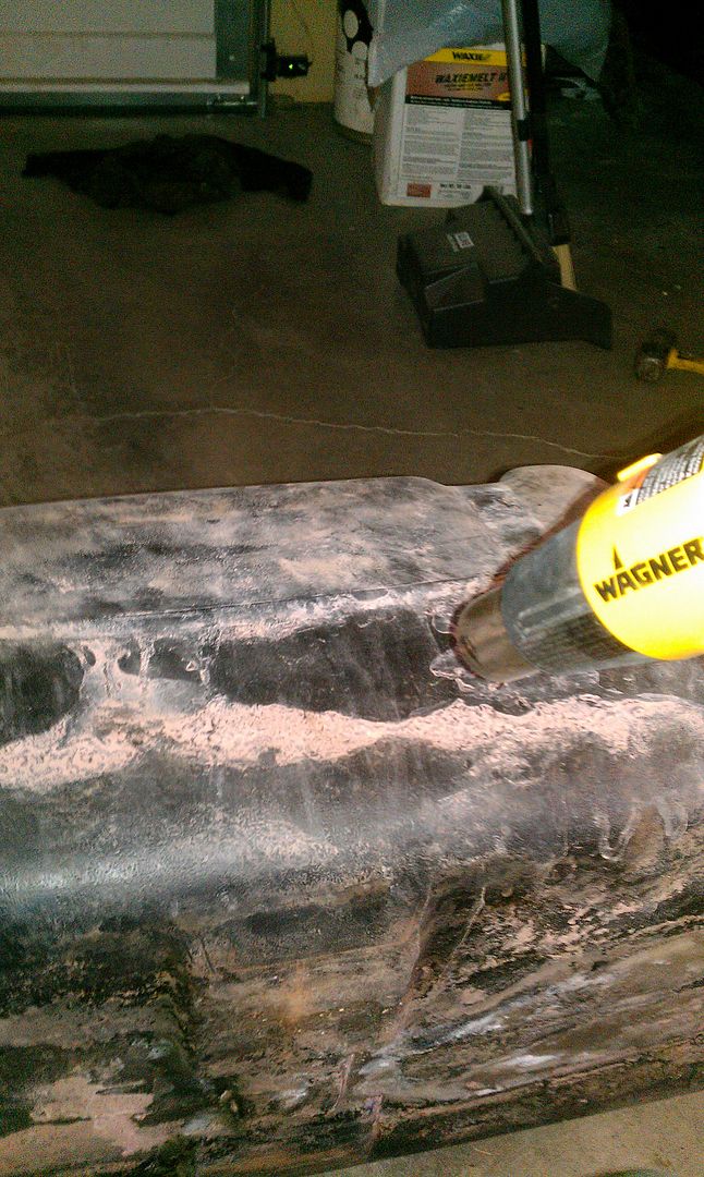

heating up the tank:This didnt really work too well I made a call to my stepdad and we combined the heat of my propane torch with a wide angle tip and his propane torch to give it a good even heat then after about 45min of careful heating it was definately plyable enough to slide into the skid. This is the most important part it needs to be heated very carefully so as not to burn a hole thru it. this is some really thick stuff so be pateint .
finished product:I had to modify my pickup tube a little to make it work. I removed the screen off the tube and cut the smallest amount I could off, then slightly bent the tube up so it didnt jamb on the bottom of the tank. I have a carb so you guys running fuel injection may have different problems.

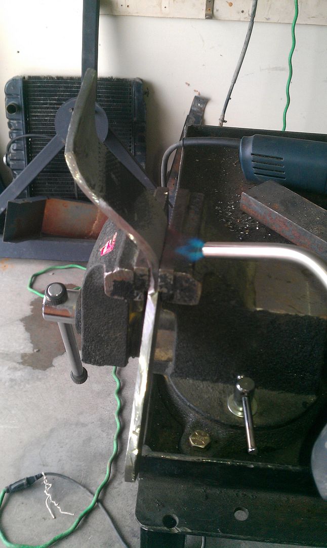

When I installed the 8.8 I knew I was going to have to address my shock situation. Since my jeep sits pretty low I wanted my shock mounts up out of the way. I needed new shocks anyway so I made my own axle shock tabs out of some scrap 1/4" steel I had laying around. I made a thread on my M.O.R.E. inspired upper mount relocation brackets but with a twist since I was running waggy springs my shock angle would have been horrible so I made these. http://www.jeepforum.com/forum/f12/s...sions-1345960/
Here they are installed:
and a fun little test drive to try them out:

Location: Hale'iwa
Posts: 5,092
my tank started leaking after a few years. the heating with a torch made the plastic a bit more brittle. i ignored it and it stopped. make sure there is something insulating the tank from the corners.

Posts: 4,309
I saw you say that in another post too. I sure hope that doesn't happen to mine. It's been in there for about a year now. I did use a thin rubber mat between it was already in there between the tank and skid plus I flap wheeled the piss out of the skid to make it smooth. In the thread on pirate I haven't heard anyone mention this, not sayin it won't happen. Thanks fratis! I have always liked your advice.
