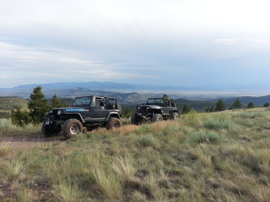

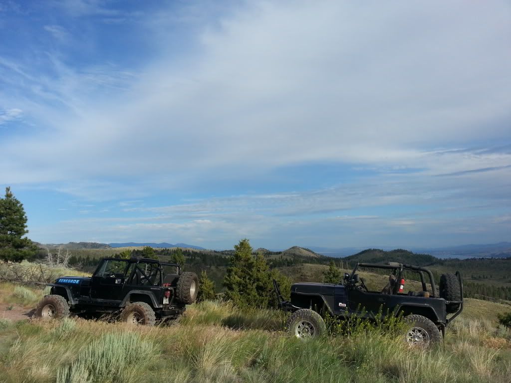

Went for a fun little trail ride tonight nothing difficult but the view is spectacular!
Tried the new panoramic app on my phone
View of the lake in the background

Nice shots, what suspension is your buddy running? Looks tall

Stock yj springs spring over on 14 bolt rear dana 44 front with 37's. Hes got all chevy running gear from a Chevy 3/4 ton truck sb 350 sm465 trans 205 transfer.

That rig looks like a beast. Some serious mods right there..

Yeah it was hacked together when he got it, over the last six months he has put a lot of work into it and its nice to see all his work pay off. Still a few more fixs under his sleeve, but at least he can drive it down the road without killing a bus full of puppys.
