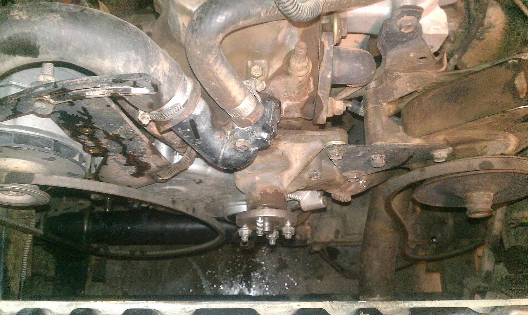

This is becoming to common of an accurrence with my jeep lately. Oh well my own damn fault for not replacing it when I had the the front end all tore apart for the timing chain.

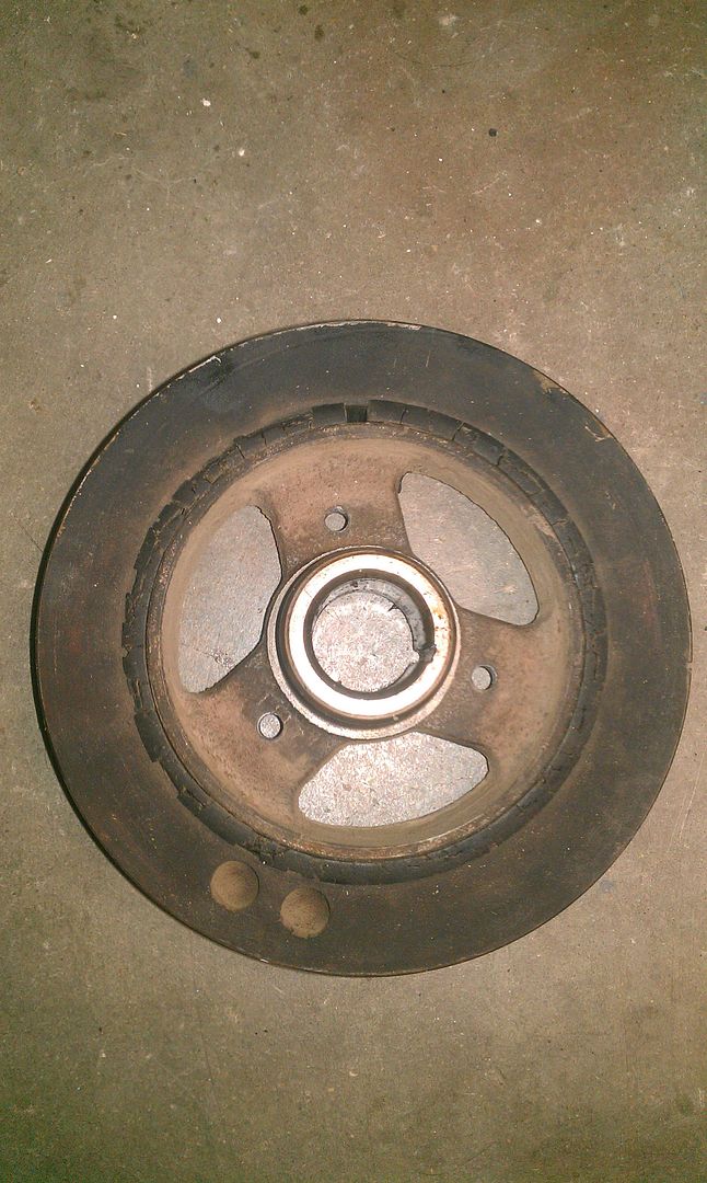

And for good measure a shot of the toast damener.

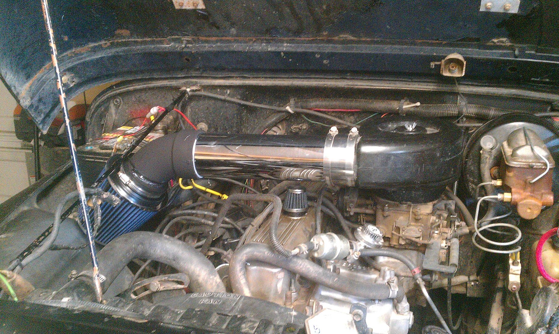

Working on a cold air intake while I'm waiting for parts to show up. Using parts from when I had it on my truck then I sold the truck without it. Not sure on the position I'm using a pvc 45* elbow to turn it down so it doesn't hit the hood. Looks like it will clear.

Rotate it 90* to the passenger to drop the filter on the opposite side of the motor. You'll be sucking hot air coming off the radiator that way unless its just the picture angle

That's what I was thinking of doing even mocked it up that way I was just worried of all the heat rising off the motor heating up the tube and making it hotter. the way it is in the picture is right up against the drivers side headlight bucket, which would suck hot air off the rad.

Put header wrap around the portion going over the motor if its a concern, but I don't think it will be. It's better to have a cold air source running past a hot motor than having a hot air source that has a cool tube

Agreed! I shall set it up that way and when my my dampener arrives I will try it out. I know my round paper filter air cleaner was sucking nothing but hot air so this should definitely be an improvement.

Ok boys got her all back together. Install went smooth minus having to remove rad to get the darn tool in there to install dampener.
Alright set timing at 8* btdc with vac line disconnected and plugged, runs great no knock or ping. Hook up vac advance and rev motor and watch mark go off the charts 19*+ and all over the place and knocks Son of a......
So I'm back to square one with it, but at least I can see my timing, and where its going with the vac hooked up. I think I may try replacing the vac advance unit and see it I can get an adjustable one or should I try changing weights in my dist??

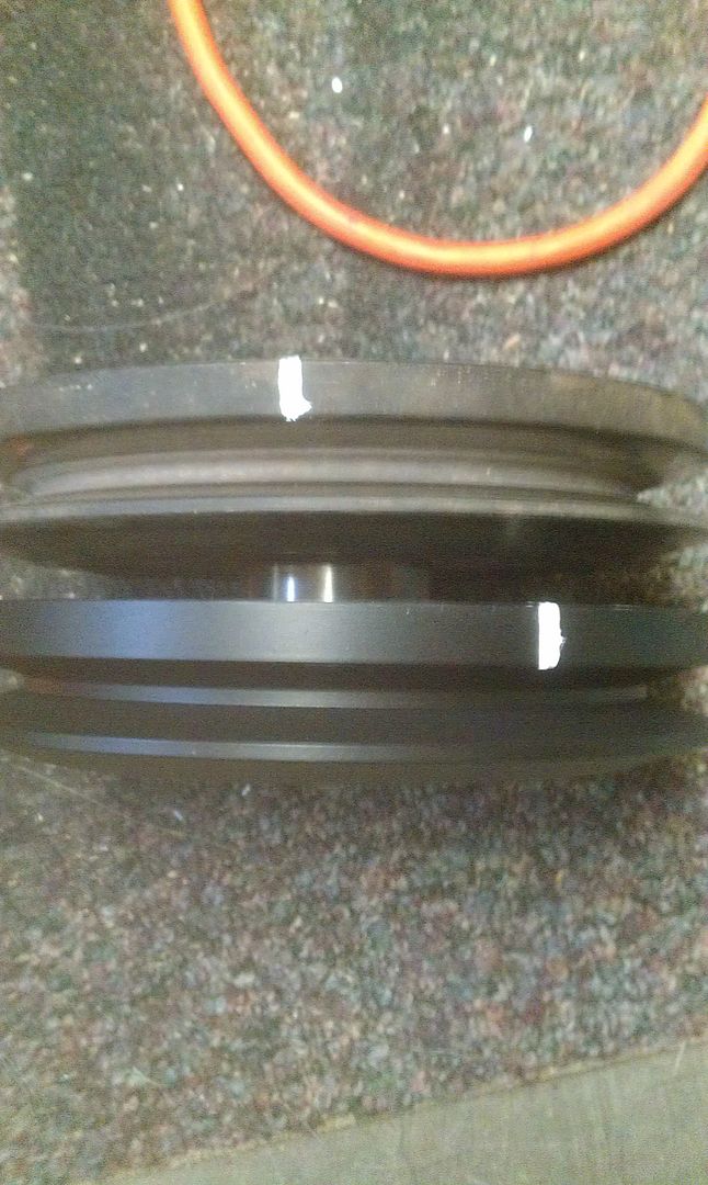

Here is a shot of the comparison of the old and new dampener.

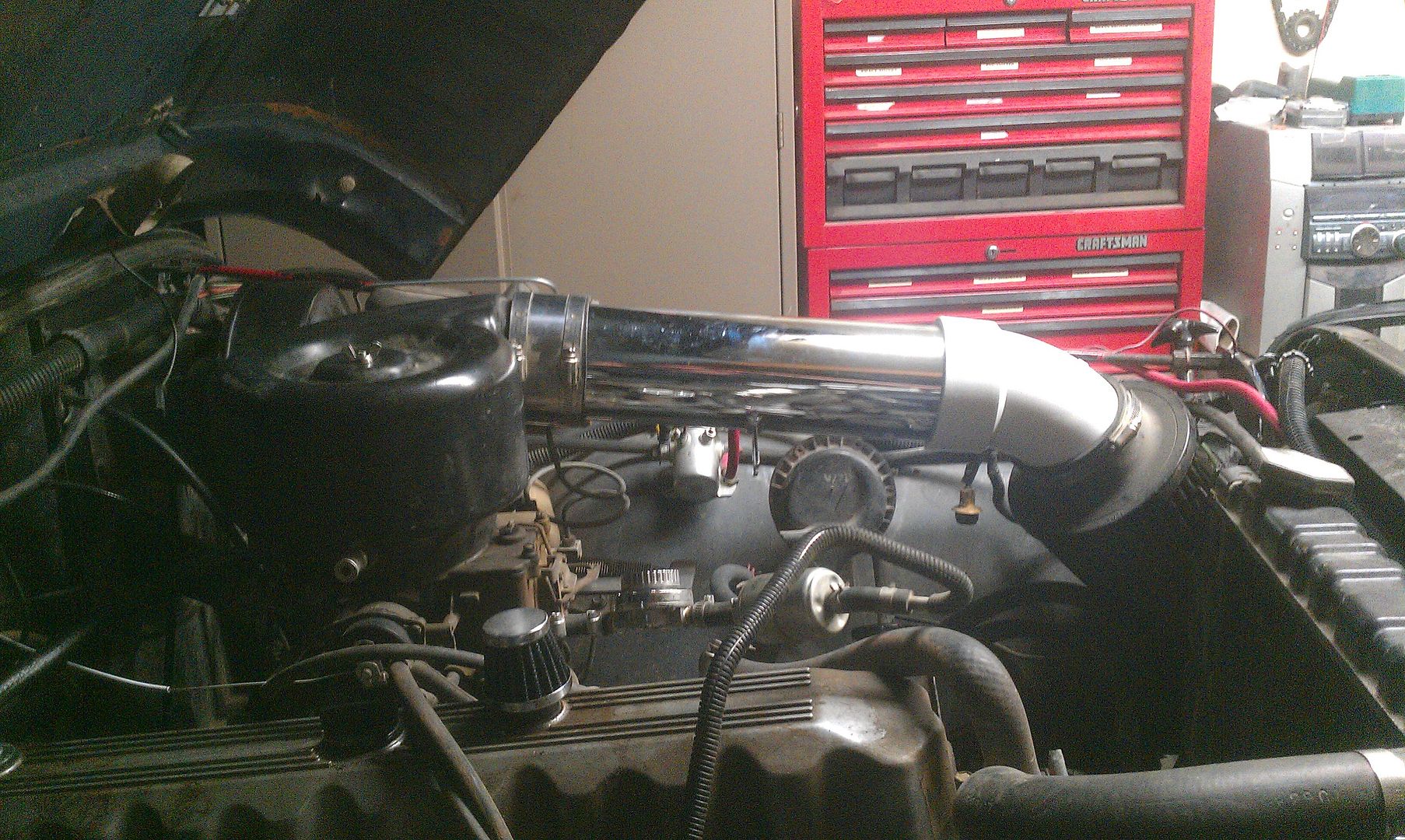

I also finished up the cold air intake, hopefully I can get some better air flow.

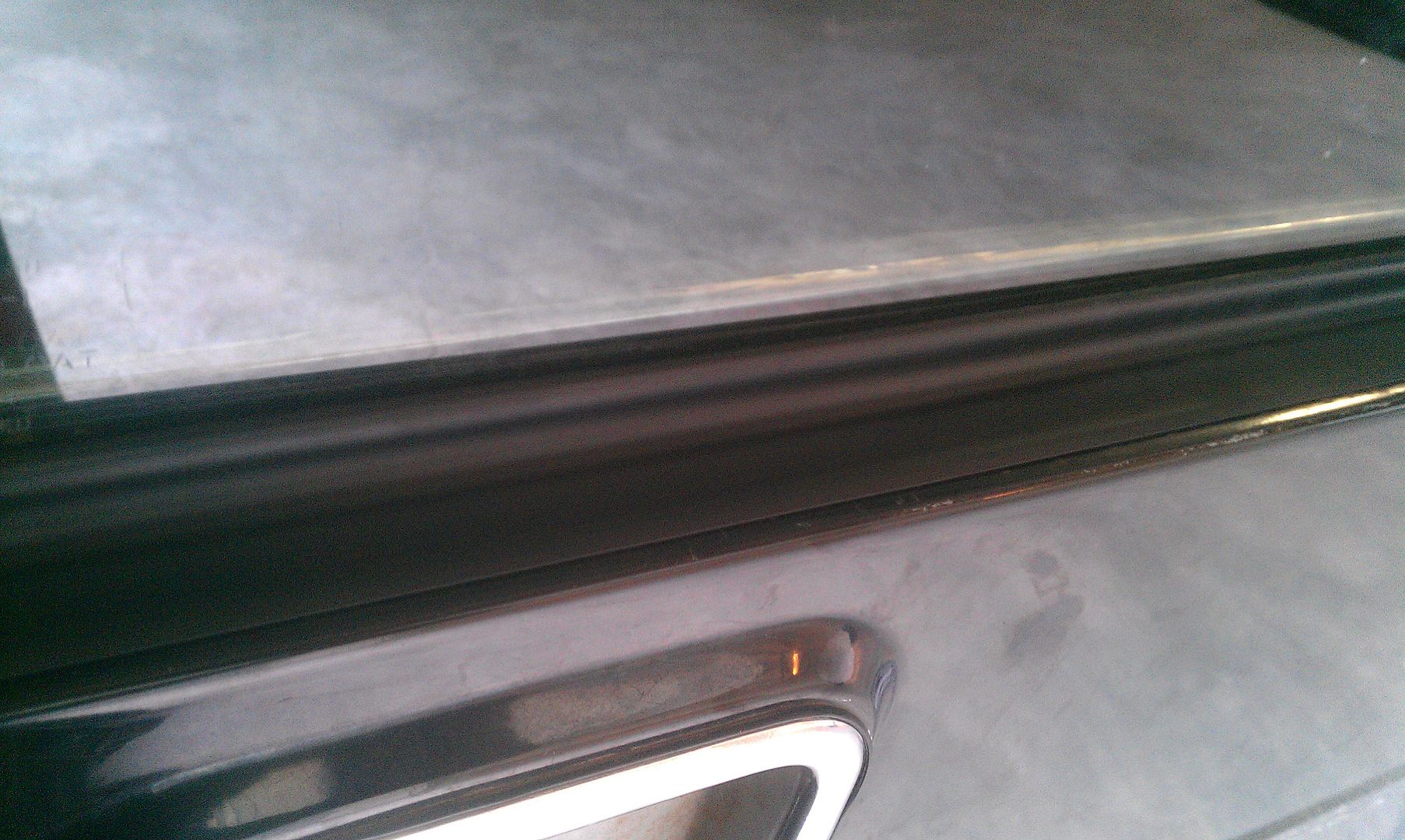

Then I installed my new outer window door seals.

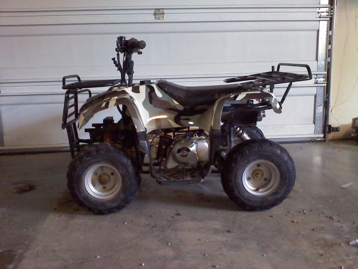

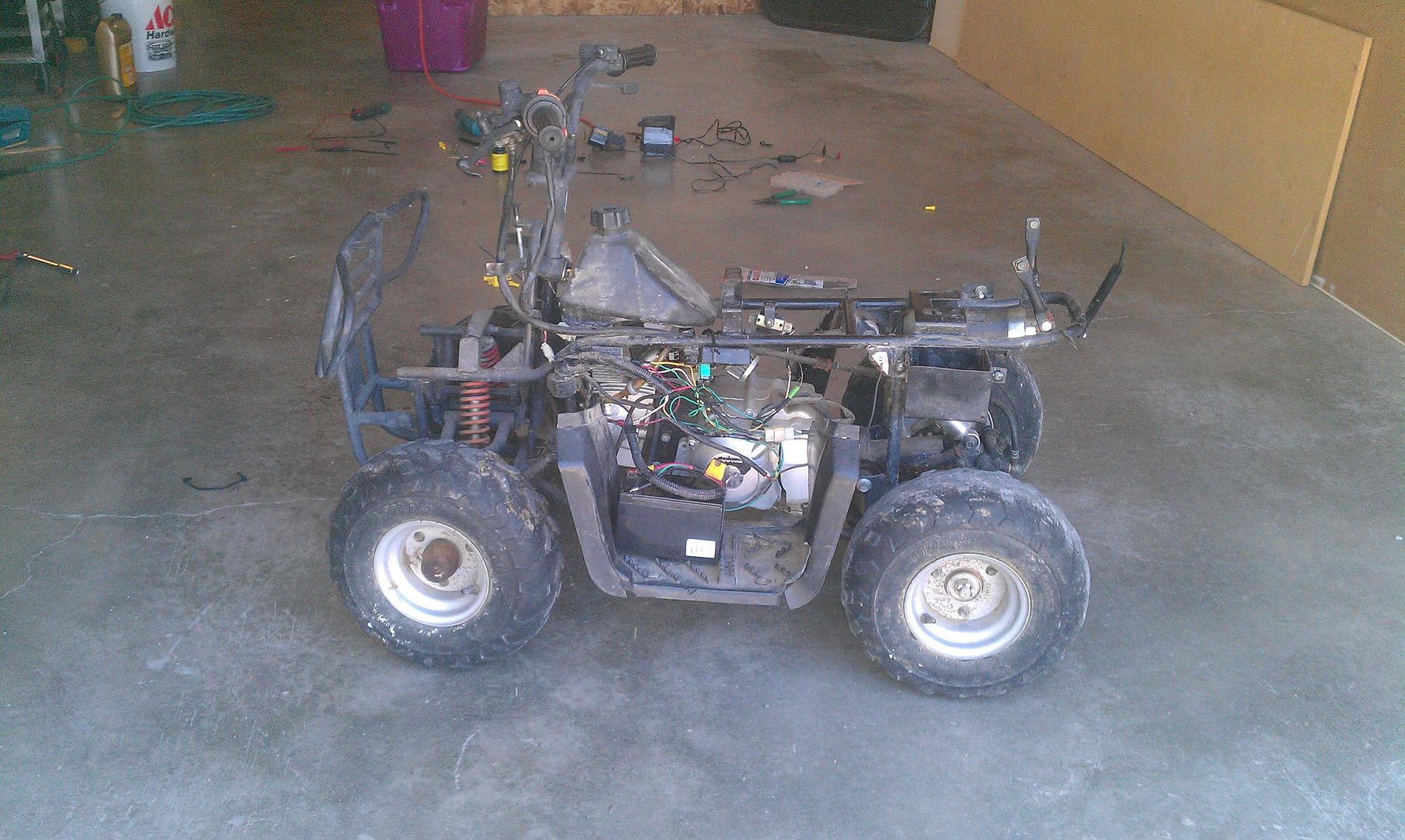

Anyways got my kids POS Chinese atv back up and running, I rewired the whole thing, removing the tether, remote start, and safety switches galore. What a pain!!
Before
After

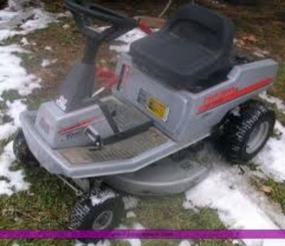

We actually have two of these things,but we are gonna scrap the other one and build an offroad kart combining it and this 10.5 hp lawn mower
We are going to make it a budget build I got lots of scrap steel for the frame, and we are going to use all the suspension/steering off the fourwheeler it should down right rip with the proper gearing. Might even give it a jeep grill and hood to give it that buggy look.
