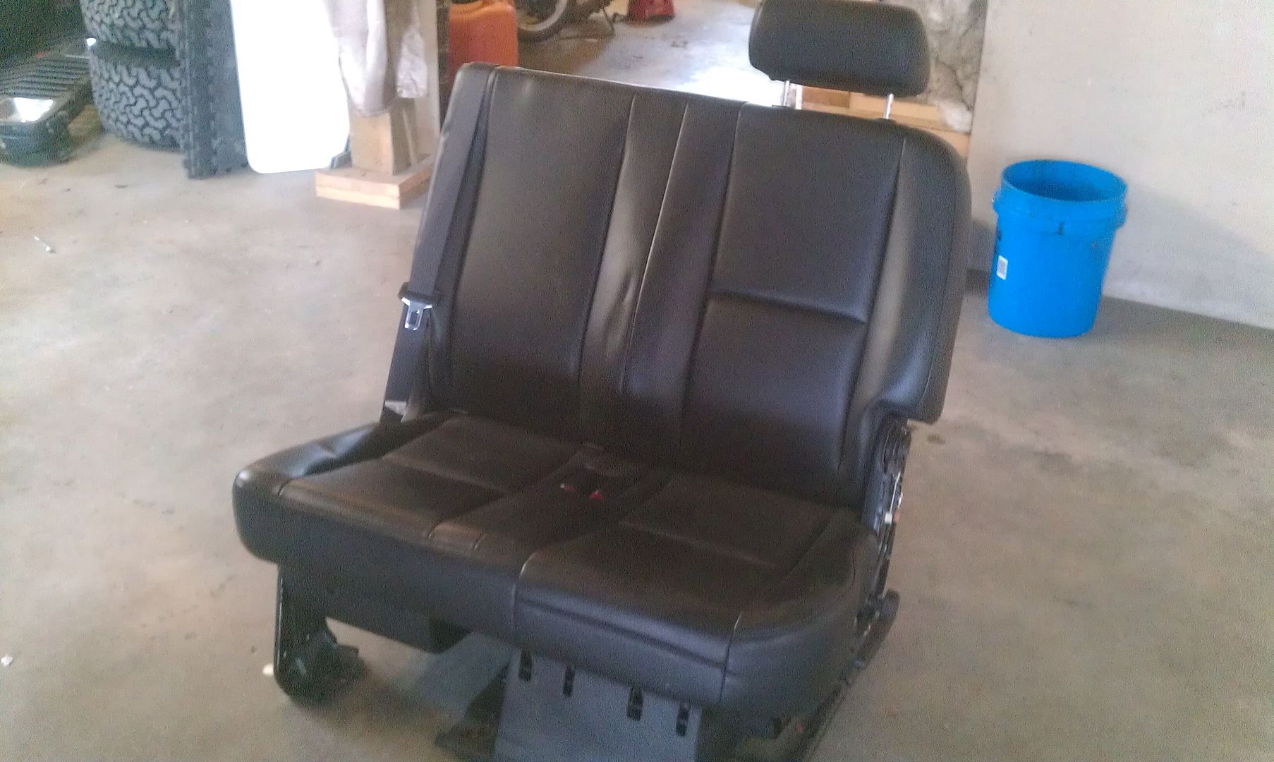

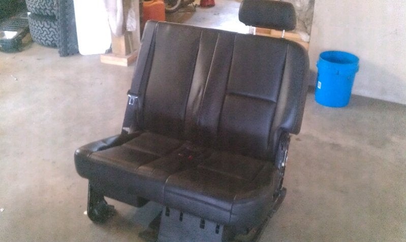

Ok so i will pickup where I left off. I got this middle row seat out of and 07 suburban off of cl for $25. It's a fold and tumble just like my YJ seat,
as you can see it needed replaced.
So I was determined to fit this baby in there. I new the factory base would raise the seat to high so I removed it from the seat frame.
Had to weld a nut to a torx bolt argh!!
Next I removed the padding from the lower half, which is really easy I was suprised
To be continued.........

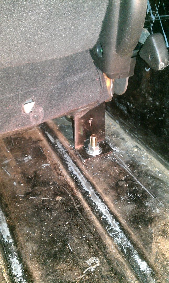

After I removed the padding
I was able to safely weld to the frame without worry of ruining my sweet seat. I cut the two pivot points off the frame and evenly spaced then across the front and welded them on.
Then I cut the pivots off the base.
Made floor plates out of 1/4" to attach them to the existing seat floor mounts through the tub.
Tack welded them on.
Then I made a bracket to attach my belts to the seat frame.
Then I re-installed the lower cushion, the belt recepticals fit perfectly.
Made little footies for the rear of the seat to bolt through the tub with a 1/4" plate underneath.
Test fit of everything before I pull the seat for final welding of all the brackets and mounts.
It took me most of the day in the shop to make this work. Total out of pocket cost for this mod was $25. I really don't count my time since I love to fab and make things work that were never really meant to be. I plan to make the footies quick release, since this seat will fold and tumble just like the YJ one and I can still have a little space to carry stuff.
I am completely happy with it and now my kids can sit comfortably in the back of my jeep.
