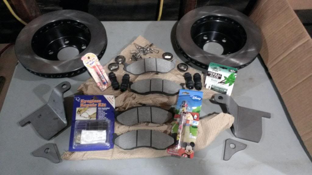

throwing a little black magic in to the mix, not sure if my favorite item is the fanta orange lip smackers or the minnie mouse disney pen
brakes are amazing and i'm still breaking them in

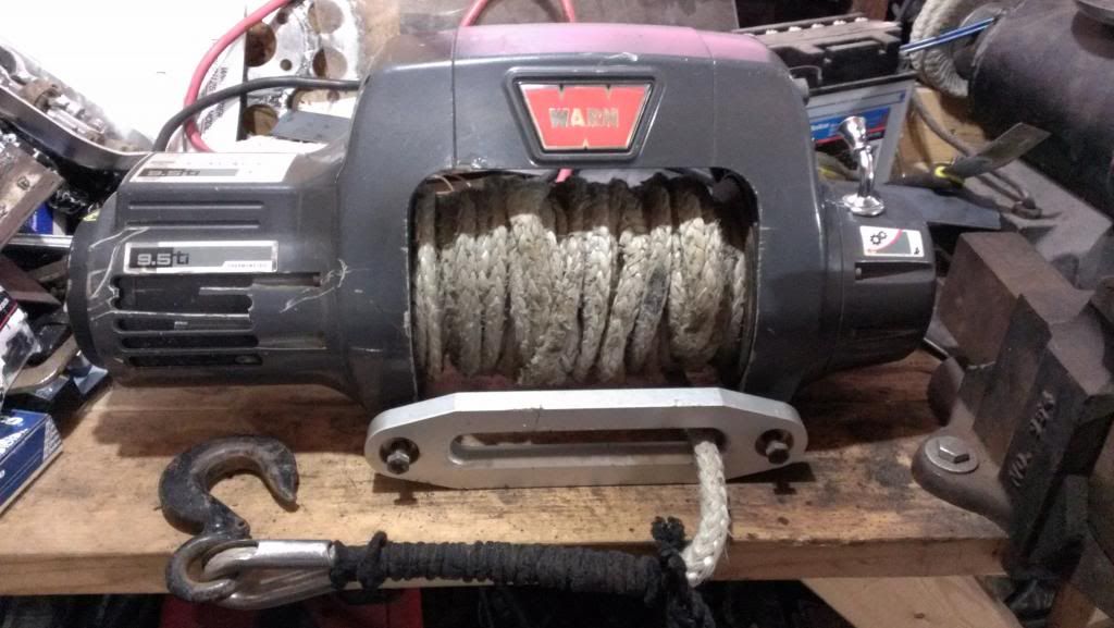

snagged this off CL for cheap, its got some cosmetic damage but works fine so far and free spools well. PO said it was rebuilt a year ago but i havent put it under load yet. not sure on the rope and i've located a new shell for the damaged fins thats only $60. I think I got a good deal, even if I have to replace the rope

drove my friends tj the other day (05, auto, 1.25" BL, 1" MML, 31x10.5 goodyear SA, 3.73) and it felt super heavy. a few weeks back my jeep was the heavy one and this one felt really light while stopping. what was i thinking waiting so long to upgrade breaks. I have no doubt that my jeep has more breaking power, even w/35's vs 31's and hard top vs soft top
they really are magic

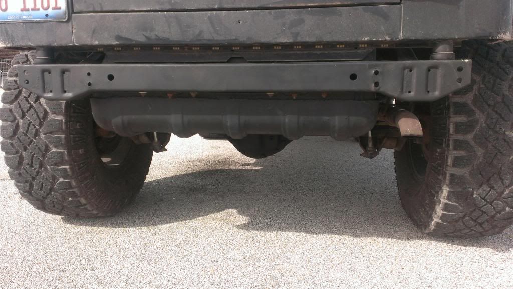

installed a set of 3" BDS springs for the front tonight. got the front back up to a reasonable height after adding over 150lbs on the front bumper.
5.25" between front tire and flare - 3" uptravel, 6" down
5.75" between rear tire and flare - 4.25" uptravel, 3.75" down
24.25" ground to slider
19.5" ground to frame
18.5" ground to skid
engine skid should be in on wednesday. I grabbed the aluminum one from UCF. seems like it may be time for a new radiator. 140k isnt a bad life

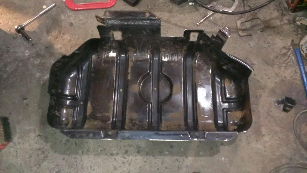

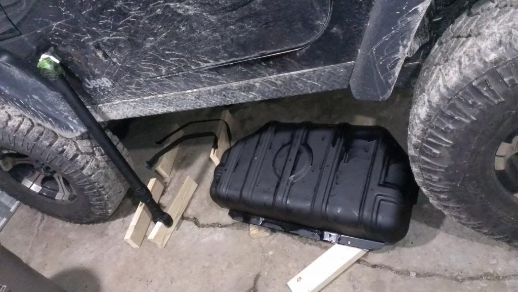

modded the stock gas tank skid so it sits up an inch higher and i was able to move my axle back about a half inch to get the wheels centered in the wheel well and didnt have the track bar rubbing
also, rebuilt my front drive shaft and its ready to install

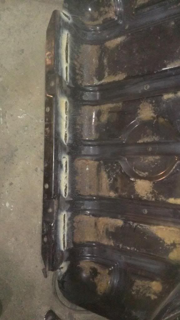

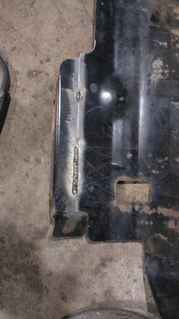

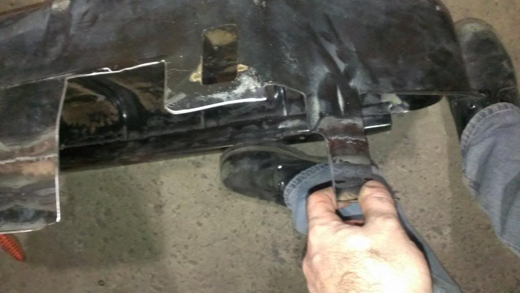

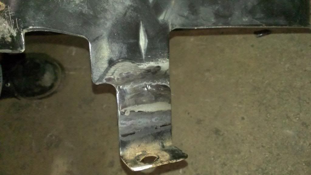

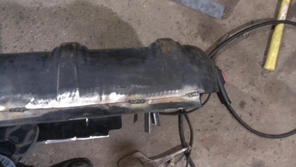

a few. just cut all the mounting brackets and welded them back on an inch lower
i smoothed out all of the welds because of the nylon tank
notched this area for added track bar clearance
hit it with some spray paint, that looks like crap because it was 34 deg out and just a torpedo heater in my garage
installed, i sprayed the cross member and diff cover while i was in there
also had to cut the tank straps and add about an inch of some mild steel scrap i had laying around. was trying to get everything done before a st pattys day party so i stopped taking pics
took some effort, but only cost me some time and some welding wire to gain an inch and let me position my axle the way i wanted
