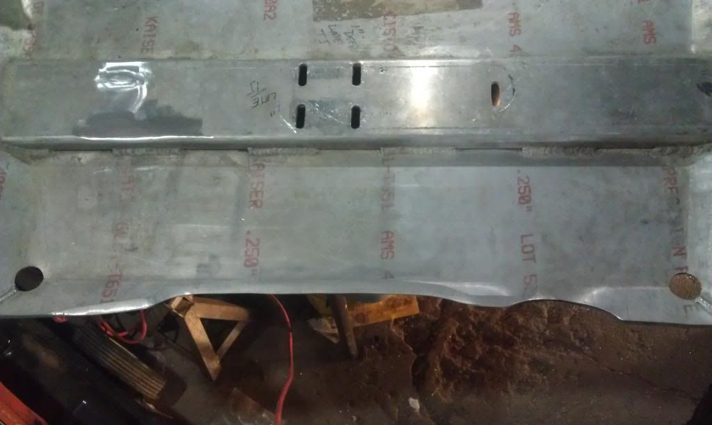

i thought i had a pic, but i cant find one now. i'll take one tonight. basically in the same place they are now, just behind the TC. I used the UCF bracket and drilled two holes in the angled lip on the back of the skid. then attached the bracket using two 1/4" bolts, and attached the pumps using the oem bracket and two 1/4" bolts. its not the strongest possible,only using 2 of the 4 holes on each bracket, but its solid, doesnt rub anything, and i dont think it will ever be an issue.

had to cut the exhaust hanger and i will be clearancing the skid a bit in the next few days, currently it is just barely touching my trans pan, but should be easy. the tricky part is getting a lopro to work with it. i'll take lots of pics as i bet i will be dropping and lifting this skid many times in the next few days.

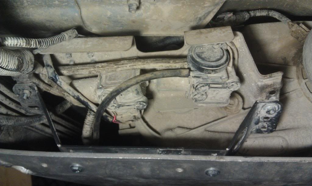

Here's the temporary mount I'm using

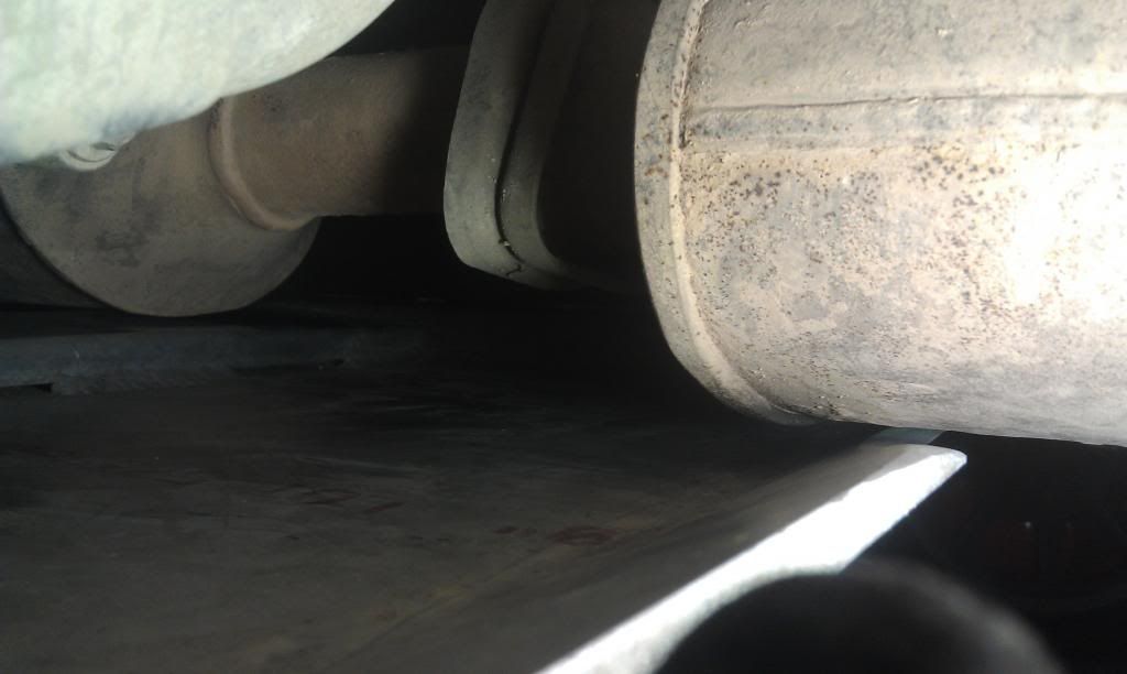

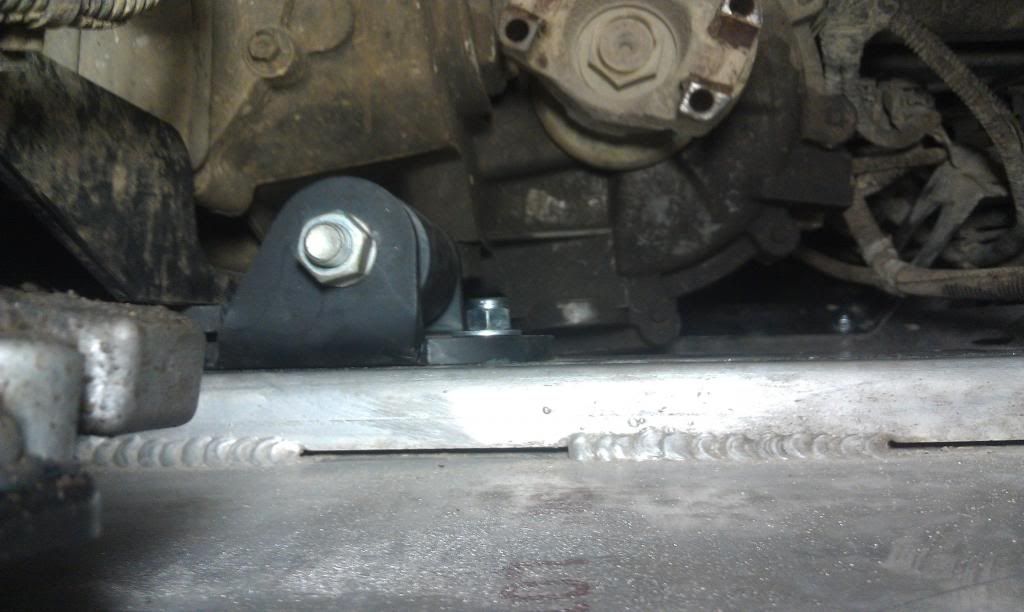

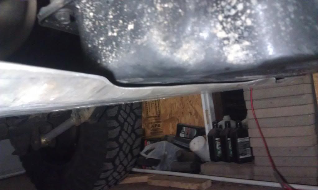

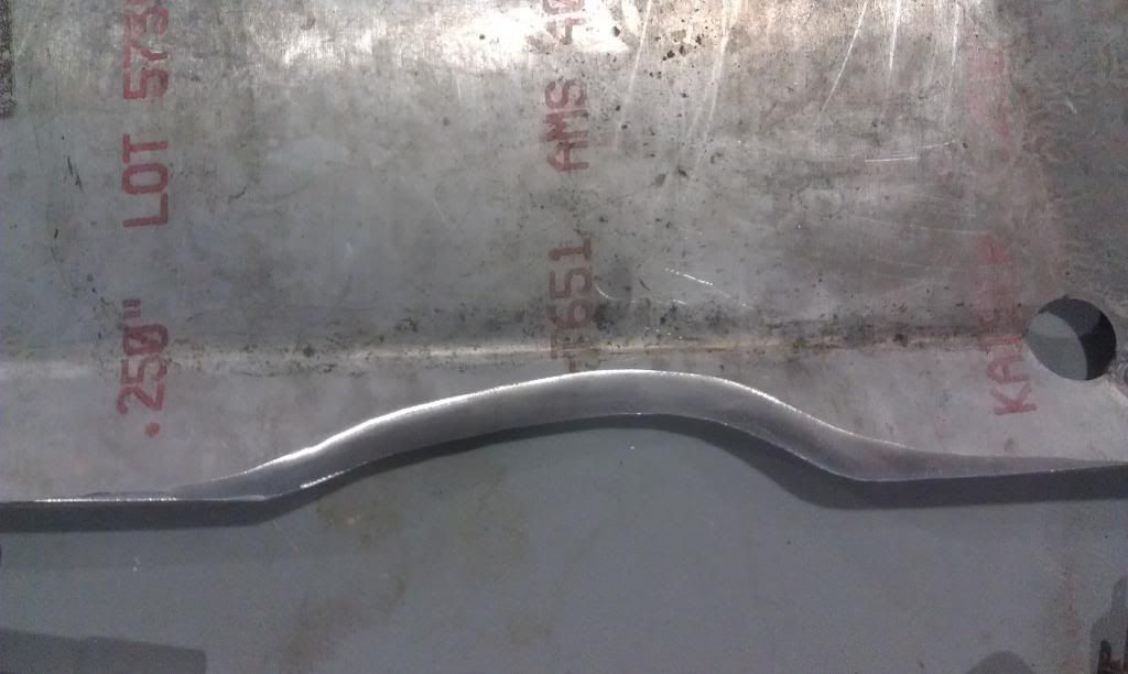

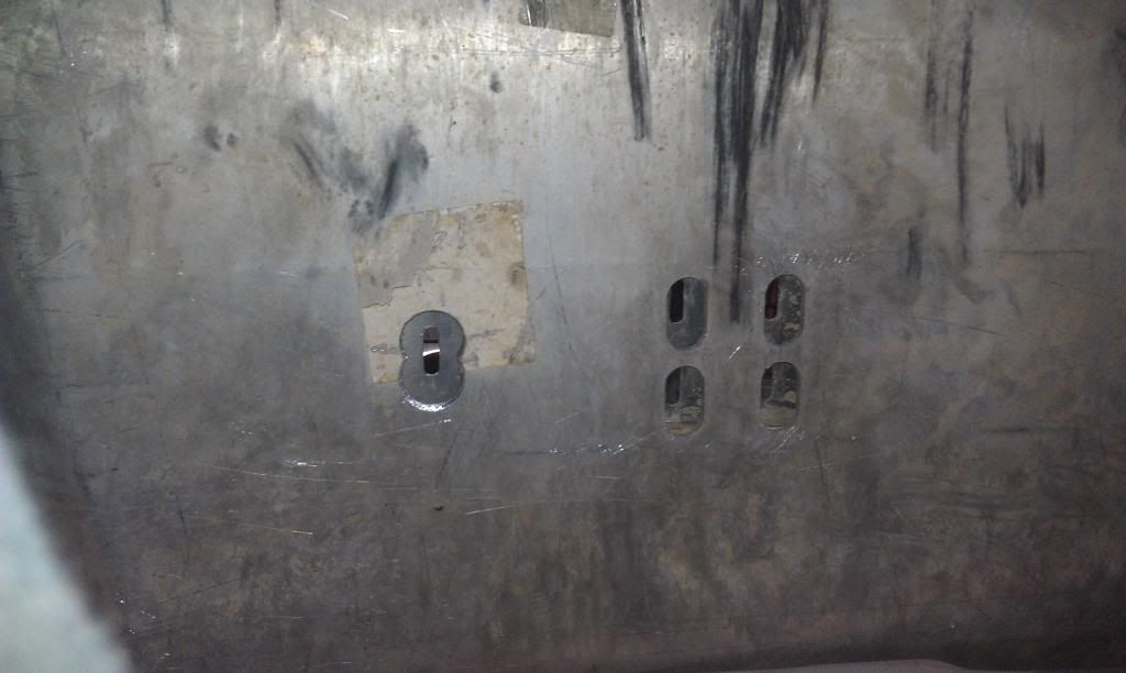

the final pics after modifying the skid to accept a Lopro
LoPro
temporary locker pump mount
exhaust clearance
