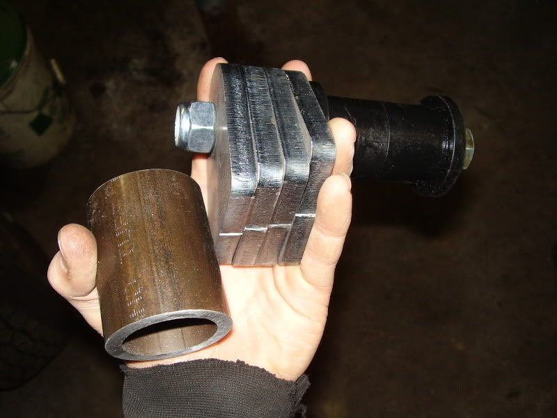

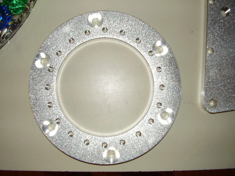

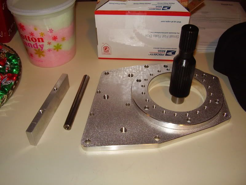

Plates:

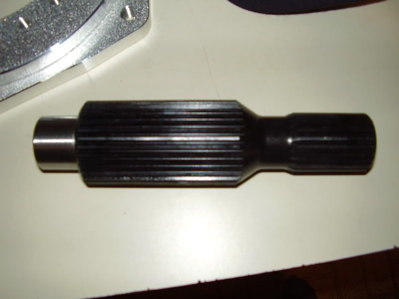

Sector shaft:

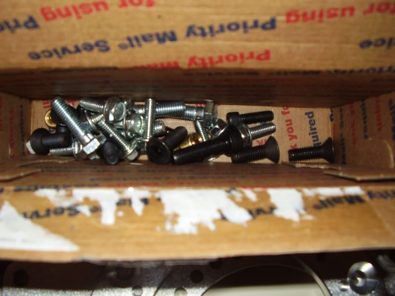

Hardware:
Quality is top notch, super nice.

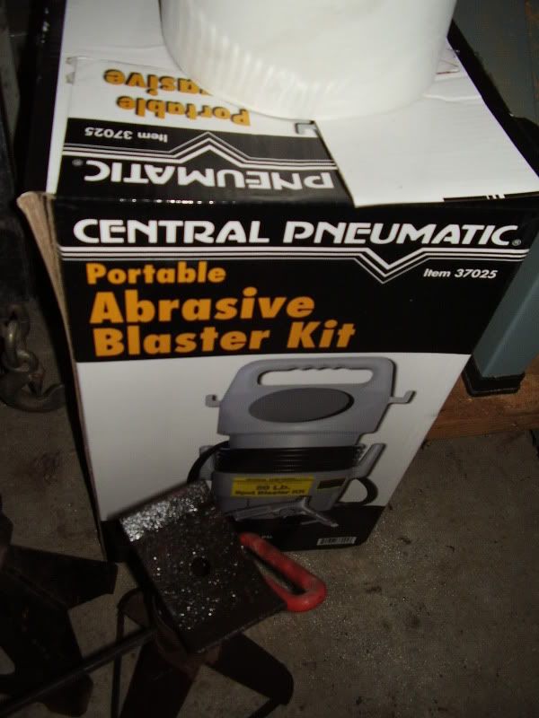

Picked this up for light blasting duties, it gets the job done:

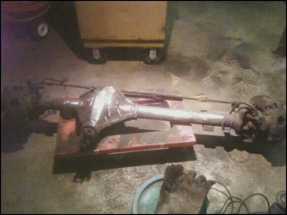

Grinding down the front 44.

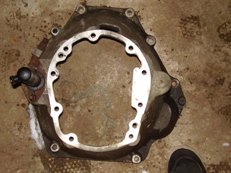

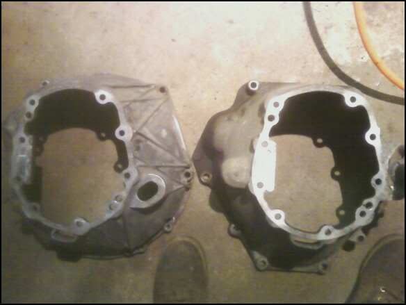

Here you can see the front housing on the AX15 is for a internal slave set up. The new one is for external slave set up.
4.0 to AX15 bellhousing next to the Dakota 2.5 to AX15 bellhousing you can see the pattern is exactly the same.

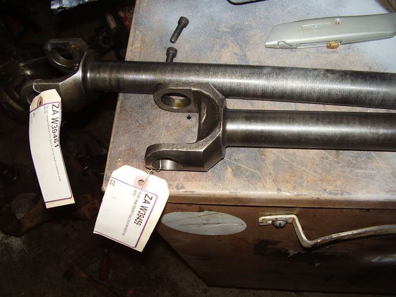

Yukon inner chromo shafts came in:
Ruffstuff crossmember kits came in:
Random D44 brake parts piling up:
Ring and pinion's are on the way (4.88 flavor) for the 44s. Need to pick up some metal to fab the crossmembers. Still need a few brake parts and some clutch parts. Getting there! Lots of sanding and painting, trying to wait untill spring for most of it.

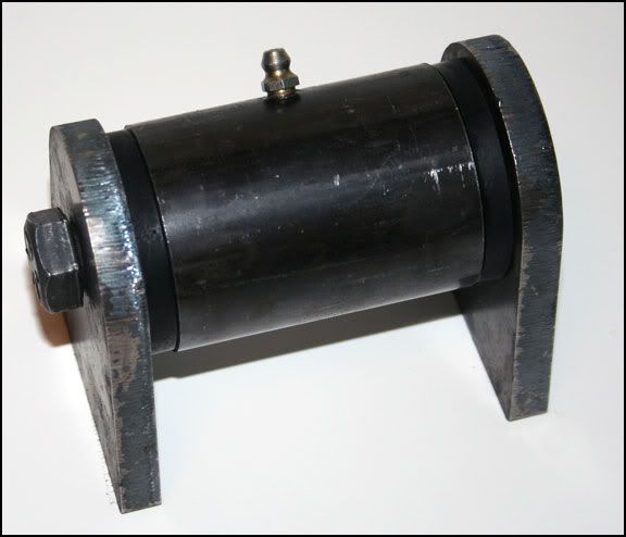

Here is a picture of one side of an assembled ruffstuff bracket:

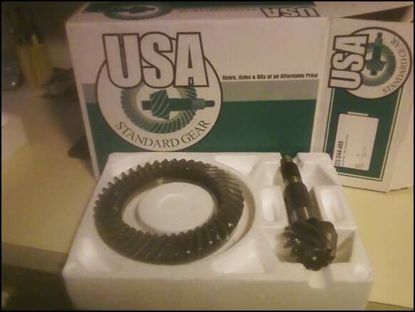

4.88's came in today! (got two sets, only one is pictured)

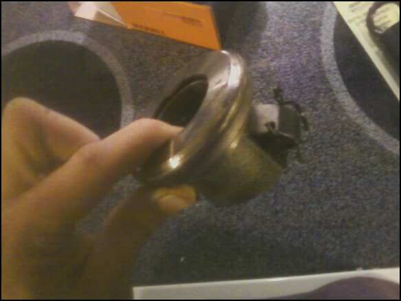

Also got some clutch parts in, new alignment tool and throwout bearing:
