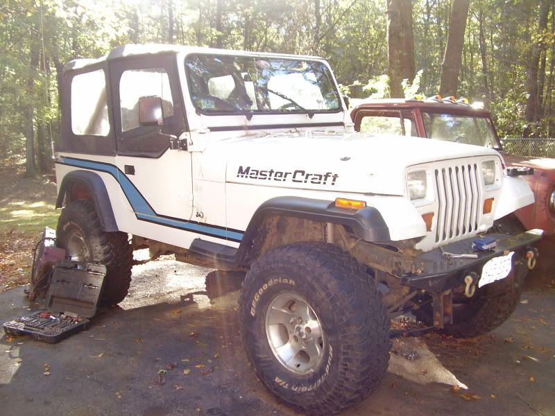

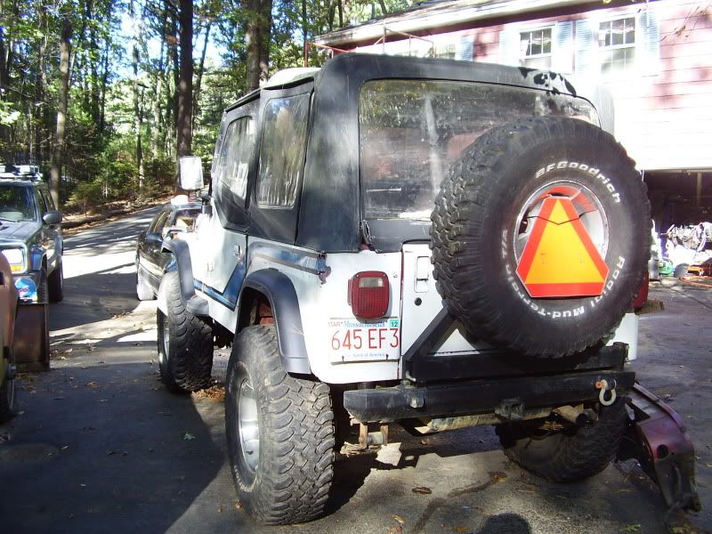

My jeep was used for like 11 years to tow a mastercraft boat by the PO. The jeep was painted to match.
I love you guy's MCE hood stickers. They remind me of the old CJ5 Renegade decals.

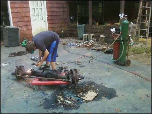

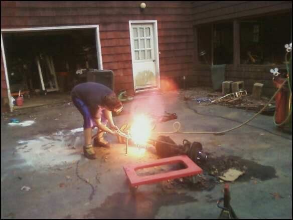

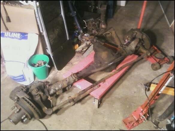

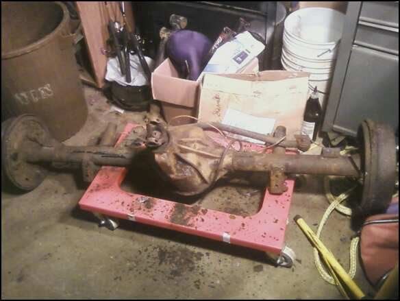

My buddy Seth's jeep. We swapped in a grand cherokee Dana30 because his was bent out of true. We made all new heavy duty lower control arm mounts and beefed up the upper non-diff mount and welded the tubes to the diff while we were at it. Its a custom long arm rear end with a 8.8, the front is clayton arms, it has 5.5" clayton coils and rides on 35" BFG allterain. It rides soooooo smooth.

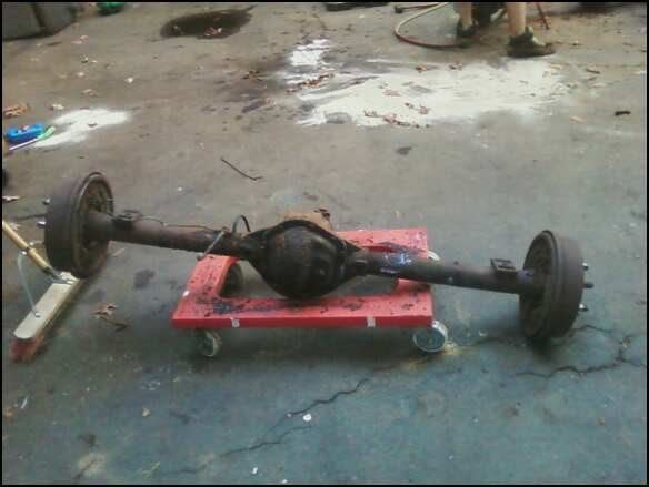

Back to my build. Here are my waggy 44's.
Cutting the useless junk off (tracbar, shock mounts) of them yesterday.
Rear with mounts cut off:
I also opened up the rear afterwards and had a look inside. Looks clean at least.

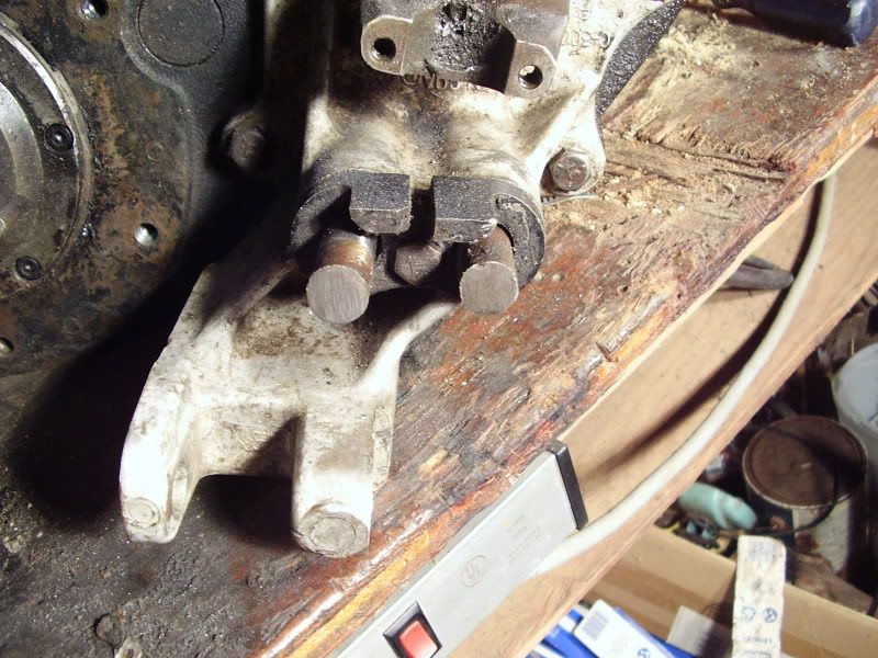

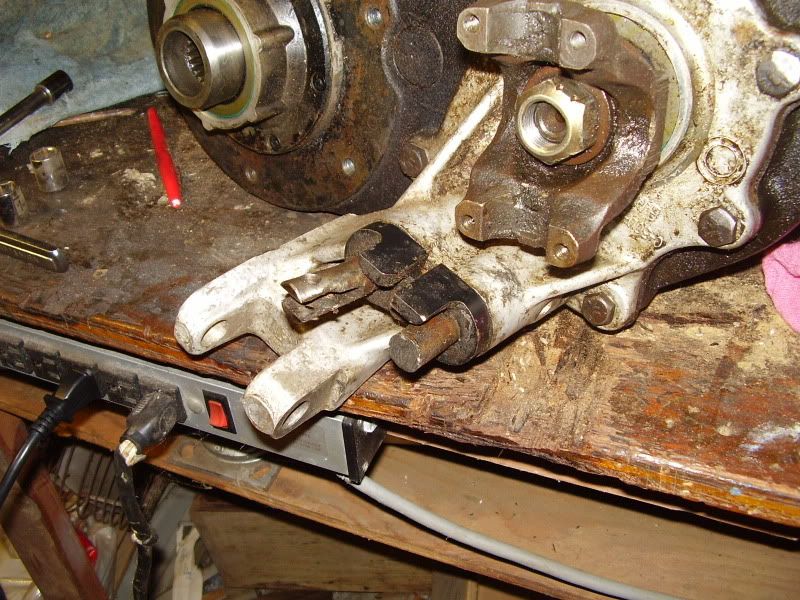

Started working on the 300.
While messing around with it I shifted it into 4Lo. I marked the input shaft and spun the output yoke. To my great surprise the input turned 4 times for the output turning once. My D300 has a 4:1 kit already installed. Needless to say I am pumped.
Anyways, cut the messed up shift rails flat. Should be ordering my male rod ends and tap for them tomarrow. The plan is to drill and tap the center of the shift rails and install a rod end with a jam nut. This should work great for my shifter linkage.

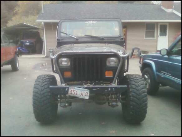

My buddy was home from college and convinced me to get some work done on my heep.
These are problably the last pictures where my Jeep will look like this:
Getting there:

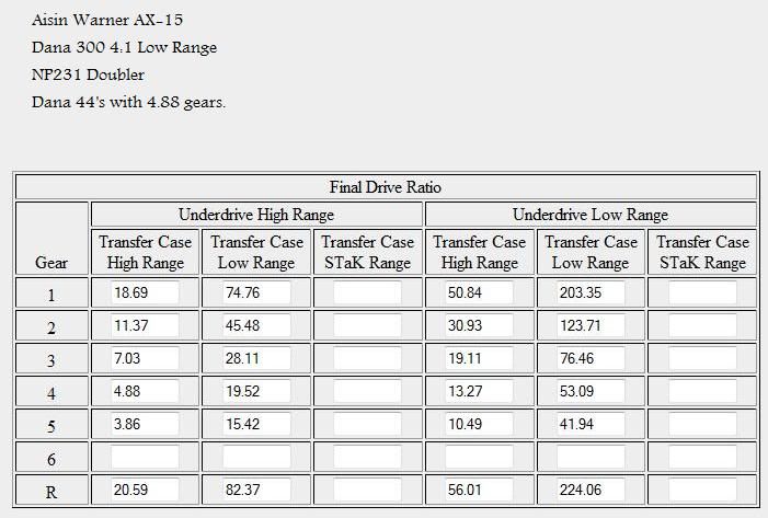

First gear in low low is going to be SICK.

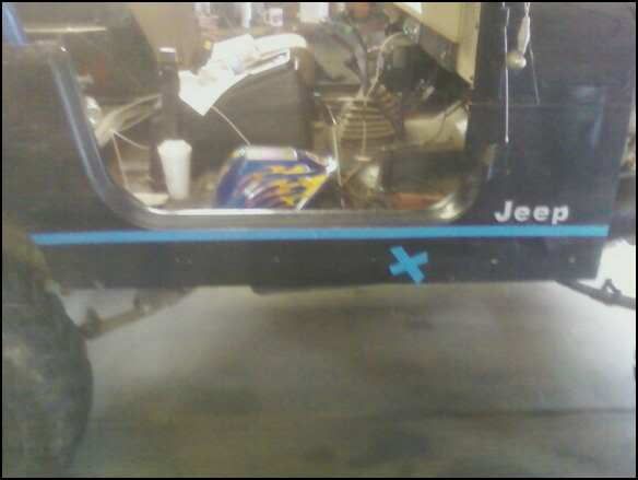

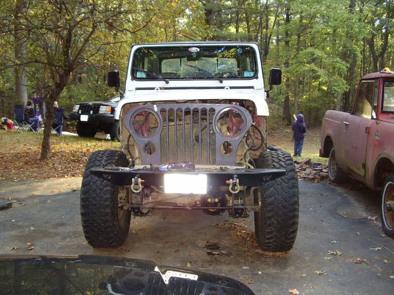

Got the CJ fenders on the Jeep. Need to notch out the grill by the steering box a tiny bit more and then fab up the grill body mount. After that It will be time to dissasemble and do the body work.
Was working on cleaning up the AX15 trans. and my angle grinder bit the dust. I guess the wire wheel was just to much for it.
I'll throw some pictures up tomarrow.

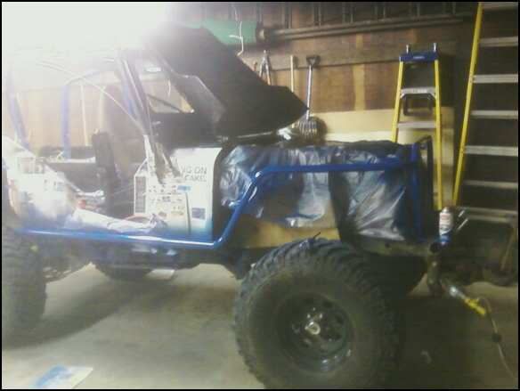

Was helping doing tube work on my buddy Tom's jeep today. Full boatsides. Grill hoop. Highlined hood.
Working on the other side tomarrow and then a stinger and a big hoop to go over the cowel area and tie the boatsides and "fenders" together.
All made of .120 wall DOM tubing. And Its looking VERY cool.
Didnt take too many pictures, we were too buisy. The boat sides are getting plated all the way down to the bottom of the frame. The body mounts will be covered so they will never get hung up on rocks.
This is not the final position of the tube "fender" it will be flat, we were in the process of mocking up the notch to the grill hoop.

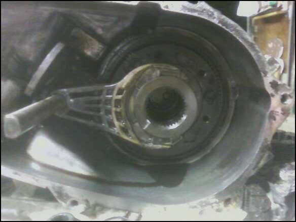

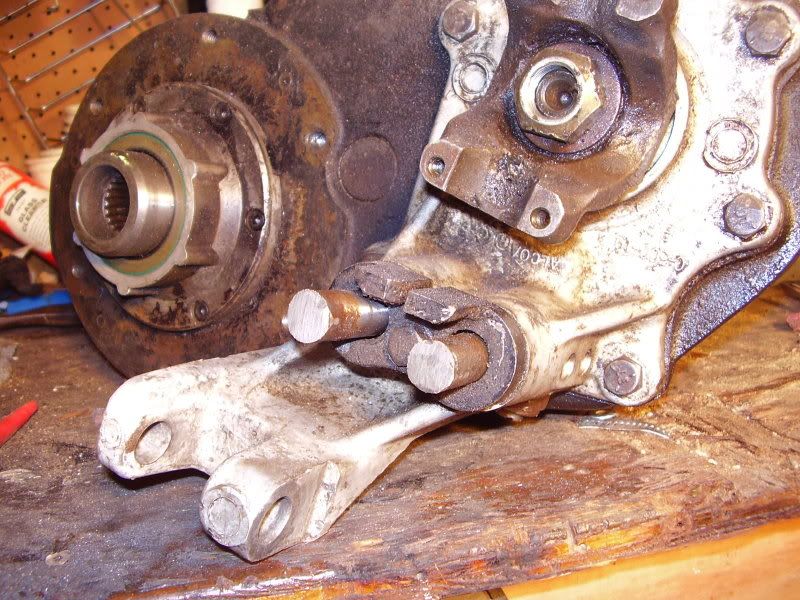

AND now for MY build.....While Tom painted his cage I tore down the NP231 that I am making into a doubler.
This is all that is left and all that I need. The low range planetary gear set. Hopefully sometime within the next week I'll be able to get my plate and clocking ring to my D300 machined and then cut re-spline the shaft that goes between the cases. Im really trying to get this part of my project done so I don't have to worry about it. I'll have the tranny, doubler/crawl box, t-case bolted together and ready to drop in behind my engine.
