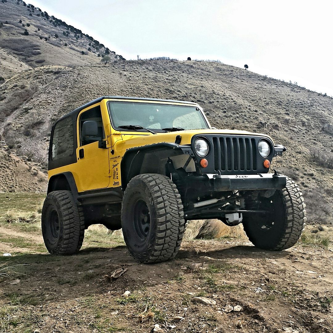

CURRENT PIC OF JEEP (3/14/15)
Here's a list of my plans, it's gonna be built on a budget.. I'm a full time college student working part time, and I also am the kind of person who would rather build something myself for a minimal amount, than pay thousands, even if I can afford it I want this jeep to be able to drive down the freeway at 75 mph, ride comfortably, and hit decently difficult trails.. Still working on all 3 at this point but it's only getting better!
gonna keep it mildly low, around 3.5-4 total of lift between suspension and body. not low enough or built enough to call it lcog. Here are the main points of the build that are done so far:

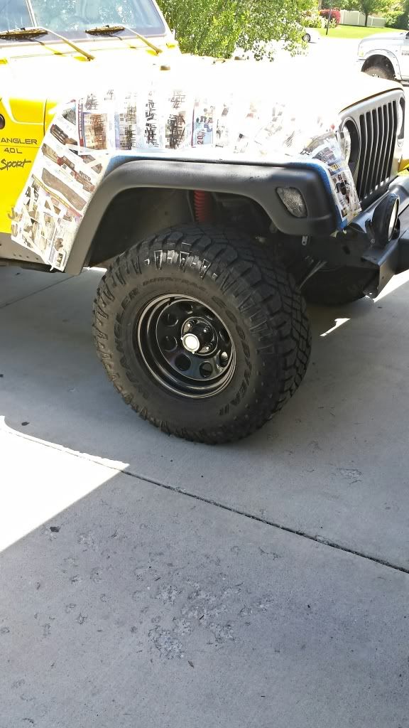

Next thing I did was take a heat gun to my badly faded flares. This is the result!
Also plastidipped the grill, and removed the lame windsheild sticker. Also removed the mini flares in the front, and I will remove the steps soon to add rocker armor I am making. Plastidipped the rockers in the mean time to cover the holes left from the mini flares

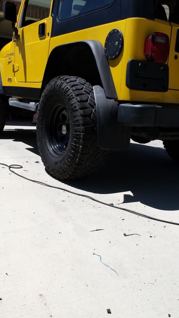

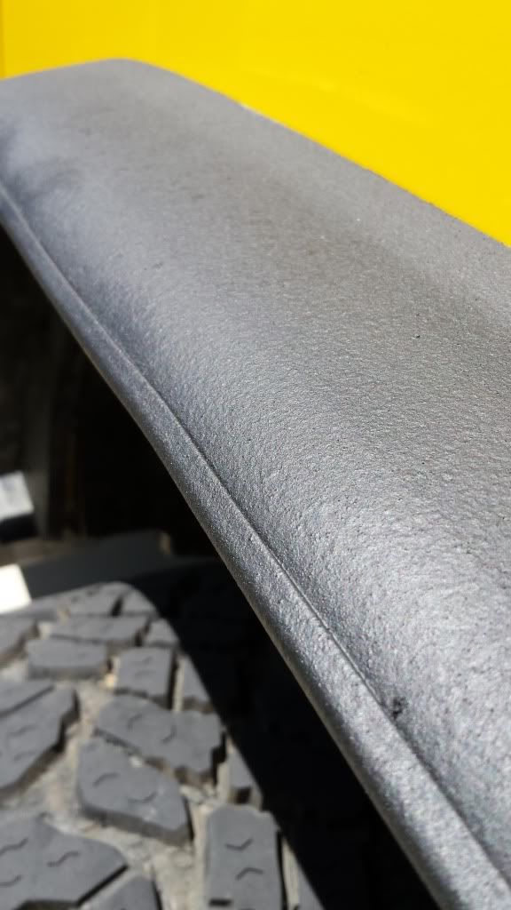

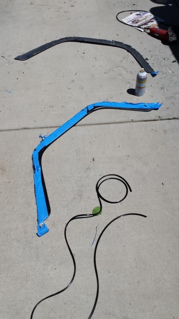

Decided to cut the rear flares
Then I put don't trim on them and bedlined them
Came out pretty good I think!

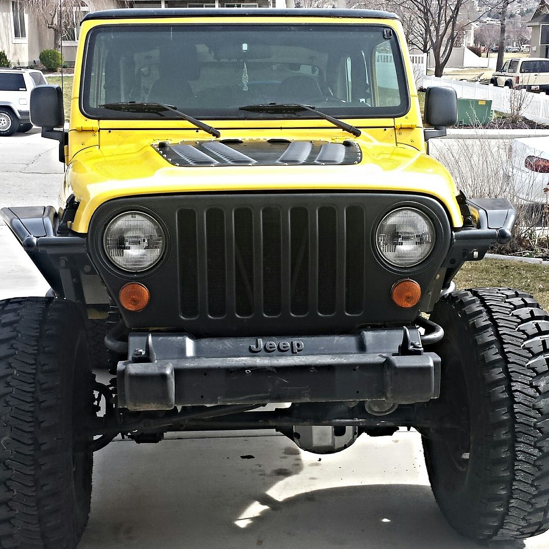

Then I decided to paint the fronts with liner too, gonna chop em when my jk turn signals get here

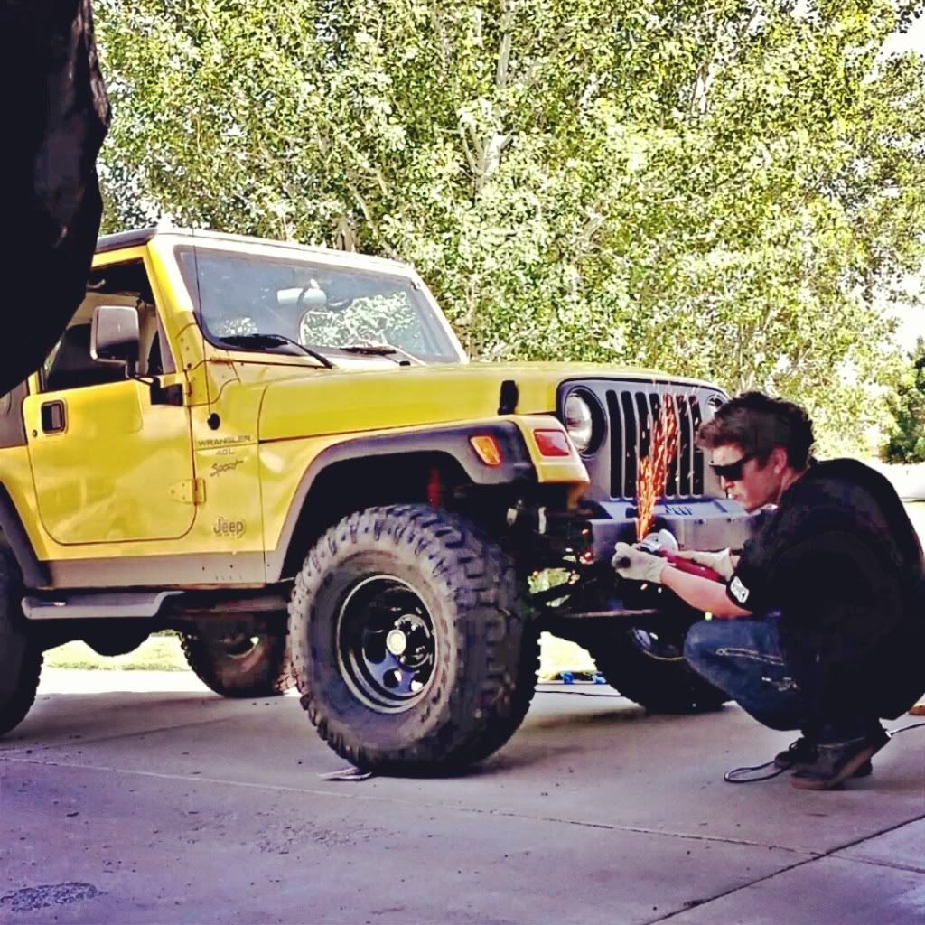

Here the shortbus aka bumble-bee is with some fresh fenders

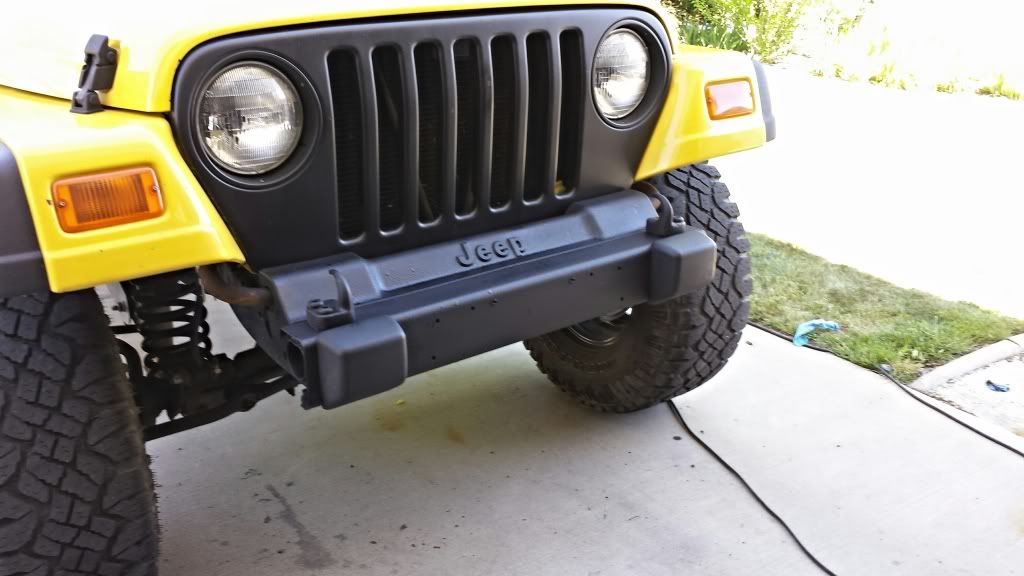

Decided to stubby the front bumper while I was at all this, light didn't work anyways
Fresh coat of bed armor

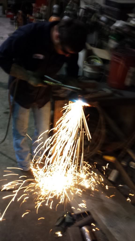

Picked up 5x3 1/4 angle iron today, man it's heavy! But these rockers will be able to take hits now
01 TJ, 32RH, 4.0, 8.8, hpd30, 35's, metalcloaks
07 CBR600RR, full Akra exhaust, PC V, etc.
GODMODEX is offline
post #8 of 298 Old 06-01-2014, 09:34 PM Thread Starter
GODMODEX
Join Date: Oct 2012
Location: Pleasant Grove
Posts: 1,076

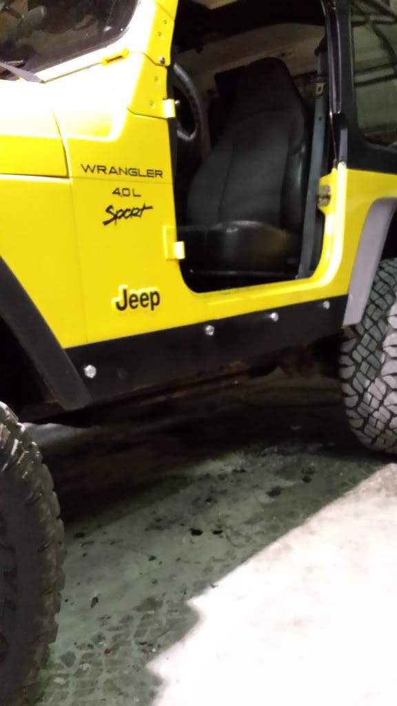

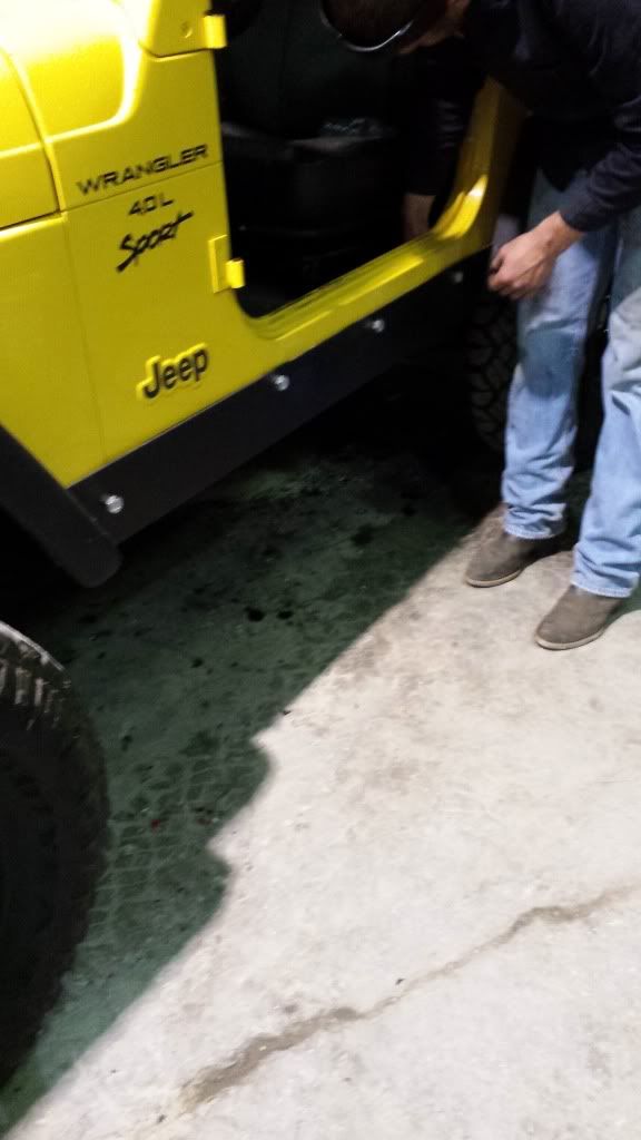

Made those sliders
here's my buddy grinding them
Here's the finished product, gonna get some smaller bolts, but we just used what we had
For $50 not too bad!

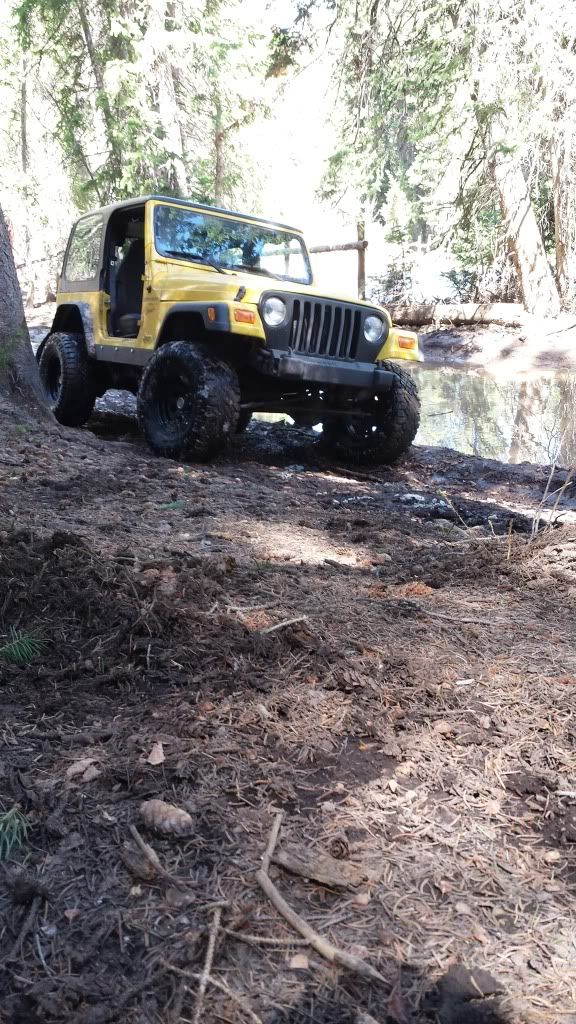

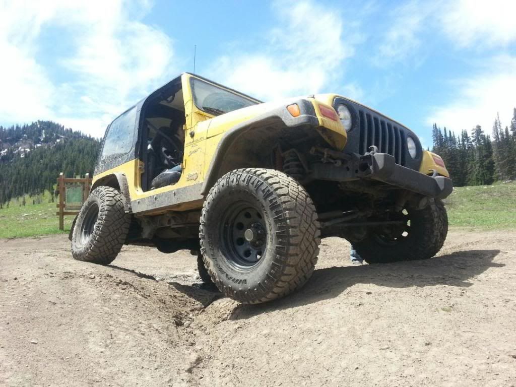

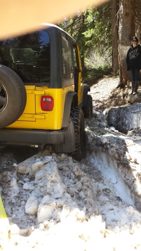

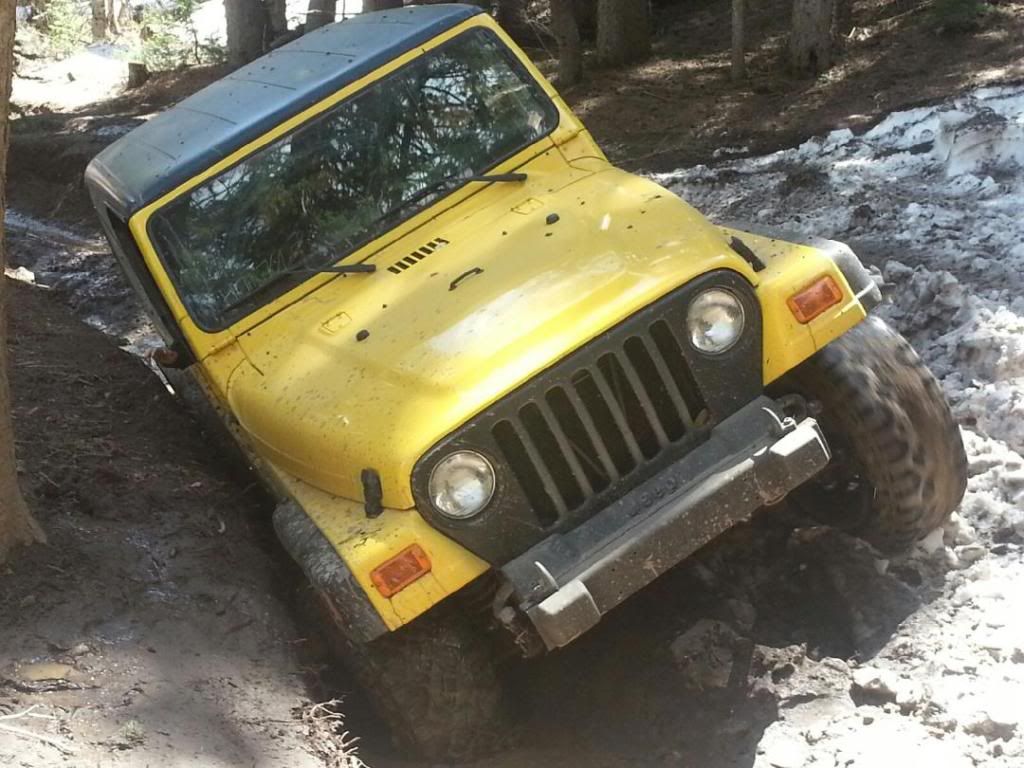

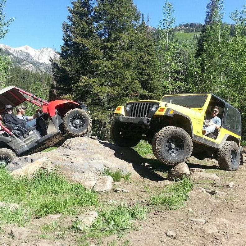

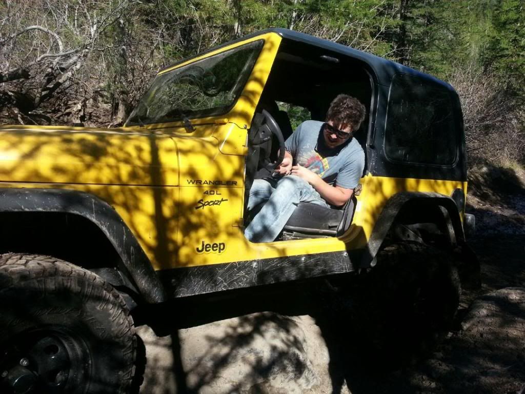

Then I took her wheeling for real!
got a little stuck for a minute.. open diffs suck
This obstacle was pretty fun, leans the Jeep over pretty good! Girlfriend was screaming so that means I was doing something right
I wanted to test out my new rocker guards, but the rocks weren't tall enough

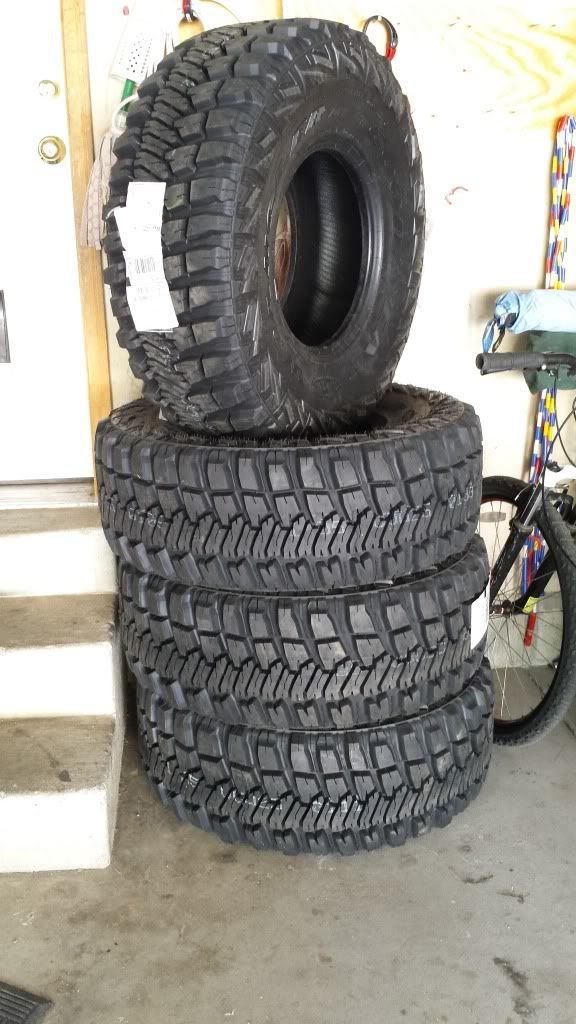

Tires got here
Pile of other parts waiting to go on

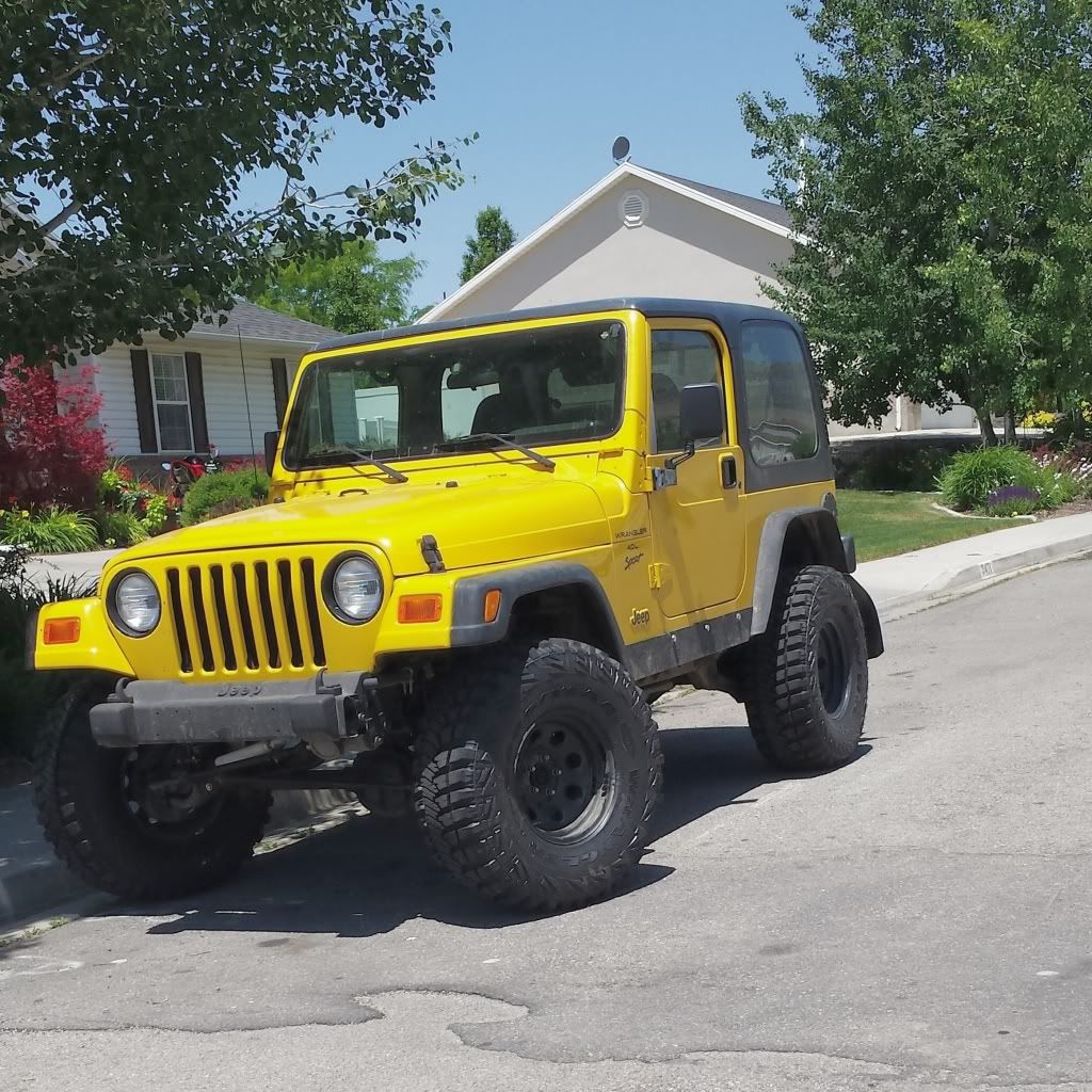

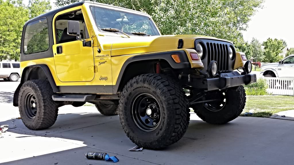

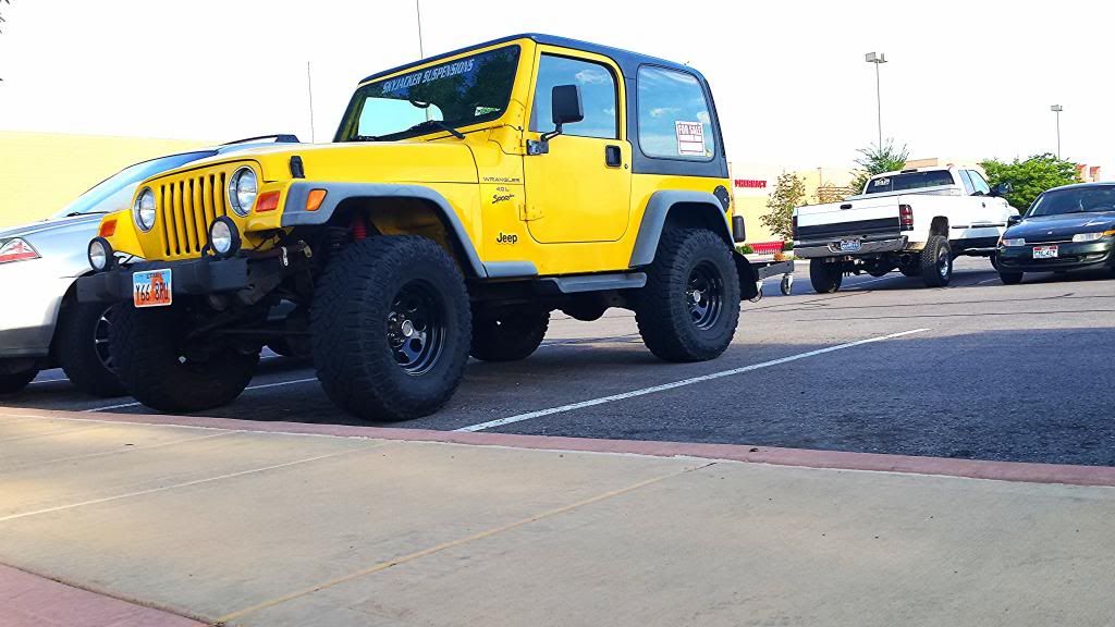

Here's how she sits. Gotta go buy a hole saw then the turn signals and fender cut are happening.
