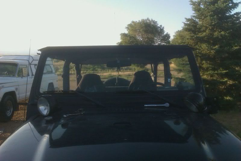

About an hour later I had this. Its a Brooks Custom Concepts light bar/a-pillar armor, I had him add the windsheild light tabs and 6 evenly spaced light tabs on top. (youll notice different lighting I ran out of daylight for pics so theses are actually the next day about 9ish)

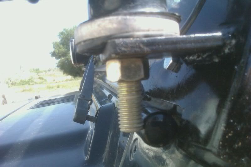

A few small problems but nothing major. First the windsheild mounts where a little too low and a little too far IN/Narrow. They are fine and I am happy with them but you can see here, that they are too low for KC daylighters. The bolts actually touch the hinge just a bit, and there was NO chance of getting the bottom rubber and washer on.

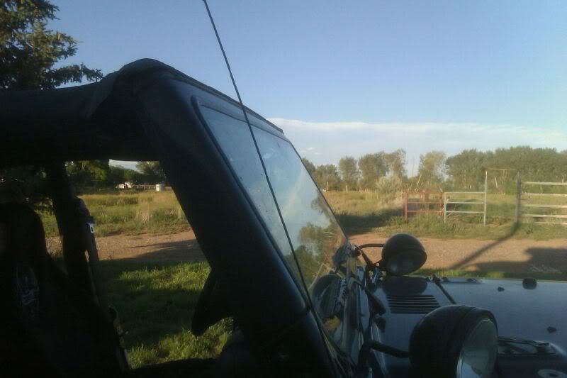

And here you can see what I see out my windsheild. The KC mounts where a bit wider set and I couldn't see as much of the lights. Minor details that I can live with.

I think those light mounts are positioned perfectly! Nice and tight to the body and out of harms way. I've seen and heard of windshield lights being too wide and sticking too far out and coming in contact with objects. In some cases the lights have slammed into the windshield causing serious damage and breaking it. Now. those KC light bolts look way too long, I would remove them and replace with bolts that are 1/2" to 3/4" shorter so no threading is visible after you put the nuts on.
