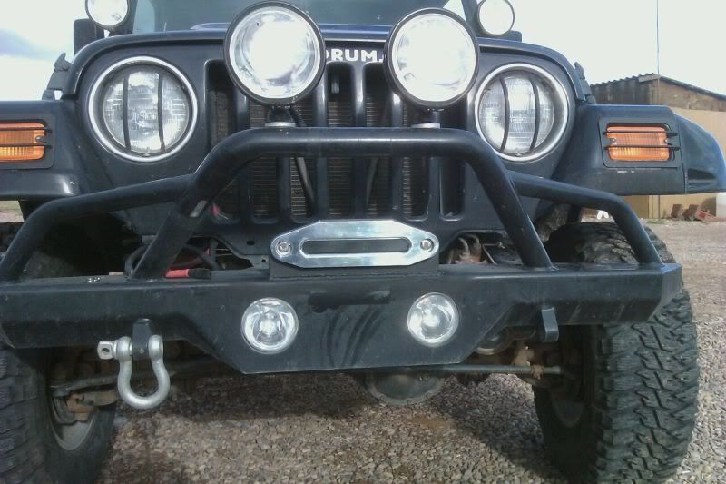

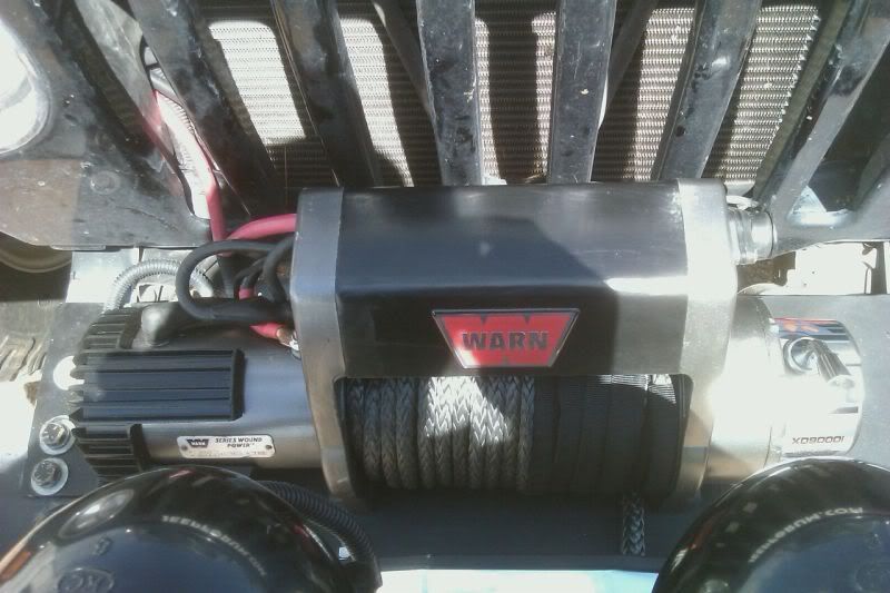

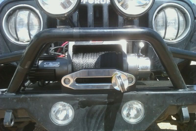

OK one step closer. I got my fairlead mount welded onto the bumper. I have been debating weather or not the 3/16 bumper was enough to mount the winch directly to it. My answer is no so I am going to add a 1/4" plate to the top and tie into the 4 bumper bolt holes and 2 of the swaybar boltholes. I hope to have that done tomorrow but I am not certain that I have enough 1/4" plate.
some pics with the winch just sitting there.

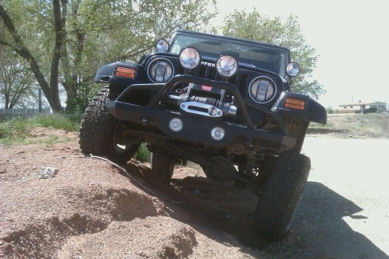

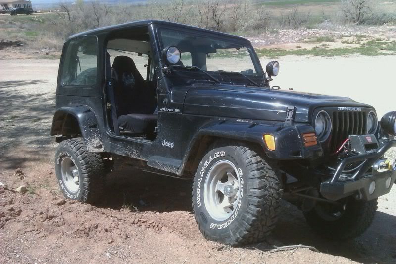

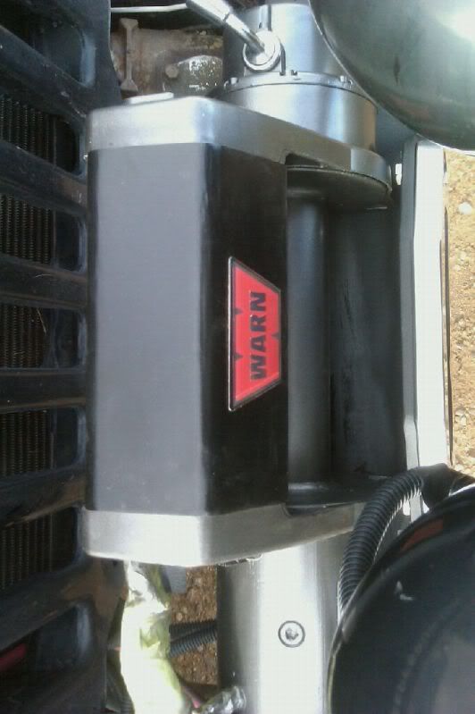

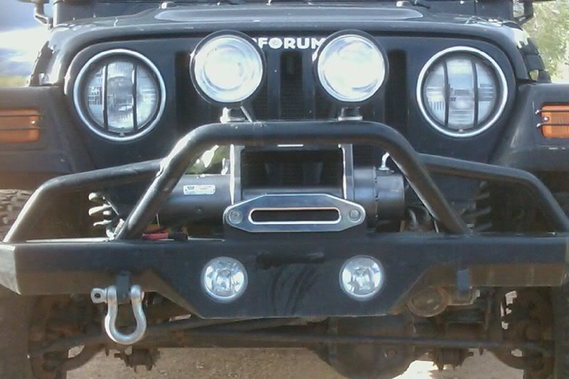

OK so he Warn all finally put back together, mounted, spooled and ready to pull me out of something I shouldn't have been in. Its so smooth and flawless, and WAY faster than my old Ramsey. I'm shickled titless! Overall I spent $651 rebuilding the Warn and adding the viking winchline. I figured just off quick internet priced this winch new would cost over $1800 with the synthetic rope.

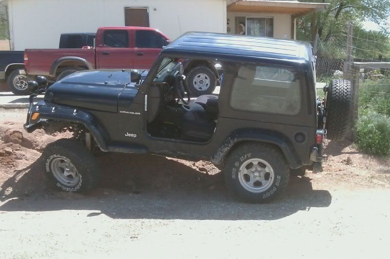

and a few driveway poser flex shots since I was showing my baby bro how it does without the swaybar.

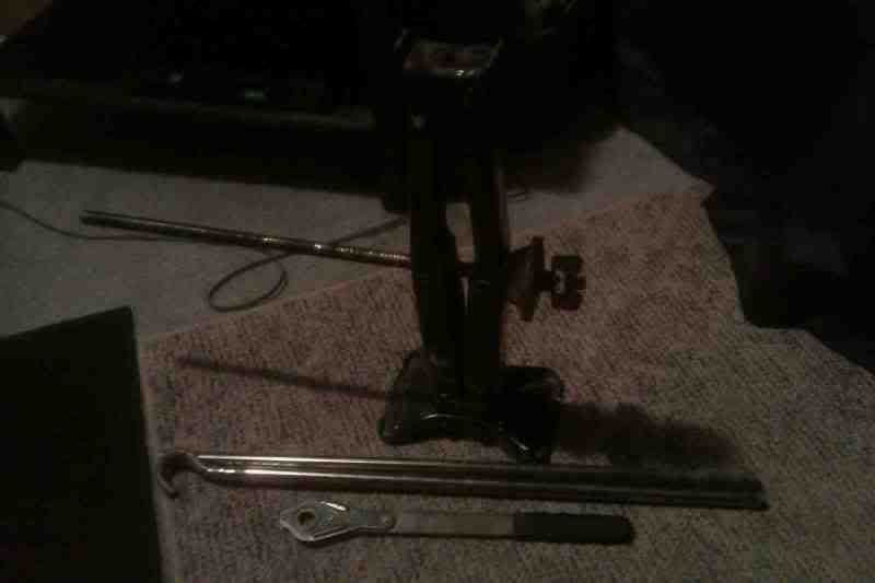

Scored a free jack from a 88-99 GM truck not all that exciting but I personally like this jack.
