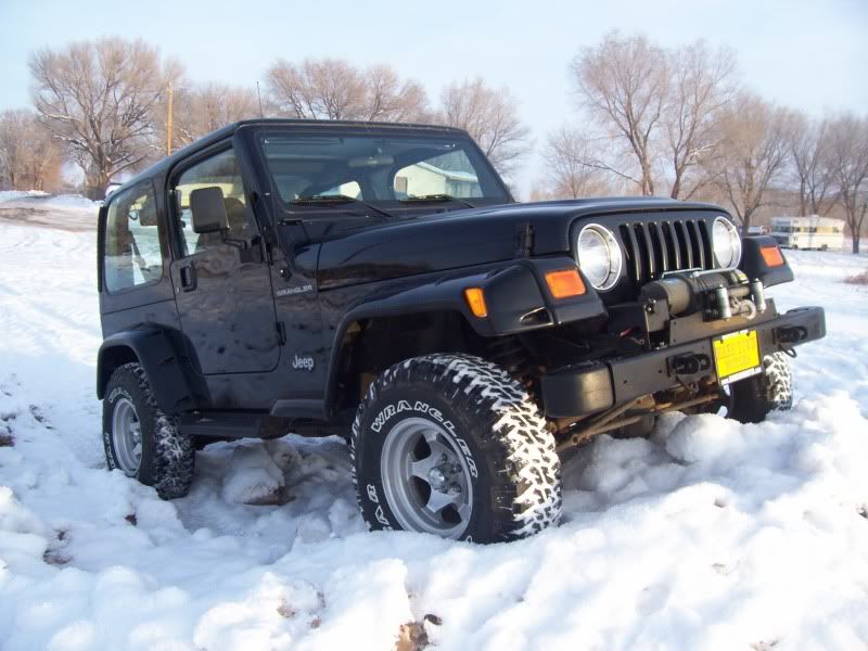

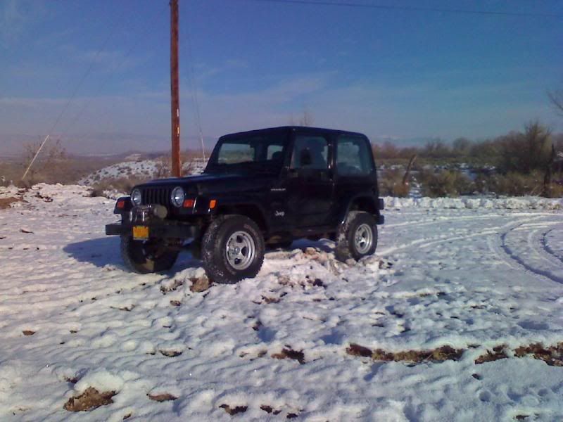

Ok so when I decided to get a wrangler (I have always wanted one) I told myself I was going to get a TJ Rubicon. That is until I started looking at prices. The only Rubicons in my price range had tons of miles and beaten to a pulp. I have also been repairing my credit for a long time.
ANYWAY one day I saw my jeep sitting on a lot here locally so I went and checked it out. 2001 se 2.5 low output, automatic trans. Not really what I wanted But it had under 24,000 miles on it and was like new in every way. AND the price was right. $10,300 Plus he was willing to give me $2500 trade in on my girlfriends crap box 96 ford ranger. He also let me keep the new tires I had just put on the ranger. I went to the bank and they approved my loan, a huge surprise to me.
It has a hard top small lift Ramsey 8k winch and nice alum wheels with matching spare.
Cute aint it?
So far I haven't done anything to it but drive it and wheel it a few times.

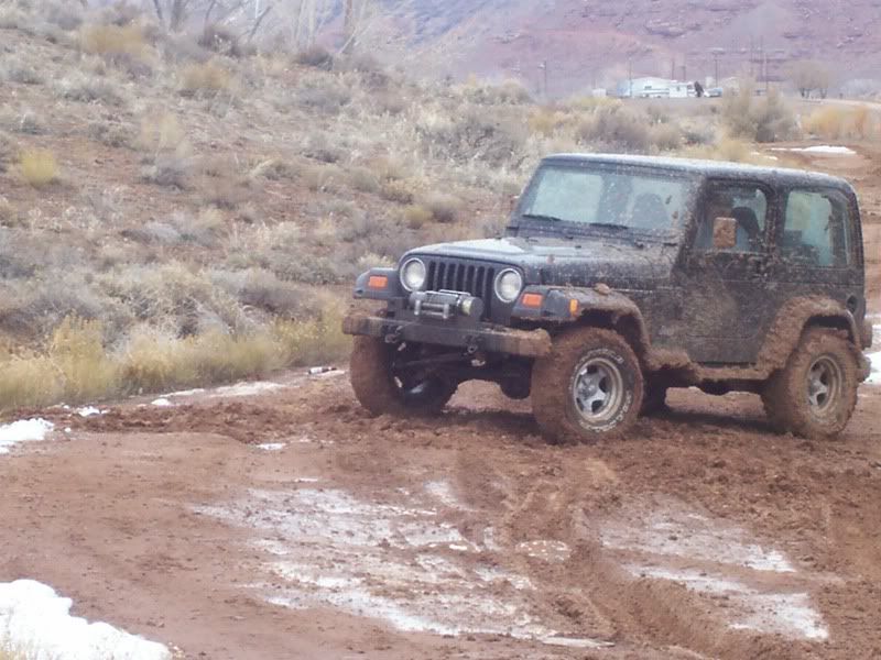

No build progress but I went and played today!
Got some pics of the mud early in the day but the later part the area was in a wetter area so less pics.

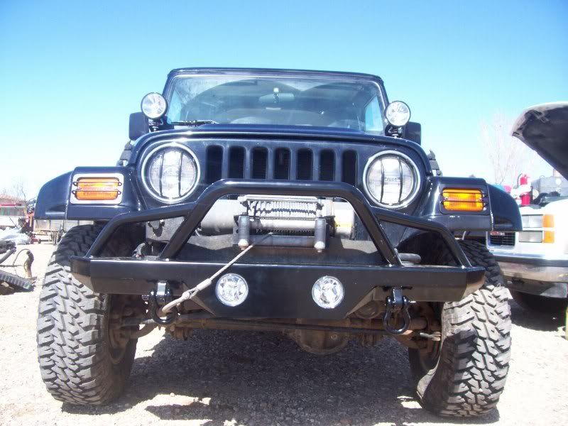

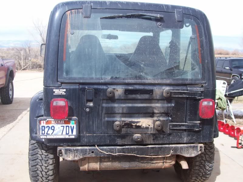

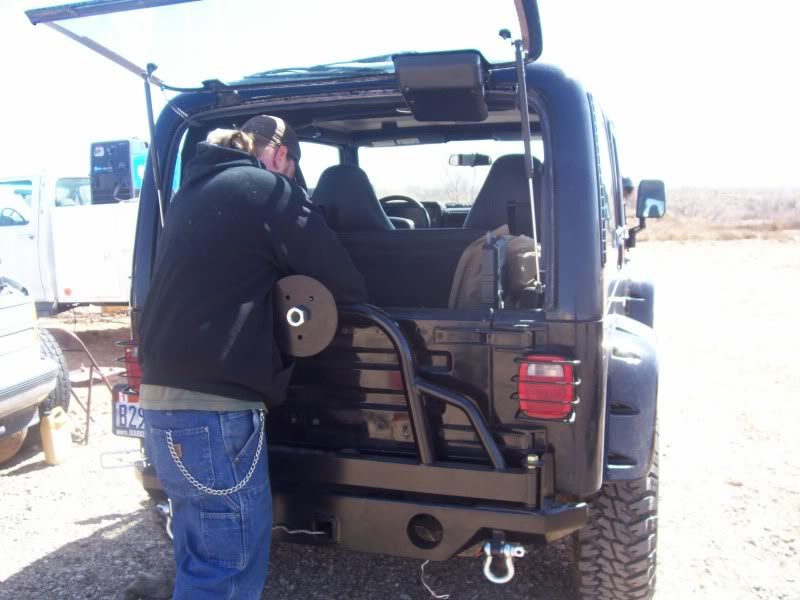

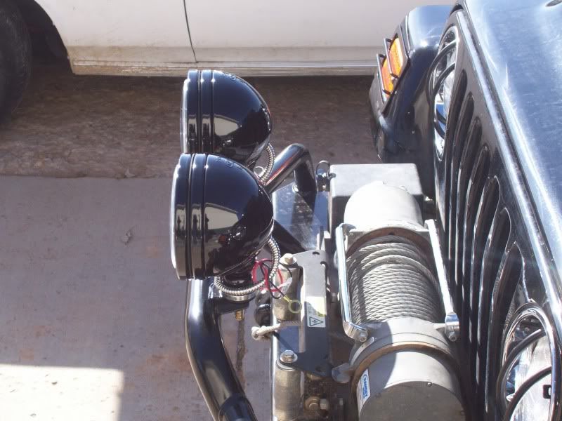

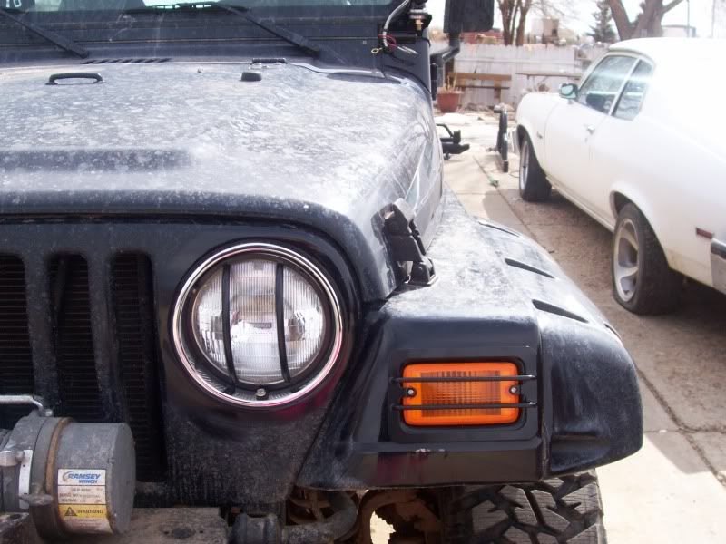

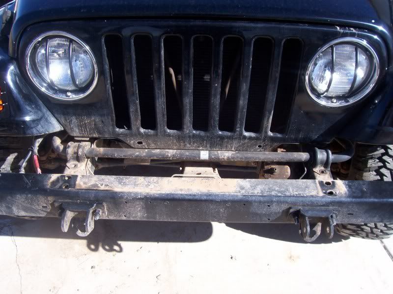

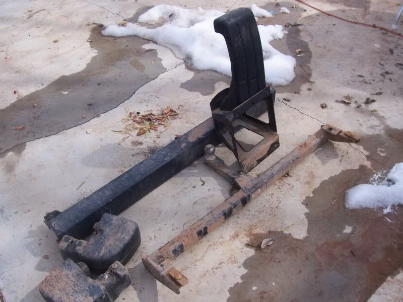

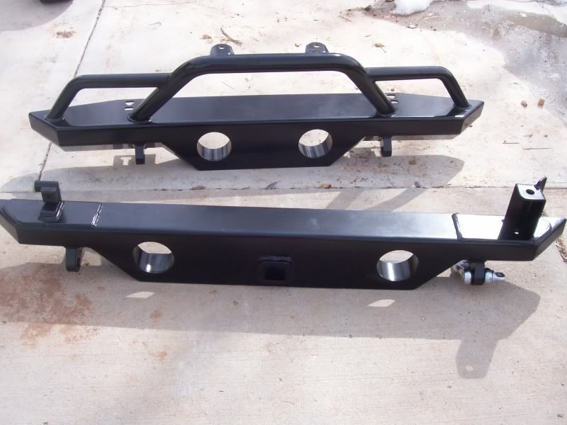

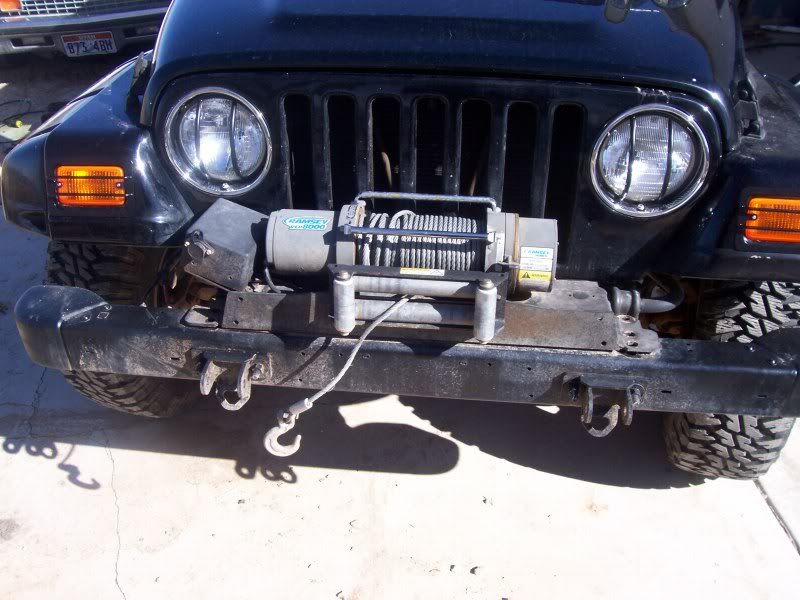

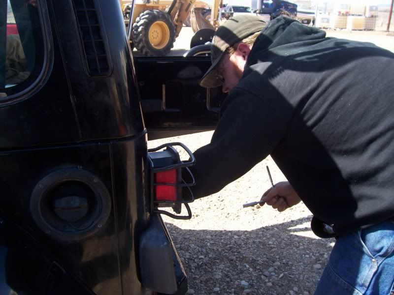

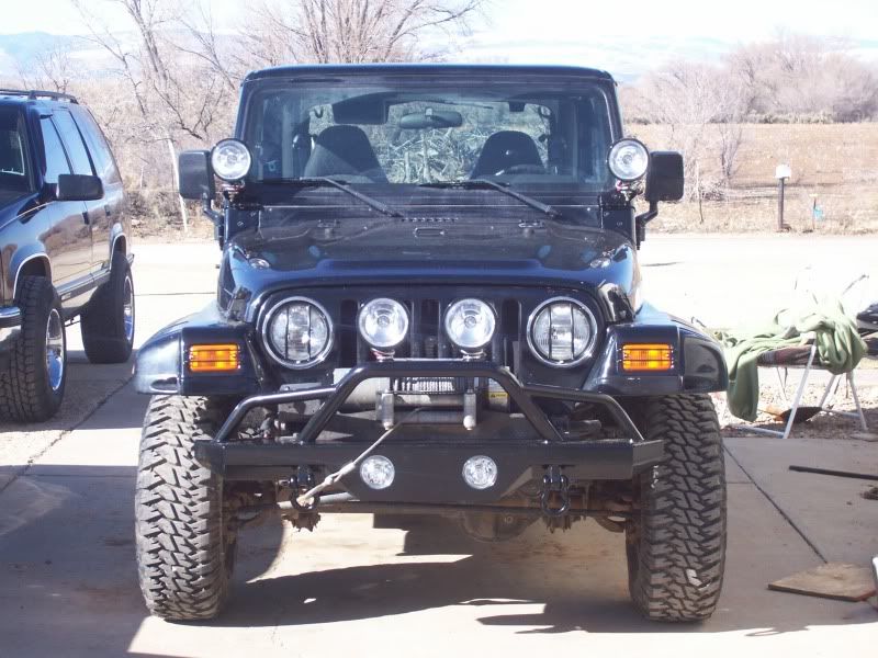

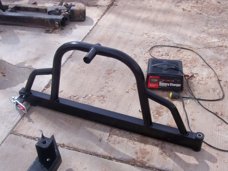

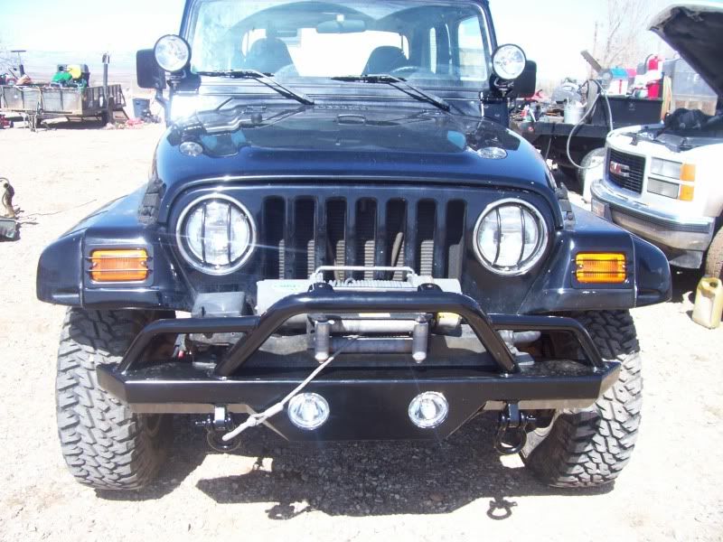

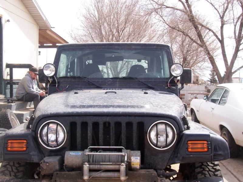

Ok stuff came inso I started the install.
Jeep was muddy from wheelin the other day so I just sprayed the big stuff off. that way I could wash it better with stuff removed. Then bolt the new stuff on.
Ill let the pics say it.
Butt naked
junk ill try to sell or trade off
NEW
mounted for a minute I have to pull it back off and drill some more holes.
tail light guards going on
coming off
back together
You'll notice light guards and window mount are on now too.
balzer is offline

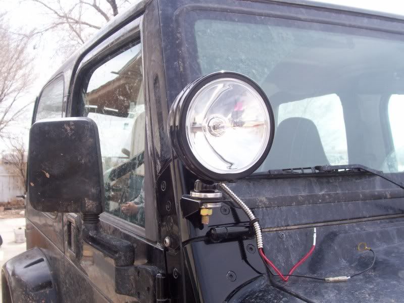

I just ran and got another set of KC's to finish it off. Now I have 8 sets of lights to wire up I am seriously considering saving a few dimes for the s-pod, it would simplify the light wiring and give a nice switch panel.
I would also like to wire up the rear driving lights (in the bumper) to come on when I put it in reverse as well as with a switch.
I assume running the tail light power wire to the same post on the relay as the switch goes to? Or would that turn on the stock backup lights and run too much power through the switch? Any help would be appreciated.

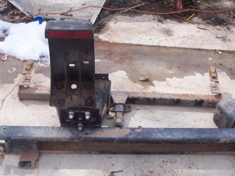

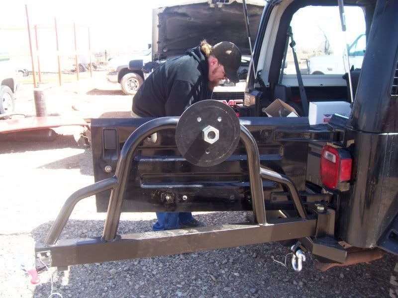

I did run into some problems.
1) The rear bumper and tire swing arm are a bit out of wack. I need to grind the top hole in the bumper a bit so the tire carrier will latch properly.
2) who the HELL has wrenches as big as the tire mount bolt and nuts? Its like 1 1/2" or more I ended up using a big cresent to snug it up and will most likely tack weld it solid.
3) the bolts they sent for the wheel studs are too long. The lug nuts bottom out before the wheel is tight. I will stop by big o tires and try to get some real studs to press in.
4) the bottom bolts holding the front bumper on where torx heads and I didnt have a large enough tool for the job so I welded a hex head bolt to them and used a wrench. Still got to get some bolts in the bottom.
Overall it was pretty easy and went smooth. The windshield hinge bolts came right out after I scored the edge with my pocket knife.
5) OH YEA I had to clearance the front bumper lower bracket on the drivers side due to it hitting the steering box.

Looking good there man. When I wired up my KC reverse lights I just tapped into the stock setup on the passenger side. However I do not have them on a switch, just set to come on when I go into reverse. Works fine for me. Keep up the build

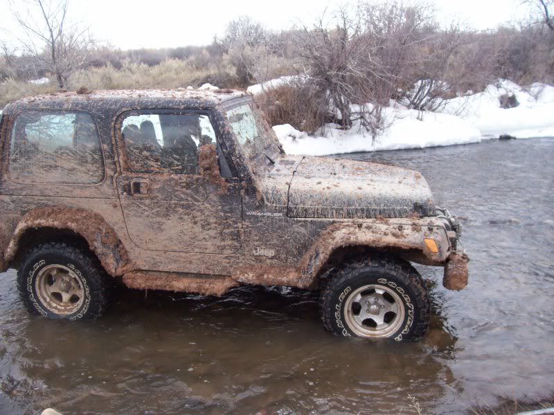

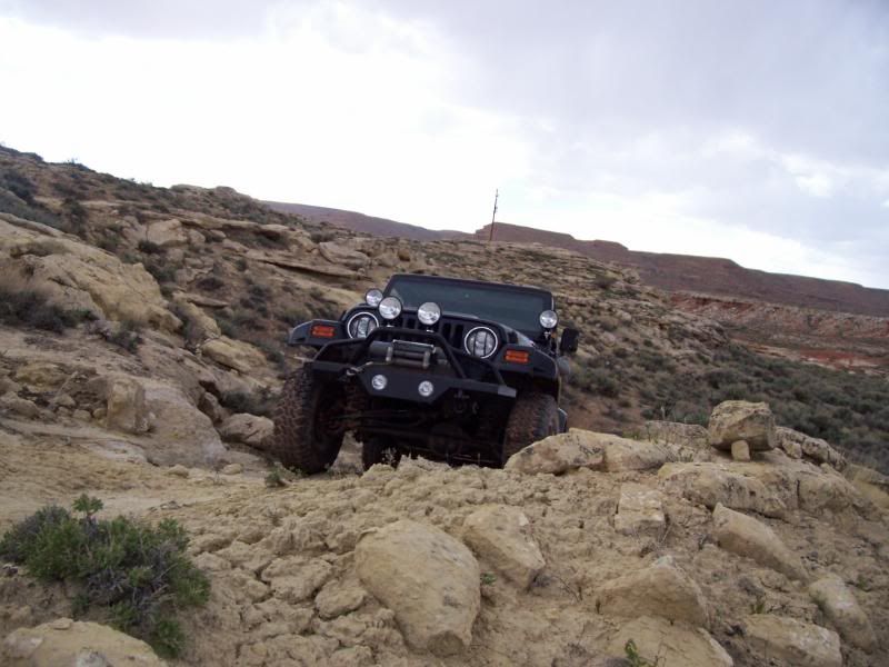

post #11 of 115 Old 05-19-2010, 04:02 AM Thread Starter
balzer
Location: roosevelt utah
Posts: 715

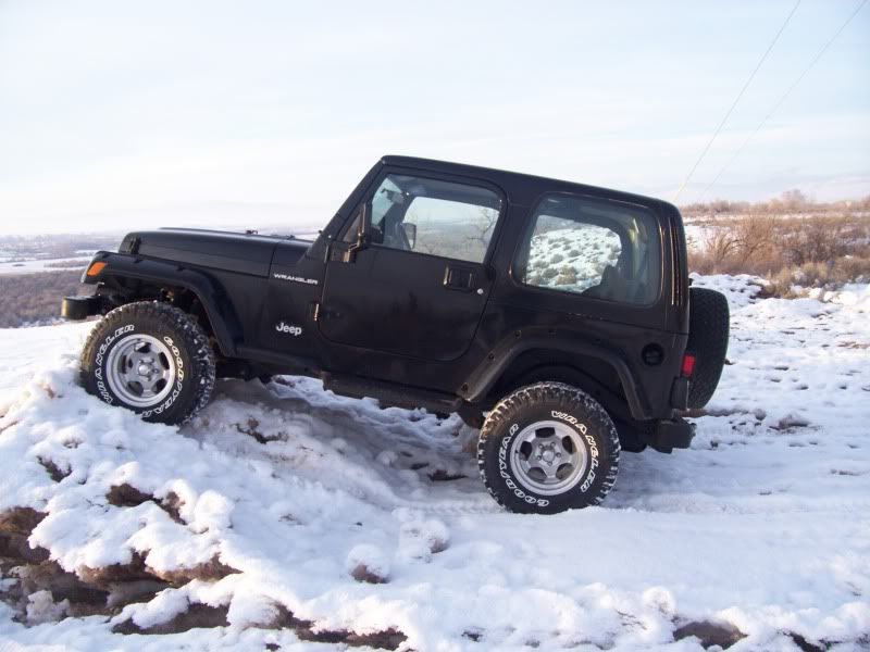

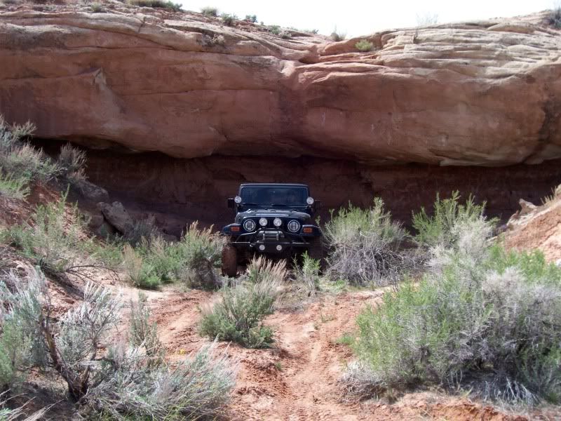

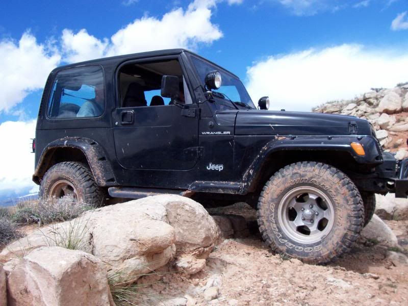

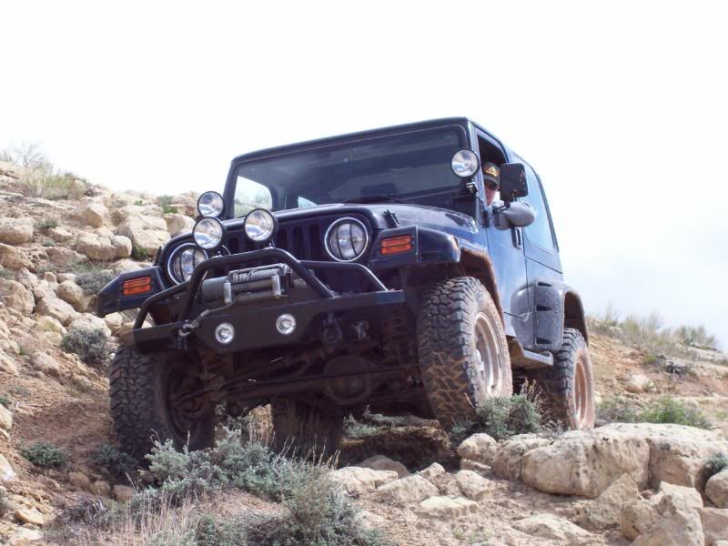

I really haven't done much as far as a build goes I still havent even wired up the lights.
Its just too damn much fun to go wheeling in it, I always choose wheelin over wrenchin.
But I do have more pics.

Not too extreme but a lot of fun. ALSO in some of the pics it doesn't look like I am on a trail but I assure you there is an old and somewhat overgrown trail. Mostly pole line road from the power lines. I must be the first to travel these roads in quite some time and at points it gets hard to tell where the trail is. At other times you can tell a dozer has cut through to make the road and its nearly as good as any forest dirt road. Much of it follows the wash and gets a bit technical to avoid body damage.

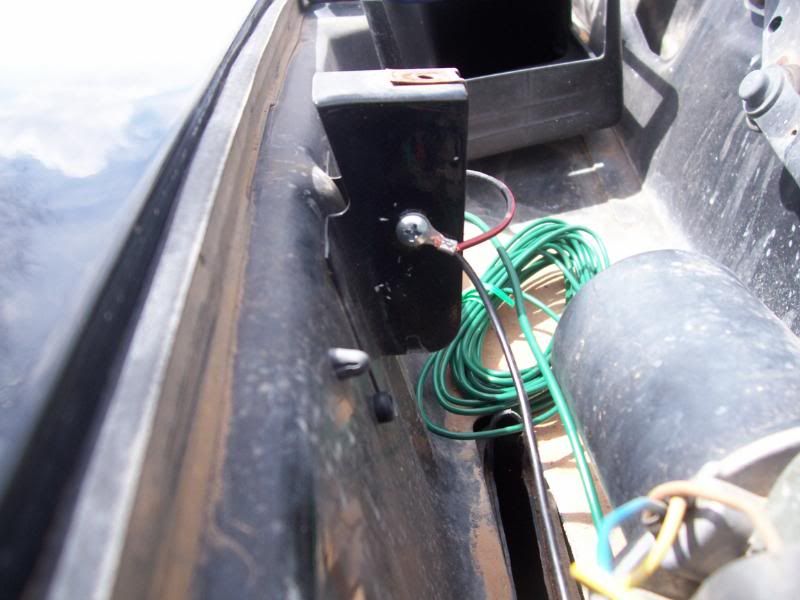

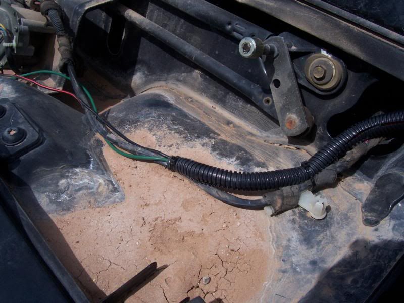

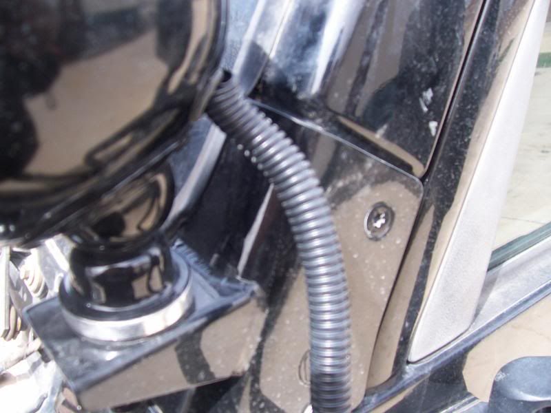

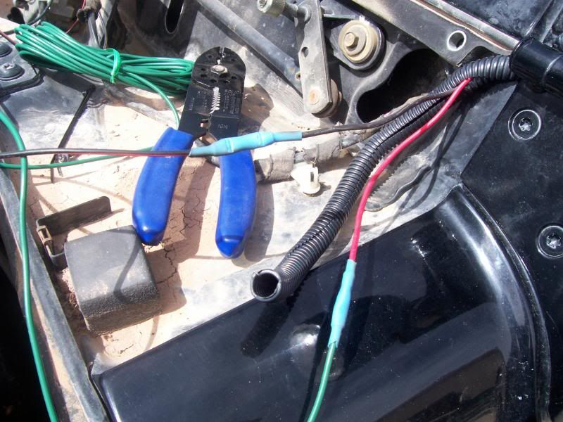

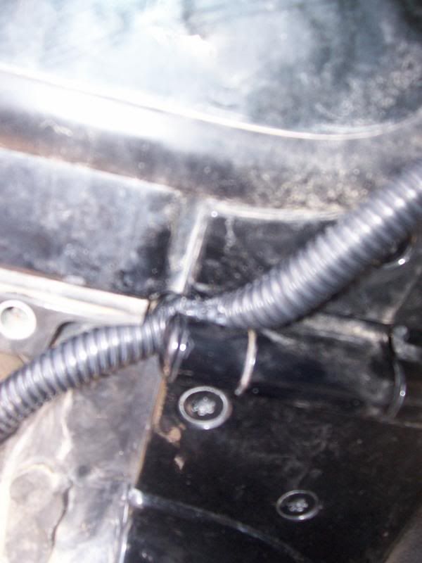

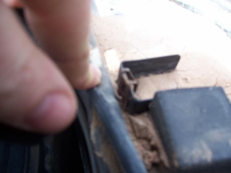

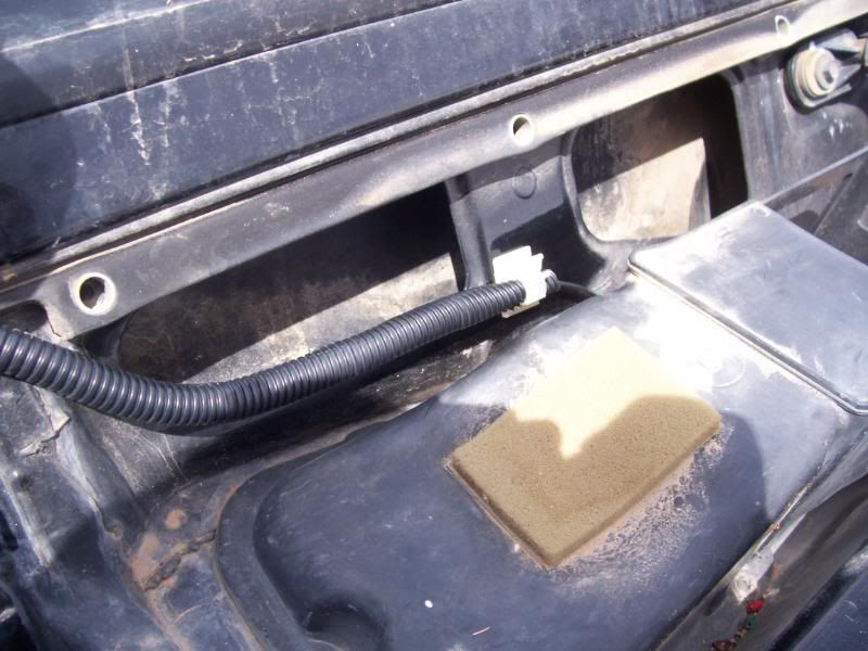

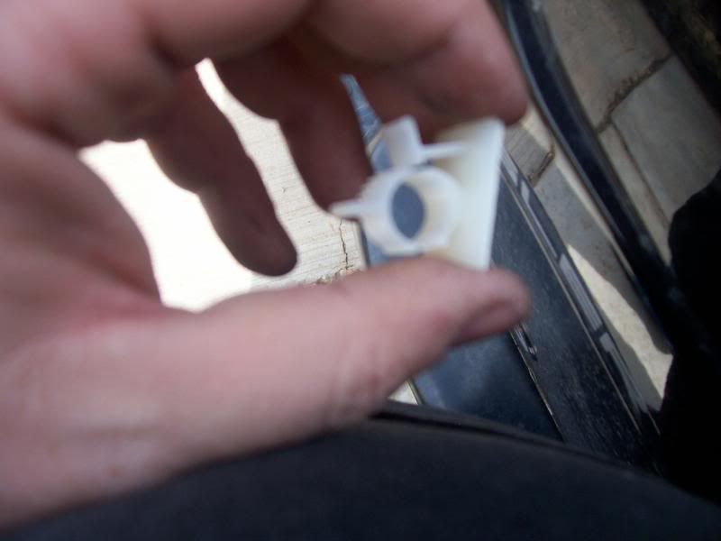

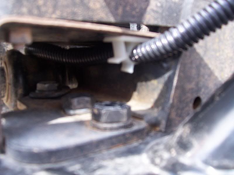

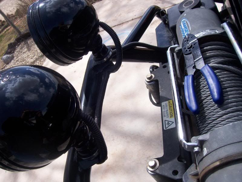

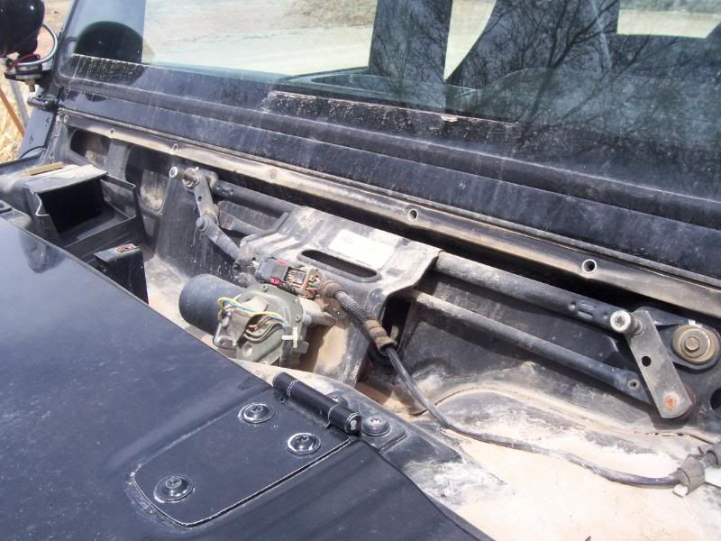

OH I did start the wiring for the lights but I really don't want holes in my dash or anything so I only got about half done until I figure out a solution for switches.

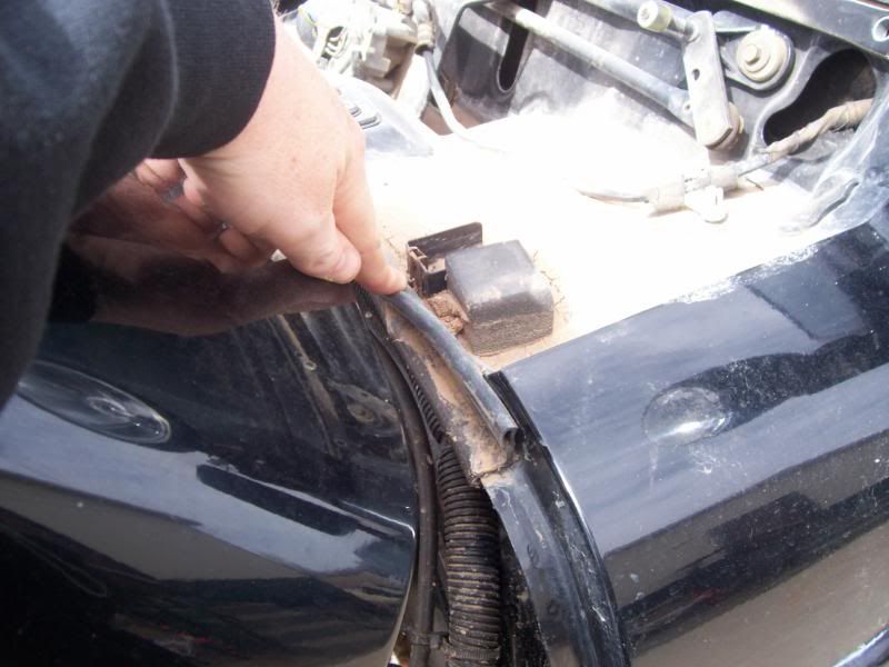

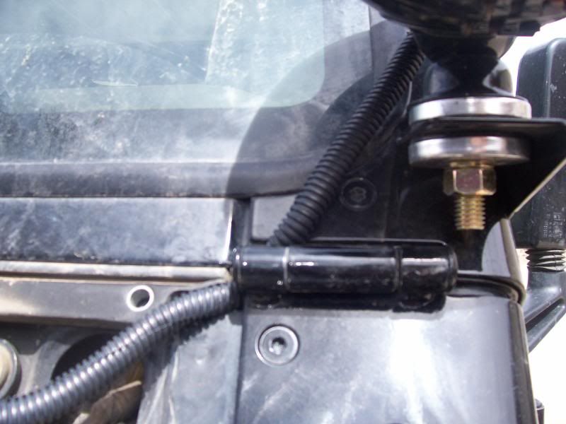

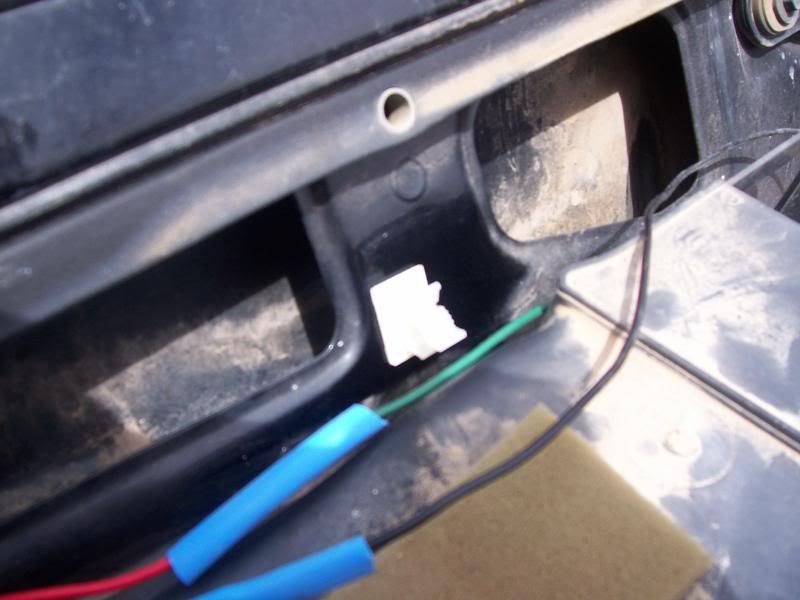

I started by removing the cowl.
Here I am pointing out the screw locations under the hood gasket
The less chrome the better... crap
plastic black loom... much gooder
route it behind the hing for a clean look
making connections
secure the wire
ground to body
repeat on pass side
front and more black loom
ran and secured under winch plate
Im still thinking I will go with the s-pod and the source for the rest of it but I gotta save some dimes and nicks and paydays have been a little small recently.
Thanks for looking more to come.
