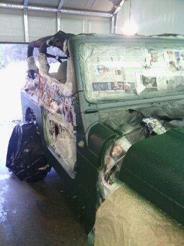

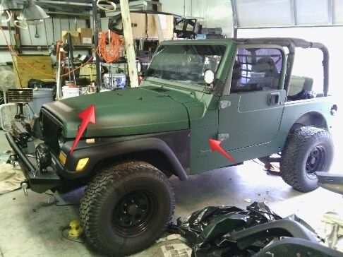

Sprayed on MONSTALINER exterior
My paint is almost 15 years old and although the body is in fairly good shape with no rust I decided I wanted to do something different. Have used monstaliner on the fenders and in the tub a couple years ago and have been a big fan ever since so I decided to do the entire exterior.
Order2 the 1 gallon tintable kit in Jungle green. And two x 1 qt black kits.
The prep work was slow going as I only have my two days off a week to get anything done.... but prep is the most important part.
After sanding the tid bits by hand that I couldn't get to with the power sander I wiped everything down with MEK and let it dry.Then, of course taped and masked everything off I didn't want painted.
I mixed all the contents into an extra 2 gallon bucket according to directions. I also added and mixed about 4 oz. of MEK to thin it out a little.
When I ordered my kit I also ordered a shutz gun and rented an air compressor from home depot. Set my output to about 80 psi and started spraying.
Did 3 coats total with about an hour of set time between coats. Let it set about 2 hours and pulled the tape and newspaper off...
There's no "stripe" it's just the lighting.
The door hinges and fenders are going to be repainted black in a couple weeks utilizing the black kit I got. As you can see the color and texture turned out awesomeB]
Also went ahead and painted the billet gas cap cover. Got it from Extreme Terrain and hated the shiny, glossy finish so I did my own using rustoleum truck bed liner spray can.
3 coats for that matte textured look!
My next update Ill be putting everything back together and trying to figure out what to do about refinishing the tan hard top. Havent decided if I want to go with the Monstaliner on the hard top or not yet.

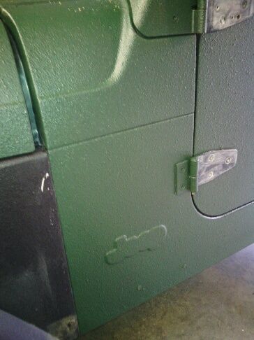

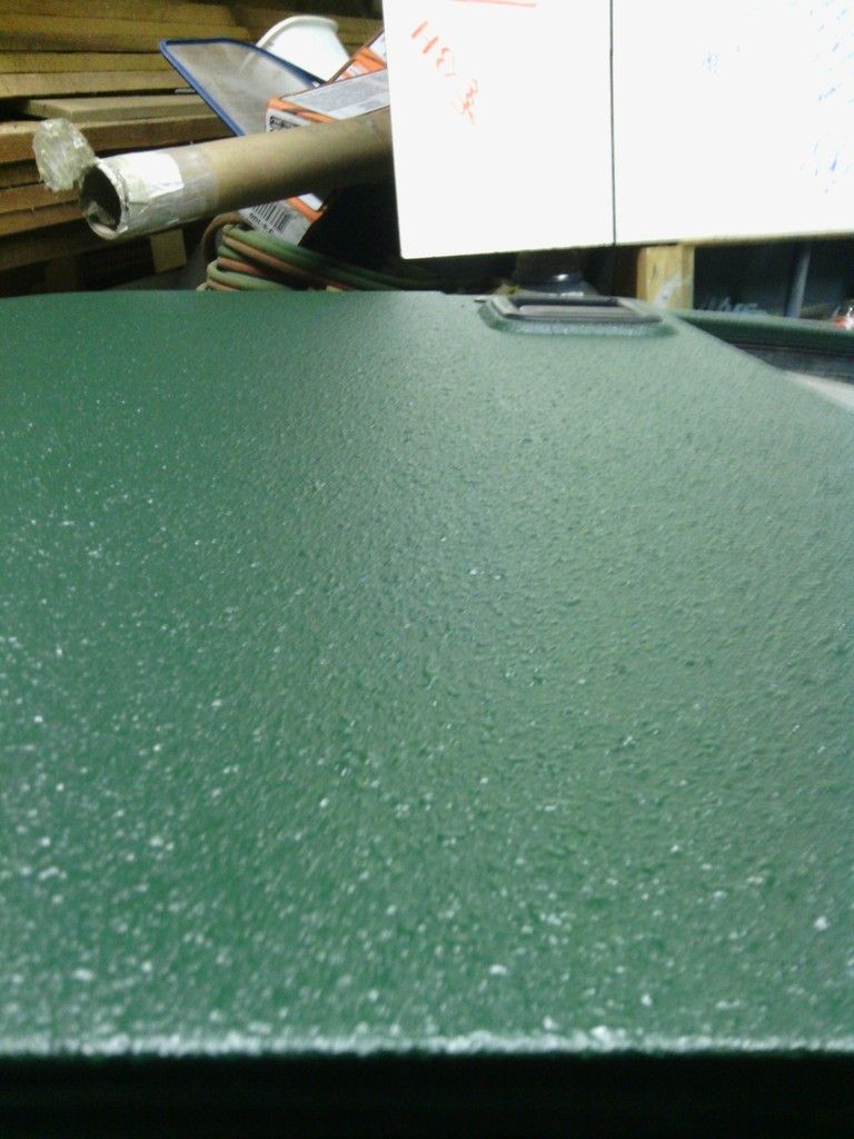

Some extra pics

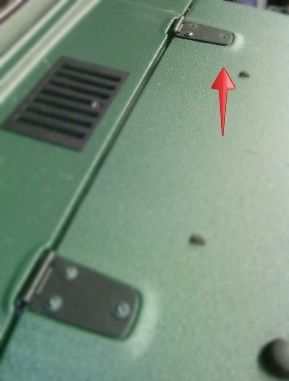

Have a few extra pics that show the Monstaliner texture a little better. Some of the pics it looks a little chunky but I assure you its much smoother than what the lighting makes it look like in the pics.
And heres the black hood vent cover Ill be spraying with rusto bed liner

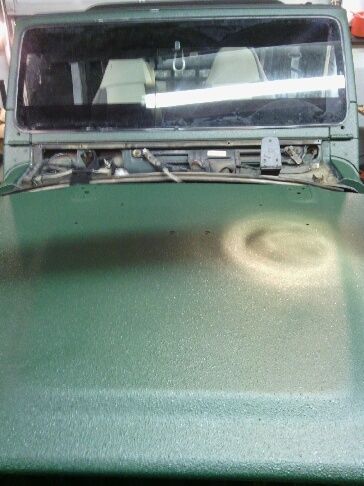

I went back today and looked at the end results of the green Monsta. At first I thought it may be a little thick and had approximately 1/4 of a gallon left over after 3 coats. I should have waited another hour or two and applied another coat for thickness sake. I'm happy with how it looks but would advise others to at least do 4 to 5 coats.

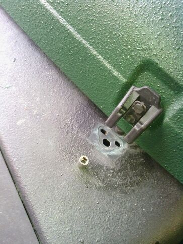

While buttoning everything up I manages to strip the hood hinge bolts.
Was looking around on the forum and apparently this is a common problem due to the flange that flops around underneath the hood causing the bolt threading to not catch just right resulting in stripping them. Went to the Home depot and picked-up some stainless steel replacement bolts.

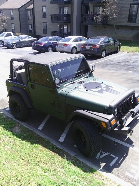

Slid the doors and the windshield lights back on and decided that on spray day I'm gonna coat the light brackets as well. It's starting to look like a jeep again....
Also ordered a set of vinyl '4.0' and 'Jeep' decals to go here.
I'm thinking about taking something similar to this ...
and painting it in black on either the hood or on the side maybe were the '4.0' would go...

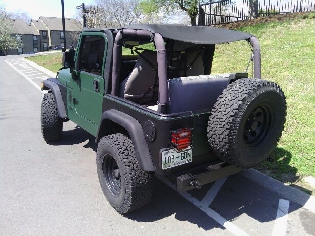

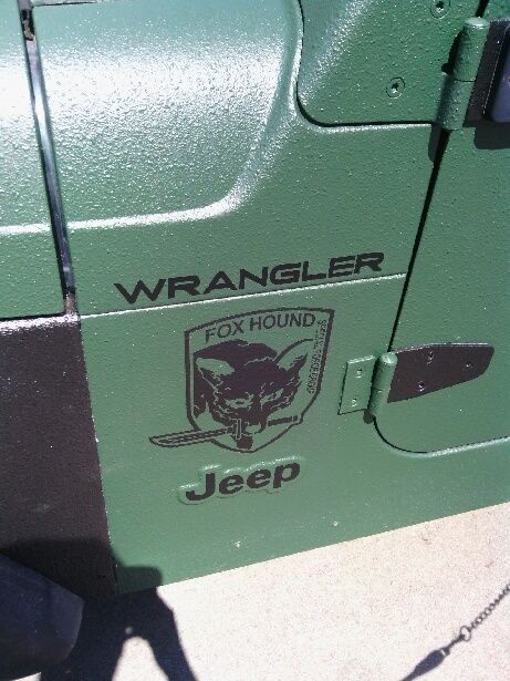

Heres an update of the finished product
I'm not your buddy, friend !
I'm not your friend, Pal !
I'm not your pal, buddy !
OMNIMAN is offline
post #13 of 31 Old 03-31-2015, 01:22 PM Thread Starter
OMNIMAN
Join Date: Jan 2015
Location: Nashville
Posts: 94

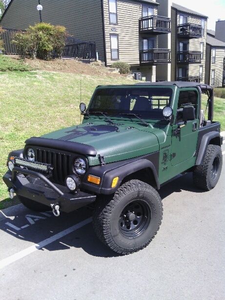

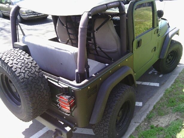

Update w/ pictures in day light wo/ hard top
So here we go...
Jungle love sprayed on Monstaliner with Barricade corner armor from Extreme Terrain...
... Trim finished with either black Monstaliner or Rusto rattle can bed liner.
Black decals from OutlawCustomdesigns.com
[B][/Rear tail light covers, Rear bumper 7/8" D-ring mounts, bumper end caps and gas cap door cover all from ExtremeTerrain.comB]
Reverse black flag from e-bay.
So there she is fellas...
Now time to shop for a winch and some rear netting and possible some 33"s
