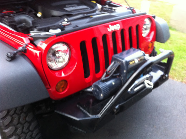

Day 3 - Superwinch 12.5k Install - winch sitting on bumper picture a little blurry sry
Day 3 - Superwinch 12.5k Install - Engine compartment and routing, used some liquid tight to run the cables in to prevent abrasion. I had to notch the battery holder shell to run cable into the battery and they turned battery 90 degrees so the cable is short and has to run across top of battery
Day 3 - Superwinch 12.5k Install - Complete, used some RTV around the liquid tight plastic conduit and the battery cables to seal them up, dont want water inside.

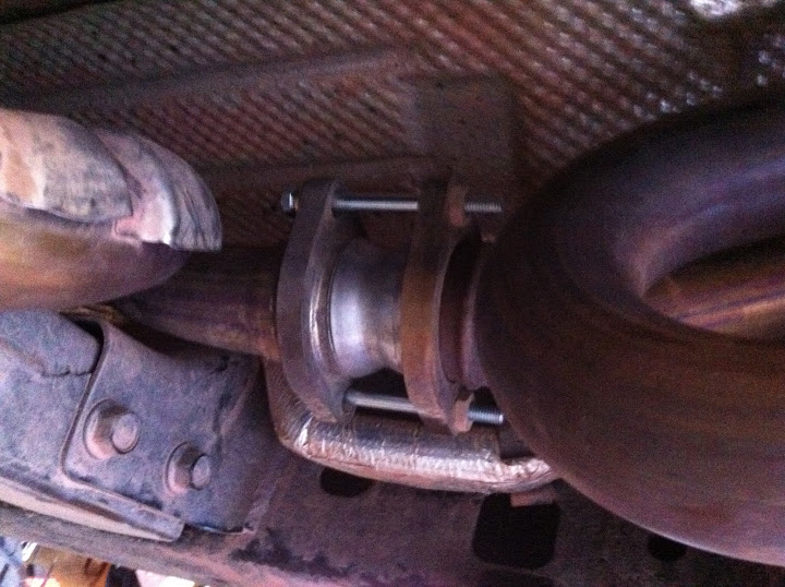

Teraflex exhaust spacers installed driver side
Teraflex exhaust spacers installed passenger side

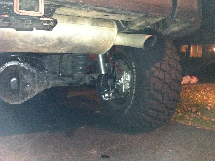

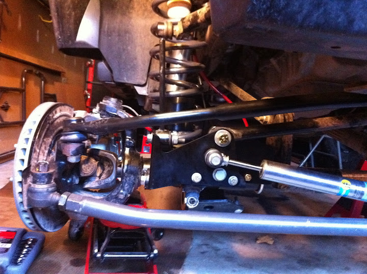

Drilled holes for the bump stops, installed bump stops and springs, installed shock doubler brackets along with reinstalling the LCA skids and installed the shocks. Tomorrow I start the high steer kit set up. I already have the drag link removed. Still have to drill out the knuckle though for the 7/8 drop in piece, so I can install the flipped drag link.
Spring and shocks on drivers side
Spring and shocks on passengers side
Installed heavy duty tie rod from Poly Performance
drilled out hole for drag link and put in insert and installed new drag link
removed rear swaybar links and installed them in the front
aligned and reconnected the track bar

Rear brake lines installed

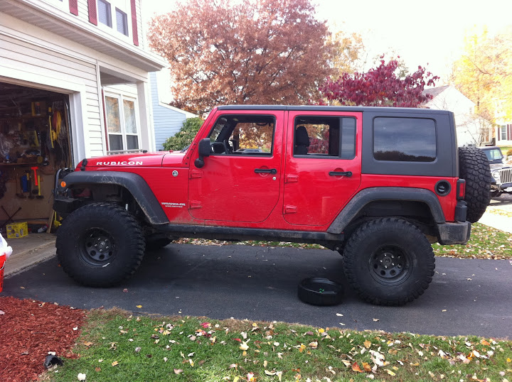

Well took 2.5 days and alot of work till 1am 2 nights in a row but BIG RED is done.
I even put my tags back on it today, registration showed up Thursday in the mail, just in time for the lift.

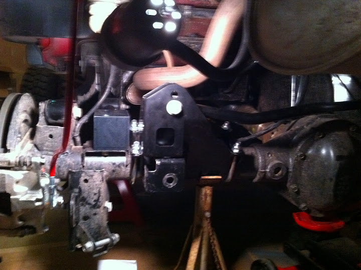

Day 50 - Put on these Rear Lower Control Arm Skids with Shock Mount
http://www.quadratec.com/products/16315_6408.htm
They bring the shock mounts up about 1.5 inches and have built 3/16 skid to make smaller strong rock targets
Shock mounts cut off and painted to stop the rust
Driver Side
Passenger side
This morning both sides little better light

Found the fix for the shock length part. Talked with AEV forums folks. will be moving/replacing up shock mount to get back the 1.5 inches lost at the bottom.

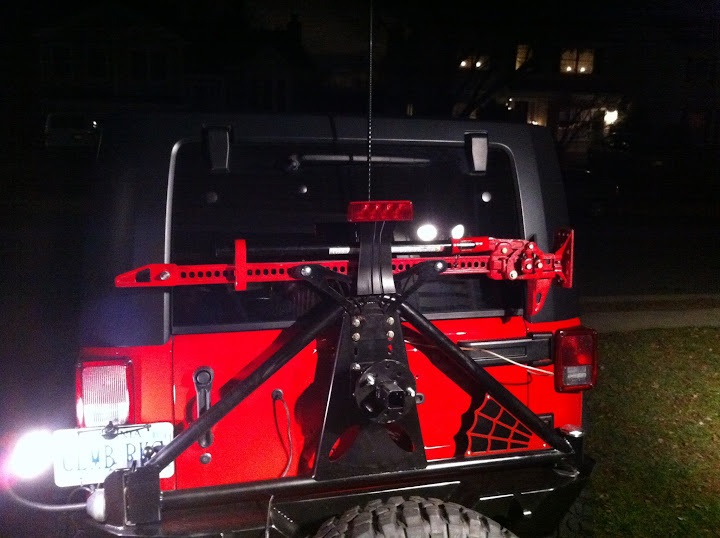

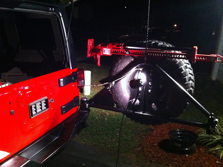

Got the Bumper painted up and did the install on it tonight, still need to put the swing out arm on maybe tomorrow or on Xmas eve.
primered bumper and swing out arm
primered all the little pieces too
painted the bumper Tuesday and Wednesday and installed it today
Rigged up temp tag and light holder till I get the PSC stuff installed

got busy and got the swing out on it tonight
Didn't leave the 3rd brake light like that but the pics shows the spider web in lower passenger side well.
moved brake light for now, wiring and all and rerouted CB antenna cable too
Gotta fix up the tag now, im sure some pooolice love to yell at me cause its partially blocked
