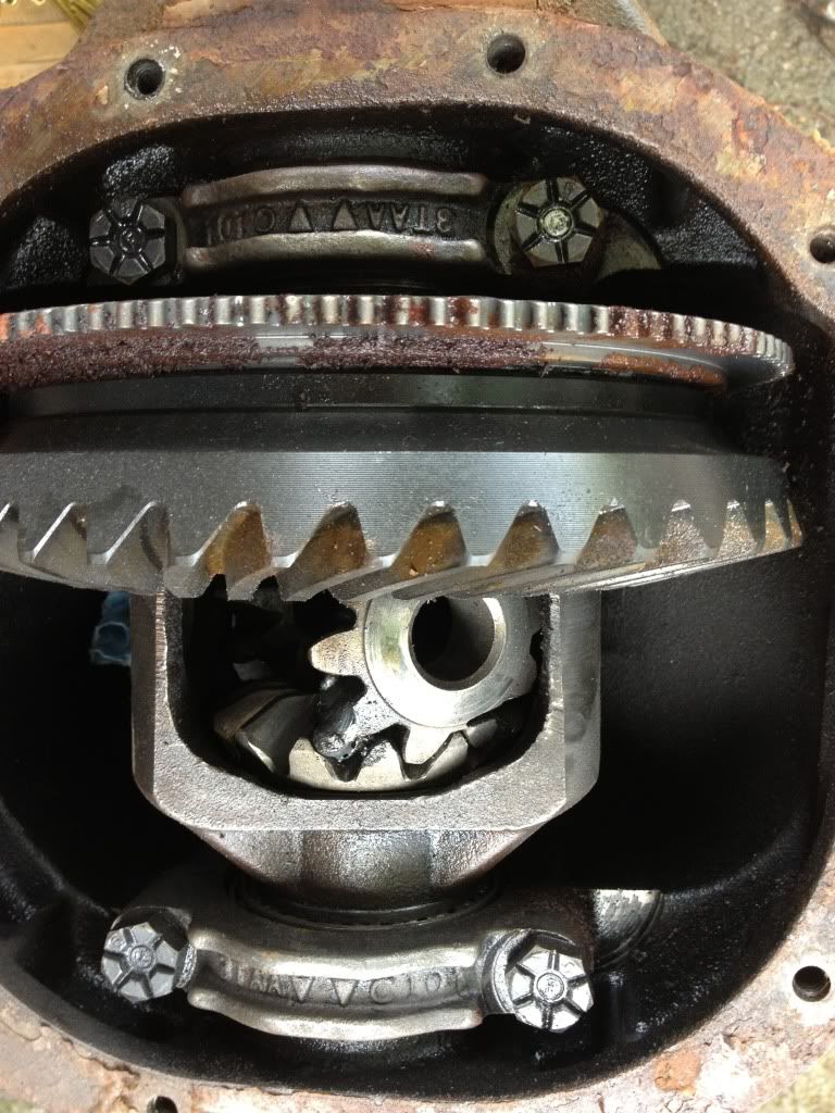

After some Father's Day activities I was able to out some time on the axle. Schaef89 was into an this weekend and him and I discussed some methods of extracting the spider gears. We basically concluded that prying the spiders out would be best since I ha already got the passenger side welds. So with two pry bars I pried the spider gears upward after I rotated them within the carrier. With some work they finally came loose.
What I started with...
What I ended with..
I'm going to install the Spartan locker this weekend or if I have a free night after work this week. Then I get to do the fun stuff, brake lines, brakes, axle tube seals, e-brakes, and paint. I'm hoping to have the axle under the jeep by Sunday.

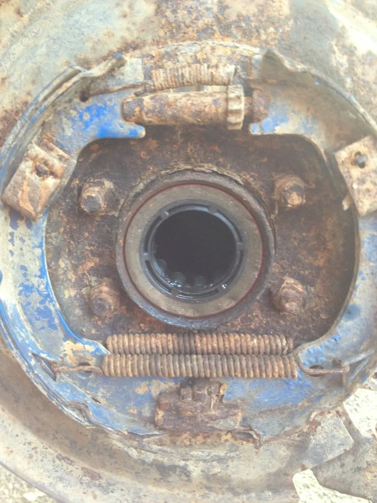

Small update. I replaced the axle tube seals with Ford seals after work tonight. Figured I didn't want to get this thing installed as have to tear it apart again to fix something that's easy to do anyway since I had the axle shafts out.
New seals pounded home..
