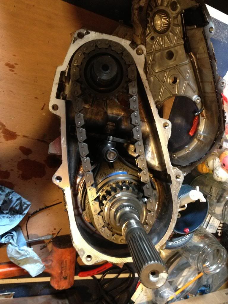

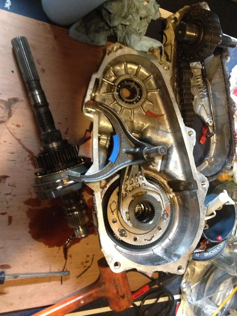

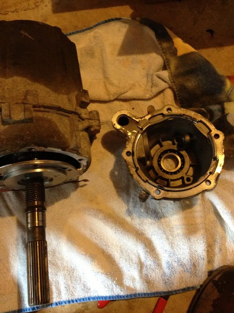

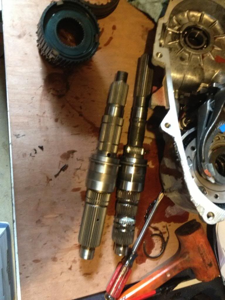

Last weekend I had some down time and decided to finish up my SYE. In all honesty the SYE couldn't have gone smoother, besides the snap rings of course.
Picking up where I left off..
Case Front half
Replacing the shaft
Shaft Comparison
And all finished up
Finding time to put this in will be tough. Since it has been so cold here I haven't been motivated to work outside at all. Hopefully I can catch a break and get a 50-60 degree day to get this in and measure for my driveshaft.
