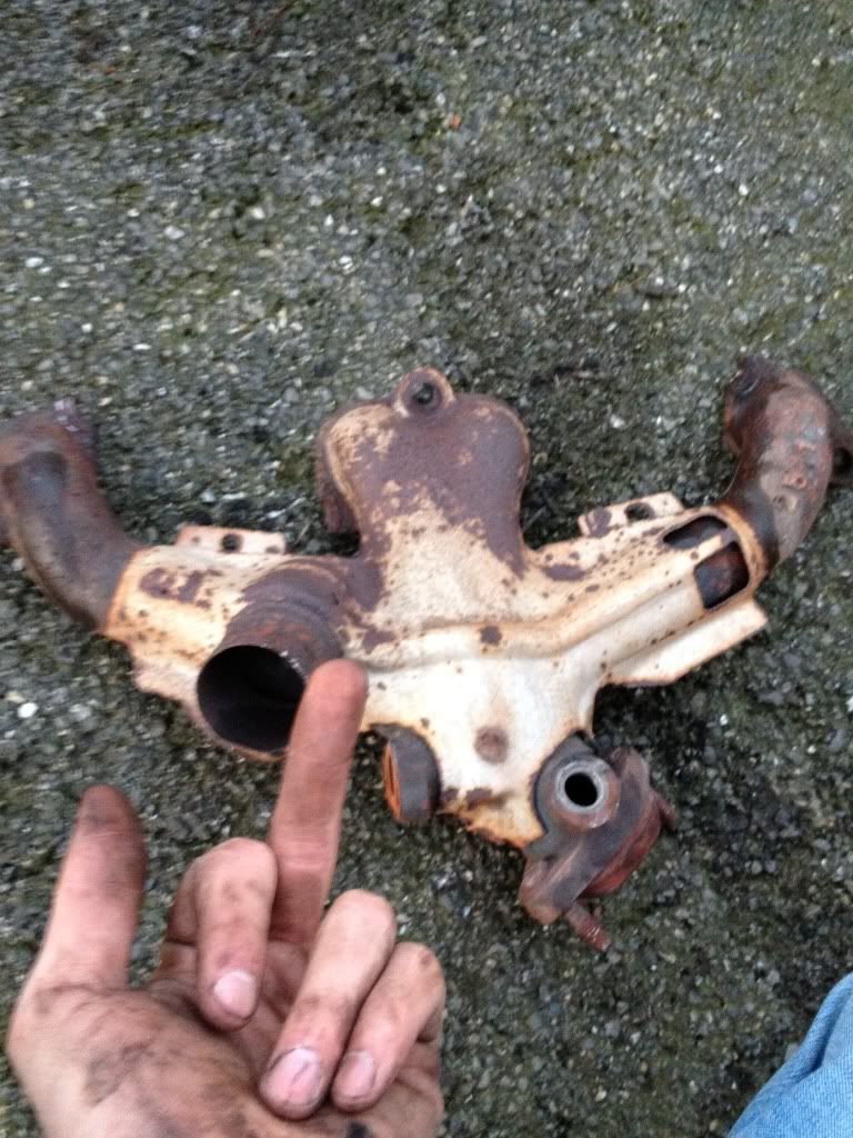

Wrenched on and off all day today. The bad part is it was one of those times I kept being interrupted and pulled off to handle other problems. I don't have much to show for todays work. All that matters is that the manifold is off. New one goes in tomorrow after I EZ-out the broken stud out of the block.
The only picture taken from the interrupted 2 hours to get this POS off....

Didn't complete the job today. I drilled a hole in the stud to use a bolt extractor but it was slightly off center and caused the extractor to snap. I drilled several small holes around the extractor to try and get it out but no dice. Ill try getting a smaller extractor tomorrow and heat as well to see if that works. Hopefully it does.

Jeeps off to the shop I work at tomorrow. Don't have the resources at my home to extract this stubborn stud. Gonna let the pro's work on it and see what happens.

The jeep is now road worthy again. The mechanic was able to drill the stud out and retap the hole. Got it back together lastnight and it runs like a champ

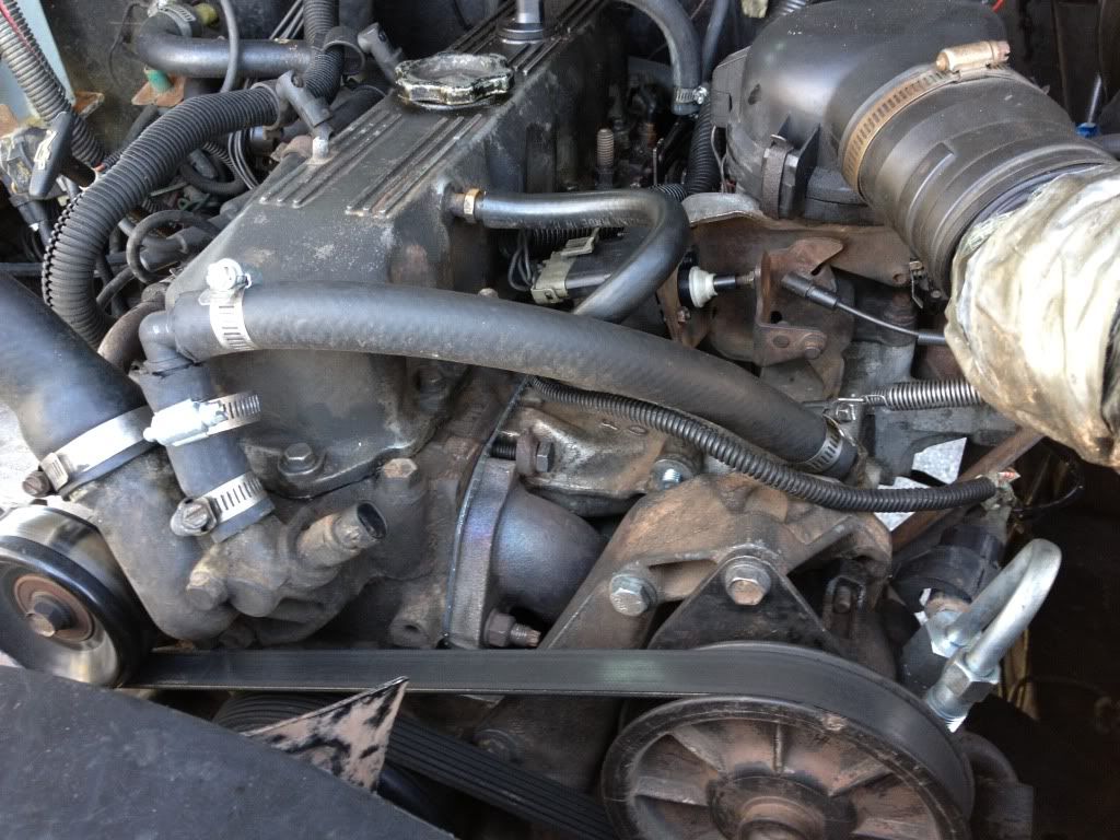

After a lot of discussion I realized when I swapped my motor I never returned the PCV valve to the front of the valve cover because on the 91 there is only an air fitting that comes out of the side of the valve cover with no grommet to put the PCV. Because of the constant vacuum on that line to release pressure from the crankcase and no PCV to buildup/release that pressure in the vaccum line it is causing a high idle run condition. I picked up a 90 degree brass fitting yesterday to replace the one in the valve cover now and am going to the parts store to get the necessary hoses and the PCV valve. Will it look ghettoized? Sure. But if it means itll run right I'm willing to do it. Besides I already had to get an adapter for my coolant line. I'll post up pictures when complete. Hopefully this solves the high idle problem and I can finally move on with my life. haha

Since the PCV frankenstein install the idle seemed to get better only when its warm. Still on a cold start the idle is high, between 1100-1250 in some cases. It's most noticeable when I begin to drive off from a parking spot. I can feel the engine just want to drive itself and when I put the clutch in the idle just rises. Could be a vacuum leak somewhere but when I inspected the lines everything was good. If it persists ill check my fuel pressure to see if its too high but I highly doubt that's the case since when I pulled the O2 sensor it was white indicated a lean run condition. Any ideas would be helpful. I already adjusted by TPS and replaced the IAC.
Check your throttle cable, many times owners will adjust the stop on the throttle plate to make up for a inoperable IACV/IAC/AIV (choose your air control acronym!).

I have the stock length shackles on right now so the angle is pretty normal. Probably just the shadowing in the picture. As far as throttle cable I look into it. When I was installing the manifold I didn't notice any irregularity of the cable but I'll check. Thanks for the input!
