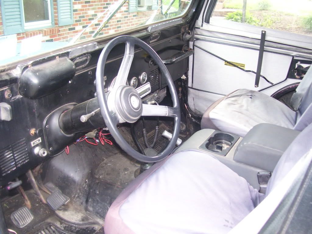

Some Interior Pics..

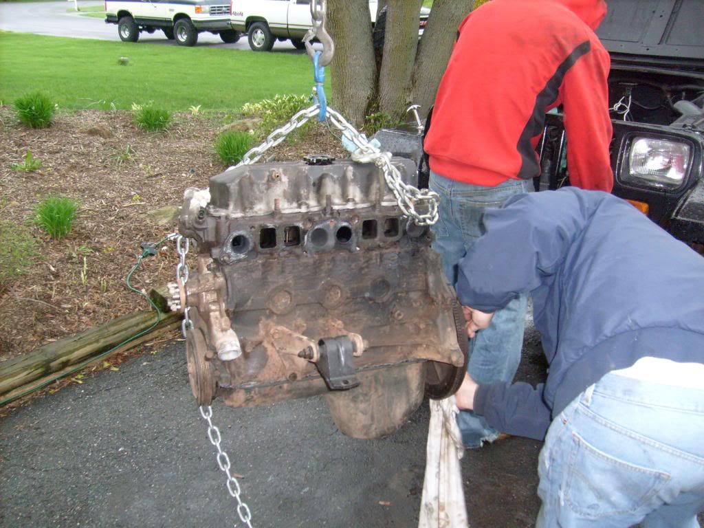

The day the engine was picked up;
Thanks to Schaef89 who bought the engine stand, and did crucial degreasing of this once very muddy engine. For this period of time I was at college 4 hours away, so I am blessed that my brother went through all the trouble he did for me to find this and prep it for installation.
More photos of the new to me engine;

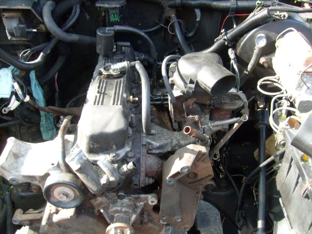

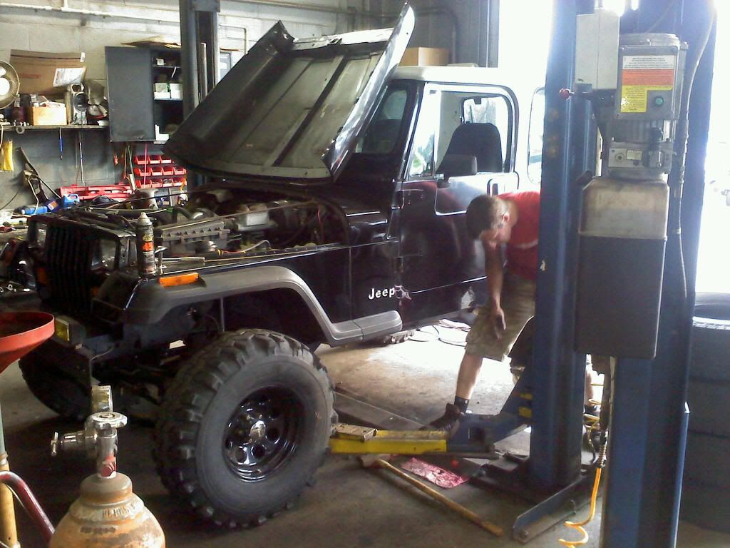

When spring break rolled around it was time to get some serious work done. The goal was to get the engine out and the newer engine in.
Pictures of the progression of the engine swap;
Unhookin all the necessary fuel lines, vacuum hoses, exhaust components, and removing the transmission. A block was placed under the bellhousing to keep balance of the transmission for easier reinstallation.
Hooked up to the cherry picker and ready to be yanked out
The only time i was glad my jeep wasn't lifted when this swap occurred. Removing the front clip would've been salt for the wound at this point. Notice the front bumper, It was raining on and off all day.
Empty engine bay and ready for the goods...

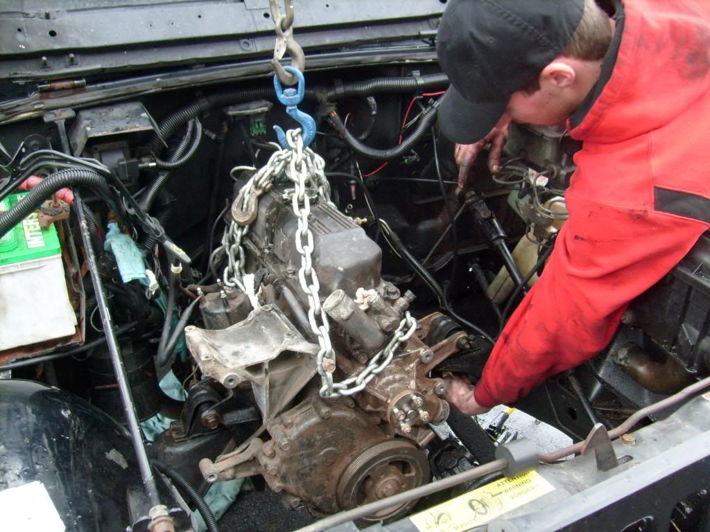

The new engine going in. Note: I was swapping from a 90 V-Belt driven 2.5L engine to a 91 Serpentine Belt Driven 2.5L. Some components had to be adapted. The alternator had to be hooked up to an external regulator and power steering hoses had to be purchased for that particular year (91).
Dropping in and aligning the new engine;
Motor mounts bolted tight and ready for accessories to be reinstalled;

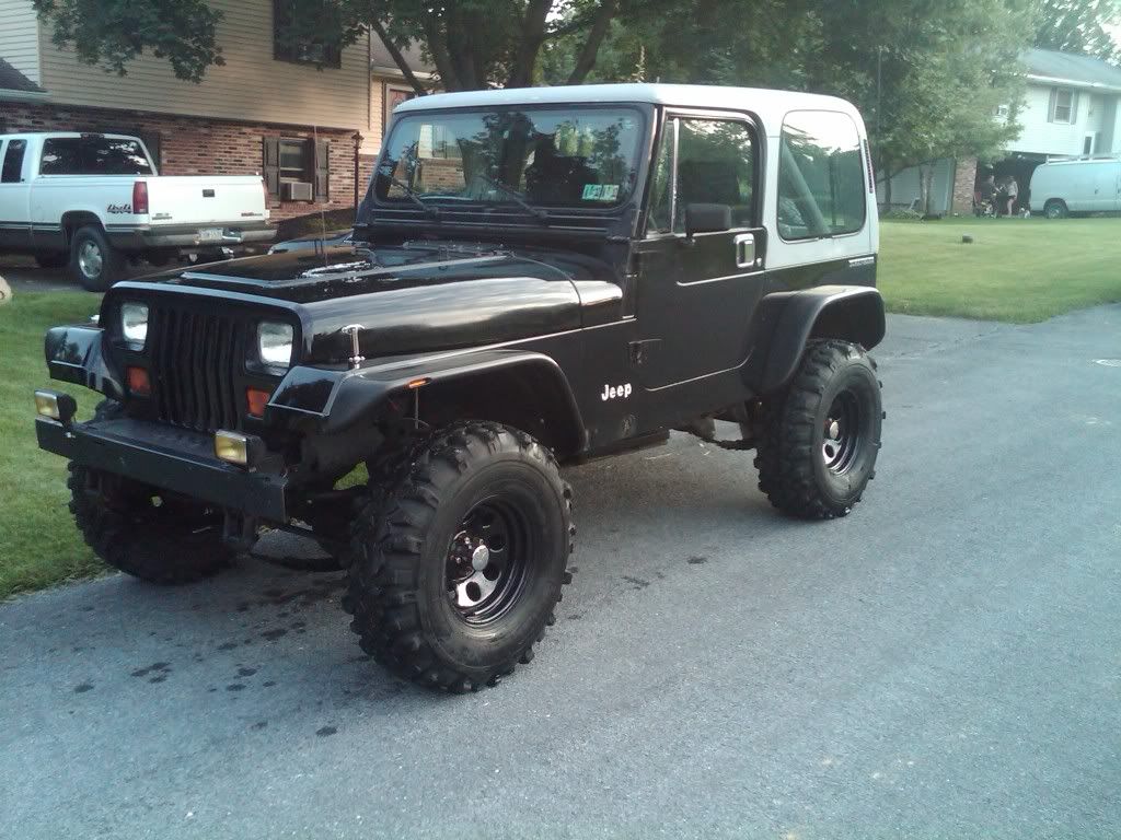

I was home for the summer and had bought my lift springs previous to when the engine took a dive on me. So installing the lift and getting larger tires was the top of my priority list. During my college career I have been working at an automotive shop not too far away from my house. I was lucky enough to be given an opportunity to install my lift and tires there using hydraulic lifts and air tools (usually using hand tools on the reg). I went with the Rough Country 4 inch lift for the time being. It was cheaper then the rest and Ive heard good things in regards to quality since the new generation leaf springs were manufactured. Because a spare set of hands were hard to come by during the lift install pictures were taken afterwards:
After the lift and unbalanced (at the time) super swampers were installed:

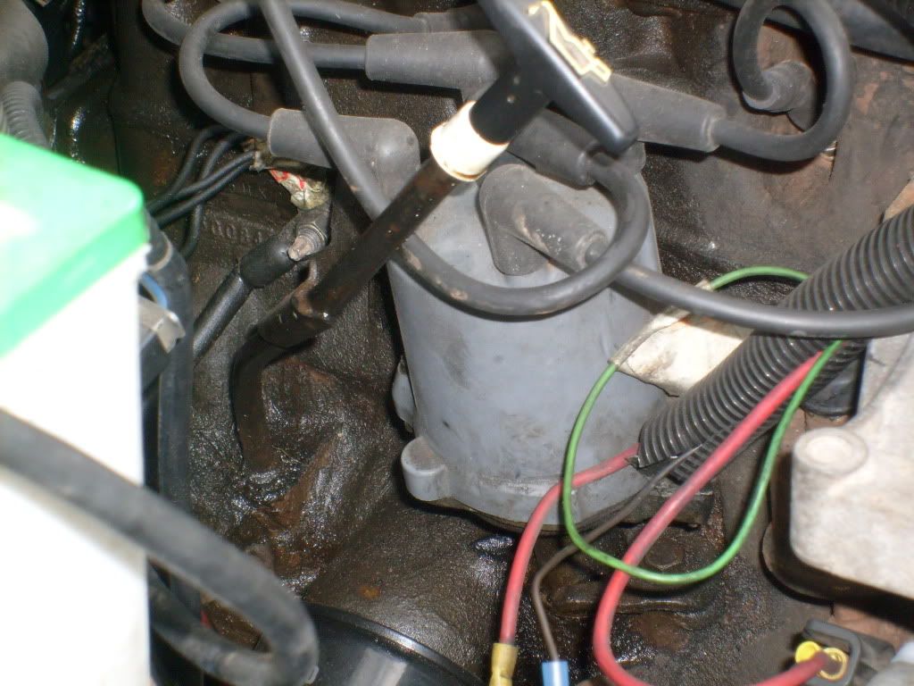

Every since the engine swap there has been a smell of burning oil when driving at highway speeds. At first I thought it was a leaking oil pan when I discovered the side of the pan wet and starter to be saturated in oil. I replaced the oil pan gasket and the leak persisted. Upon further examination it appeared the distributor seal was leaking at the mount on the block.
As you can tell the mount is very wet from oil leaking from it. It's been leaking down the side of the block and onto the oil pan
Distributor back in and ready to rock and roll.
To replace the seal took me only about 30 mins. Very simple fix and hopefully depletes the burning oil smell I was gifted with on the highways.
