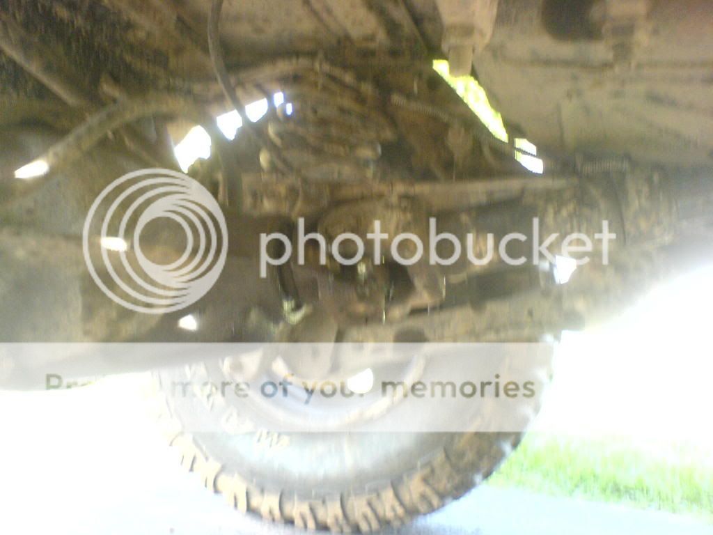

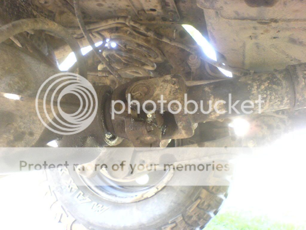

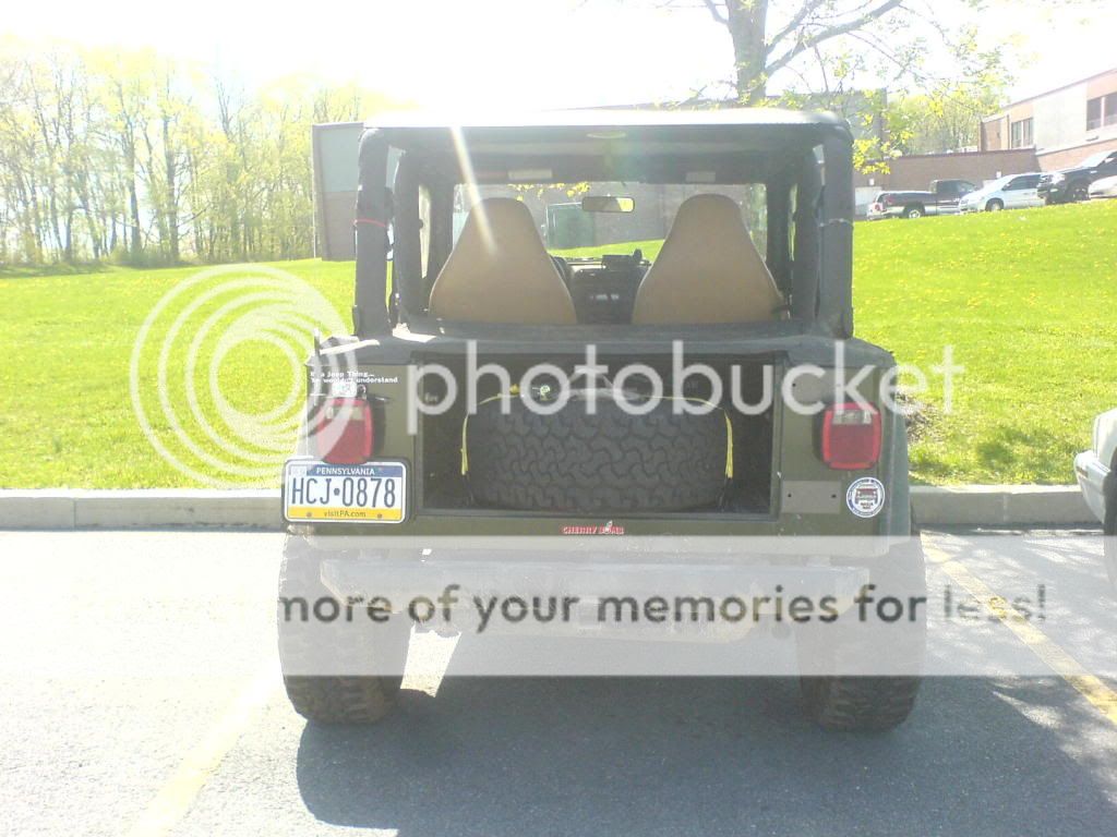

so I pulled off my tailgate yesterday
so some pics for today...
I think my pinion angle needs to come up a tad, which stinks because that means I gotta spend some money on adjustable uppers, or measure and have some fixed ones made up
*ignore the leaky/wet pinion.... I know its messed up

and all that grease out of the u joints is because I just lubed em up...

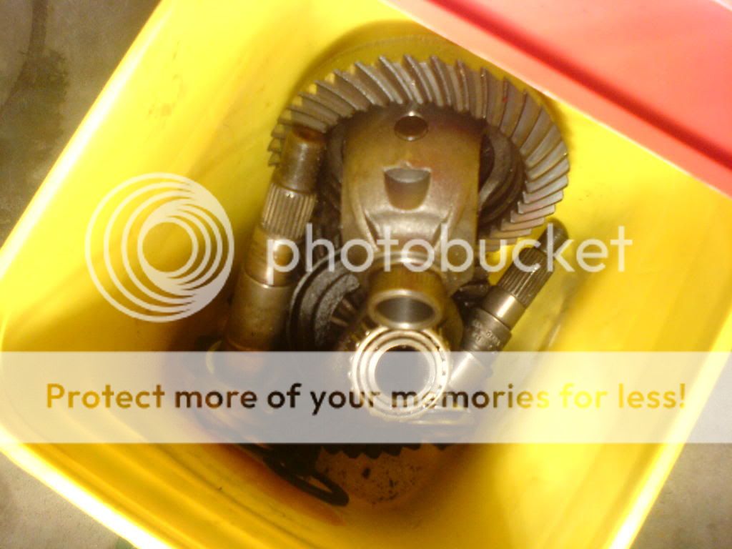

the best twenty bucks I ever spent!
dana 4.10's for a 35 and hp 30 and carriers!!!

Why did you take off the tailgate?

Your pinion angle is definitely too low.......not sure why you don't already have adjustable uppers.
I know I know
and I looked under my jeep and stared and stared at those mounts... there just aint enough room
I will probably be getting a set made up at a local reputable shop when they install my gears
it was a " i gotta do something and this is what I got right now move..."
why not
I took it off kind of for the fun of it, I personally think it looks cool/ different like that, and I will be running that safari top all summer, so the extra drainage will be greatly appreciated... no more flooded floor boards
it looks kinda baja-esque in my mind
and even with 2.5" I will still need a cv style track bar bracket correct?
I was also pondering a 8.8 for a while, in which case I would set my pinion angle before I burnt on the brackets, allowing for a proper angle with all stock ca's and trackbar

You could probably adjust that pinion angle with cam bolts. By far the cheapest, but at the same time not as great, and you have to slot the holes.. Mine came with cam bolts in the front, and I adjusted the front pinion angle with those, and the rear I adjusted with rustys offroad ruca's.
Just an idea.

True, the 97's have cam bolts up front, I had to keep them set at the stock spec when I added some longer and beefier lca's up front. the aftermarket cam bolts supposedly work a little differently, and most of the time you have to weld them in place so they dont move, something I can do... but I already botched it, so Im kind of thinking I need to fix it the right way, especially since Im looking a a tt in the future
I am considering doing adj lowers and bringing the axle in some, once again not the absolute best way, but my trackbar just kisses the gas tank skid as is.
Regardless of lift height, you'll be rotating the axle pinion higher up than it is in stock form so yes, you'll want the CV bracket. I no longer have a rear track bar so that's not a worry of mine.
And about the 8.8 brackets--that's a good way to do it but you'll appreciate getting rid of the stock control arms when the day comes. Bushings suck.

In other news I ordered up a set of rear adjustable upper arms he only charged 110 for the set, and is using the same thread size as a johnny joint so I can swap out the bushing for a johnny joint as funds allow. Now I just need a trackbar bracket and than I can actually set my pinion angle

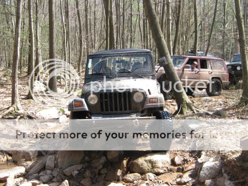

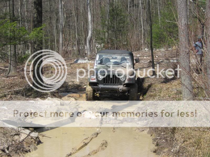

some more wheeling pics that finally made it to the interwebz
