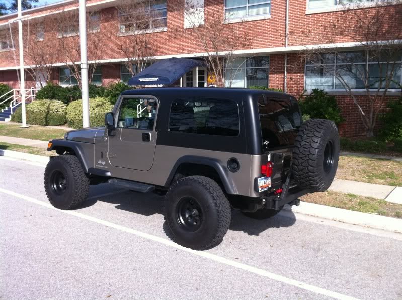

A law enforcement instructor position opened up at the FLETC compound near my home and I said that I would take it on one condition...That I got to buy another jeep. (I had to sell my previous 01 2.5 4 banger "Commandant" before I left for Iraq in 2008)...She agreed to my one condition therefore after a long thought out thorough conducive search...the purchase was made!!! I bought a 2006 LJ! He had just over 40,000 miles on him and already had a 4in RC lift and new 35x12.50r15 BFG all terrains on Mickey Thompson Black signature series rims. Also, he had DBA survival series rotors. I could not of asked for a better deal!
My wife and I didn't have the jeep off of the lot for more than 5 minutes before he was given the name "Sarge"!
Here is a pic shown just off of the lot.
I want to do this build right so I am going to go back and log everything I have done to Sarge, since I got him 4 months ago. I will be adding pics as I go as well.

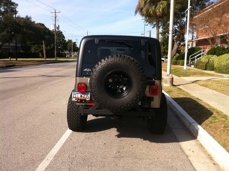

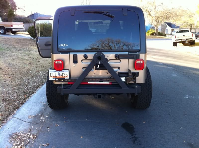

The Rancho Rear Tire Carrier...
Installing this carrier was sort of a headache probably because I decided to do the install myself and by myself! Right off the back the instructions were okay...Nothing to fancy but not un useful either. Getting the factory bumper off was no problem, however the first problem I ran into was the pre drilled holes on the Rancho to secure the bumper didn't exactly line up with the holes on my frame. That made for a pain in the a$$, especially since the bumper needed to be exactly lined up so that the spots could be marked for the holes to be drilled. I urge that anyone who buys this bumper to be careful when drilling these two holes because they are so close to the back of the hub (ill post a pic). After the holes were drilled the rest was pretty easy. Again the bolts didn't line up perfectly, but I was able to work them in. After installing and tightening down the bumper I installed the tire carrier. The carrier went on much easier than the bumper. Some small flaws to note however is the degree of the post that the carrier swings on. My degree was off a little off which didn't allow the swing portion to close properly. This was alleviated although once I put the tire on (a little) It still catches a little. Another problem was the pin that secures the carrier to the bumper. The pin was bigger than the pre existing hole on the carrier and bumper. I had to drill out the hole a little bigger to get the pin in. I do give Rancho kudos to putting a spot on the back of the bumper to store a hi lift jack. There is also enough room to custom install a jerry can or two if one wishes.
These were all minor flaws that would keep me from giving this product 5 out of 5 stars! Overall though I am satisfied with the bumper seeing how I got it off of Amazon for only 280 bucks shipped to my door. The bumper is priced at 500. With the price that I got it for, I can eat the flaws.
Here are some pics of the carrier installed

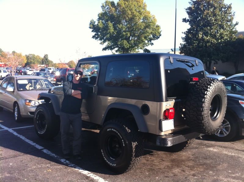

Ok so here is the breakdown of the JKS body lift and Shifter extension bracket...
First off, it is a blessing to have a neighbor (good friend) that has a full shop in his back yard with a hydraulic lift!
We started just after 7 p.m. Here are the pics of the measurements taken before the lift went on.
The front measured out at about 39 3/8"
The back measured out at about 39 7/8"
Sarge going up for the lift kit install
Putting the kit on took literally like 30 minutes and that was with bs'ing and checking out Sarge's under carriage!
Pic of all pucks in place!
Not going with the MML, we had to modify the fan shoud...with the right tool it went fast!
Just when we thought this was going to be easy...HA...the damn SHIFTER EXTENSION BRACKET stepped up to shut us down...
First off the extension didn't come with any instructions! So we googled what we could and then made sense of the rest! One of the extension pieces that came with the kit didn't quite fit into the relocation bracket so we had to grind that down first! Next the shifter itself didn't fit into the relocation bracket, so that too had to be grinded down!! This maybe what happens when we outsource!...just a thought! Regardless we got the pieces grinded and in place...Once in the shifter was still hitting the bottom of the sealing plastic and rubber bracket that went over hull...
So we had to modify that too! It was sort of a headache...but we got it done...
Once everything was done we lowered Sarge back down and checked the additional clearance...This is what we got!
Front we measured out at 41"
The rear measured out at 41 7/8"
Overall we got +1 5/8" gain in the front and full +2" in the rear...3 hours but it got done...
Sarge this morning before teaching my CrossFit Class
Let me know what you guys think?
