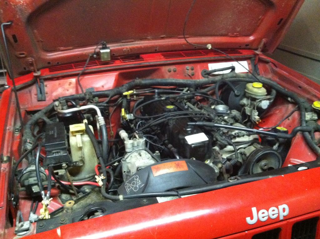

Here is a photo of the new Jeep as she sits now:
Right now I'm working on all the small mechanical issues and maintenance, but I'd like to start modding it ASAP. I should have most of that done soon. I figured I'd start a thread so I can document the process and ask questions relating to any mechanical or modding issues I encounter.I'm no mechanic, but I'm not an idiot either, and with each project I've done, I've been getting more an more comfortable doing the work myself. The Jeep wasn't too expensive either, so I'm not too worried about messing it up while I continue to learn.

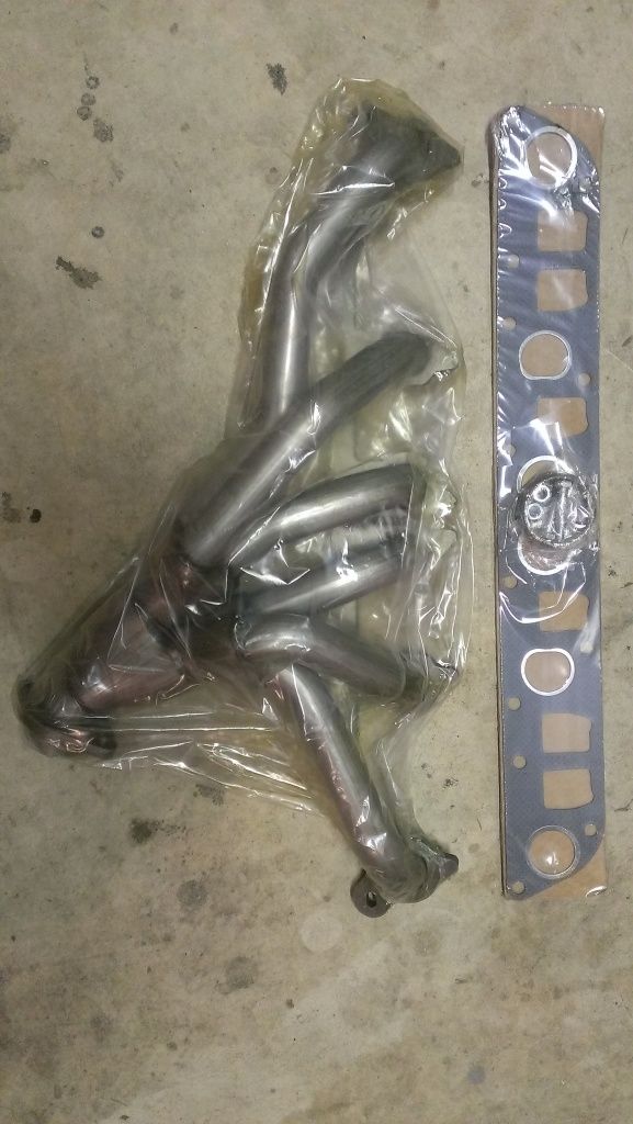

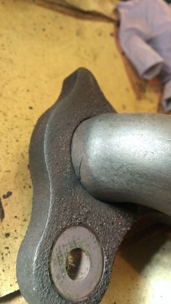

It's been awhile since the last update, so I figured I better get to it! Things slowed down a bit on Jeep, then I developed an exhaust manifold leak. The classic signs and symptoms were there, plus I could see a crack in the manifold. I ordered a replacement manifold and started the install yesterday. I ended up going with an APN manifold from ineedparts.com
Here is a picture of the new manifold. It's a lot beefier than the stock manifold, so hopefully it will hold up:
As of tonight I have everything thing removed and out of the way (air box, electric fan, power steering pump, intake manifold, old exhaust manifold), and I'm about ready to install the new one. While I had a nice clear view of the driver side motor mount I noticed how worn out it was. So I went ahead and picked up some replacement mounts. I'd like to get some Brown Dog mounts, but my current budget, and the fact that the current mounts looked like the might disintegrate if I stared at them too long I opted for some Chinese crap from the local parts store. I hope I don't end up regretting that later, and will eventually pony up the bucks for some quality mounts. All these small expenses keep eating into my lift/tires fund.

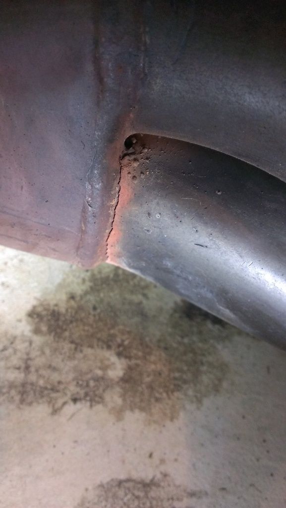

Here are some pictures of the cracks in the manifold:
Tonight/tomorrow I'll get the motor mounts replaced, the new exhaust manifold back on and everything else put back together. Hopefully this will be the last mechanical issue that will come up before I get the lift.

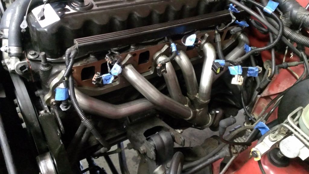

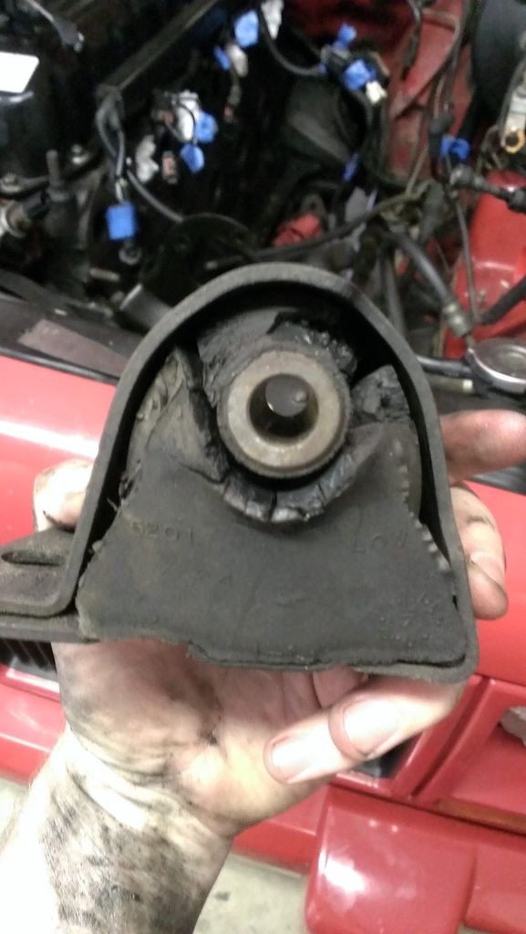

Well the motor mount install went rather smoothly. I had to do a some minimal grinding to get the new mounts to fit into the engine brackets. It was one of the easiest projects I've done on either of my jeeps. The driver side mount was pretty much shot. The passenger side looked pretty good.
The new APN exhaust manifold bolted up great, but I'm having some issues getting the intake manifold to mount properly. I've read some complaints about the the 99 intake manifold needing some grinding to fit, but everyone swears up and down that the pre-99 (and post renix) intake manifolds should fit. I'm going to go back out there this morning and give it a few more tries before grinding.
New motor mounts and new APN manifold:

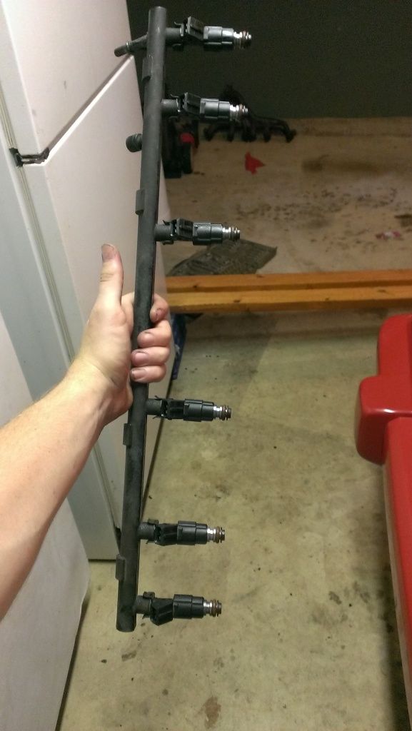

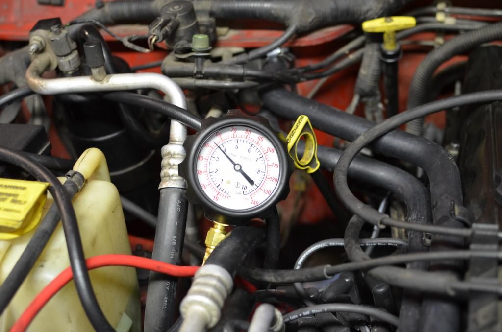

Next up on the list of mechanical issues is trying to iron out I'm a problem with starting my XJ. The truck never starts on the first try but always the second. After some research it could either be a leaky injector, a battery voltage problem, or the check valve on the fuel pump assembly. I'm going to get the battery checked out and replace the single hole injectors with 4-hole (703). I went ahead and ordered the injector service kit today, and I've got a list of vehicles that have the 703s on them and I plan on hitting the junkyard soon. I figured I wanted to replace the injectors anyways, and hopefully it will fix my starting issues. If it doesn't looks like I'll be dropping the tank and replacing the fuel pump assembly.
Once I get the injectors rebuilt and installed I'll report back on the starting issue.

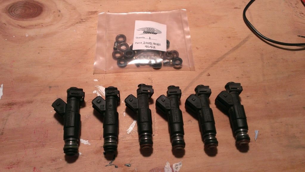

Well I finally got the 703s in! I had to go to two different pick-and-pulls to find enough injectors. The first yard only had one set of four. The second yard had a better selection and I was able to find six more. I picked out the best six and started the rebuild. I had previously ordered a service kit from Mr. Injector. If anyone is looking to do this upgrade I highly recommend ordering from him. I placed my order on Friday morning and had the kit by Monday afternoon (ID to VA). He also threw in two extra o-rings, one extra pintle cap, and one extra filter. That was really nice considering I forgot to heat up the first pintle cap before trying to put it on the injector and broke it.
703s before rebuild...
Other than that the whole project was really easy. The only thing I wish I had done differently was replace the injectors when I had the intake manifold off. It would have made cleaning the injector ports much easier. After I pulled out my stock injectors there was a bunch of crap in the port that needed to be cleaned out before attempting to re-seat the new injectors. This part of the project took the longest. I painstaking cleaned each port, making sure not to knock any of the black sludgy stuff into the intake manifold. I went ahead testes the new injectors for leaks, and reset the computer. I'm hoping that this might solve my starting issues. I can't believe that with all that sludge in the injector ports that there could have been a good seal, and ultimately the starting problem is due to a leaky injector. If not, looks like my next project will be dropping the tank and replacing the fuel module. Other than that there isn't much else but lift it and start with the mods!

The starting problems seems to have improved a little, but hasn't gone away completely... So I'm going to go buy a fuel pressure test kit from HF and try and see if it's an injector problem or a check valve problem. Once I get the test gauge I guess I'll go from there...
