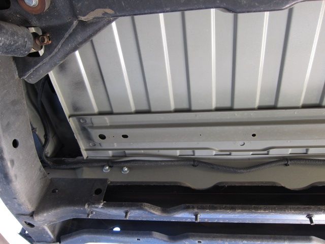

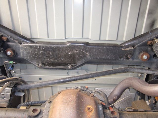

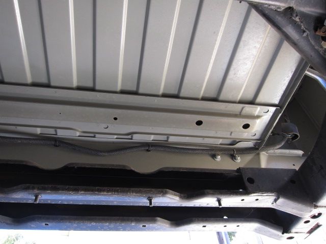

Originally Posted by dayriesw View Post
Awesome order. When you remove the stock tank, could you take a picture underneath the tub looking back toward the rear of the tub. I will be doing something similar and have been trying to research an idea but can't find any pictures.
Mike did you still want to see these pics, I took some for you and can post them if you want?

post #56 of 630 Old 03-25-2013, 05:55 PM
dayriesw
dayriesw's Avatar
1987 MJ Comanche
Location: Louisiana
Posts: 6,140
Yeah. That would be great. Mostly I was just looking for a picture of where the back sheet metal and bottom of the tub comes together from underneath. Thanks again.
Mike here you go, if there is a different angle you are looking for let me know I took several pictures from different angles.
Rear passenger side
Rear drivers side

post #59 of 630 Old 03-26-2013, 09:08 AM
Sundowner
Posts: 6,408
Those are some extremely useful pictures of the gas tank area; thank you. Now I can see exactly which pieces of metal are going bye-bye when it comes time to build my tank.
Thanks very much. And that is a very clean underneath.
