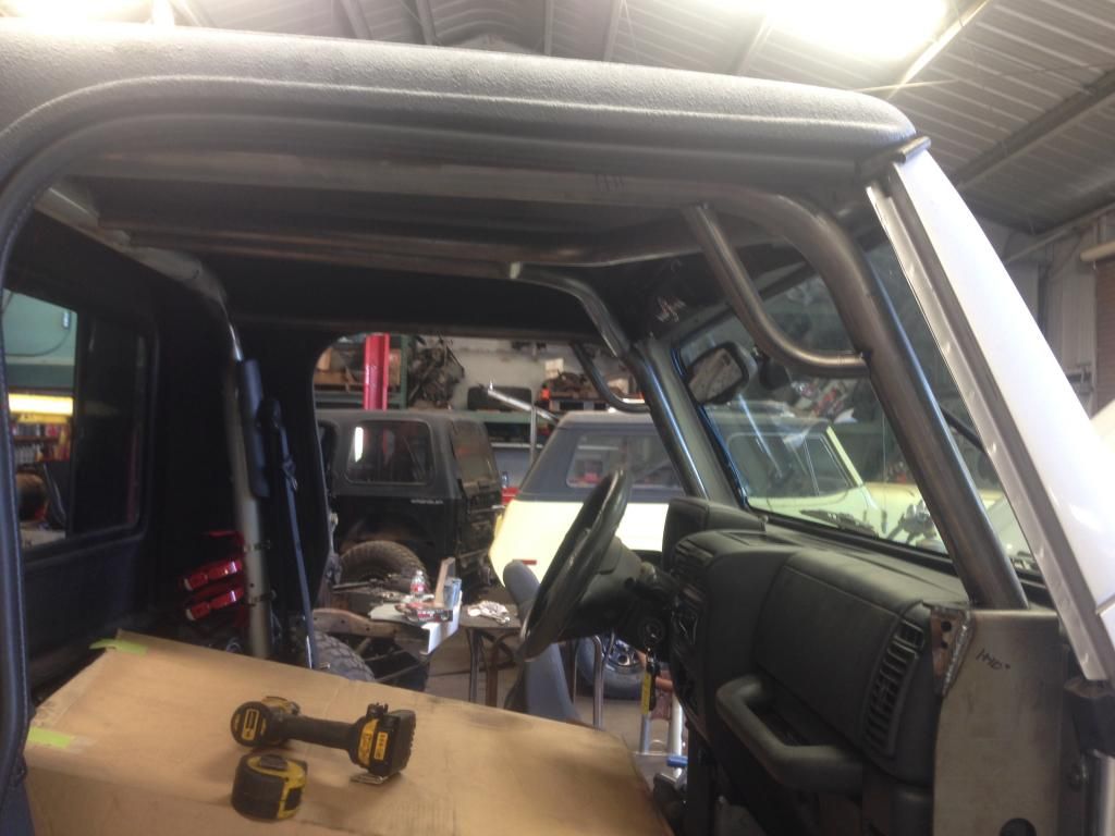

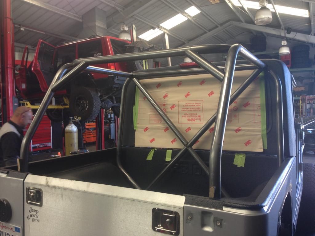

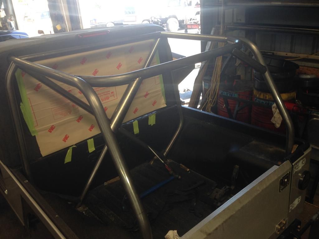

Making progress, decided to scrap the Poly Baja Basket (its for sale if you know anyone interested). Toby drew up some baskets in Solid works, post some pics of those soon. Here are a couple of pics of the cab cage and bed cage, the cage passes through the cab just need to figure out a way to seal that area. GR8TOPS makes some rubber grommets but they are for the stock cage which is 2.25.

cage looks great man. I am suprised however with the style cage you decided on since it now takes away from the truck look.

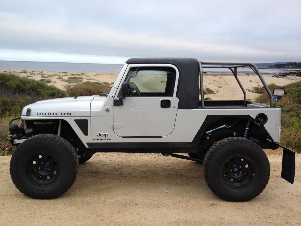

This. But I understand. Cage looks good. Got a profile shot?

I will take some profile shots tonight, I was torn on the upper basket. If I would have ditched it I could have had the D pillars come at a 45 degree angle where they exited the cab, would have looked really clean and kept the pickup look. As much as I wanted to do that, storage took priority. The upper basket will almost always have nothing but wood in it. When I am in the backcountry I like a fire, and I am not talking your average fire....

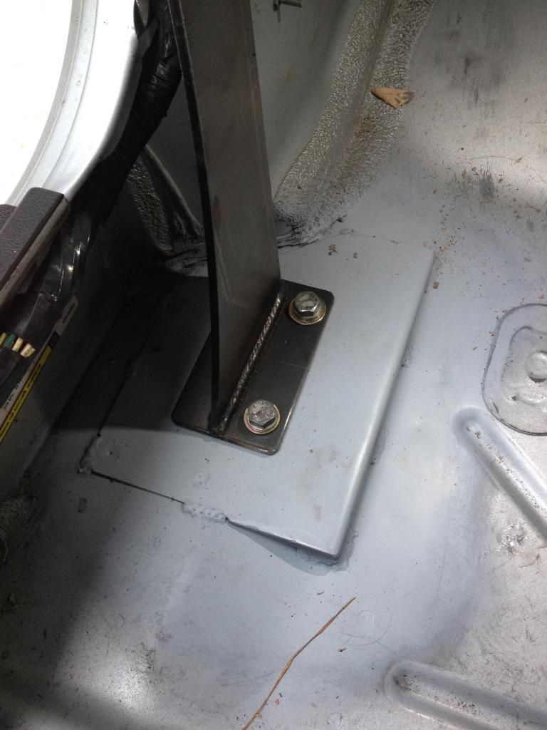

Here are a couple of profile shots, Ballistic is building the baskets should have them next week. Going to weld them to the cage, figure out some mounts for my spare rear driveshaft and other necessities...then pull it and have it powder coated. Toby at XXX Traction cut the base plates off the Genright Pillars and welded a stout piece of metal to the floorboard with some nutserts. I am also really digging the A pillar spreader, it allows easy access to the sPOD and will provide a place to mount my CB and my shotgun
