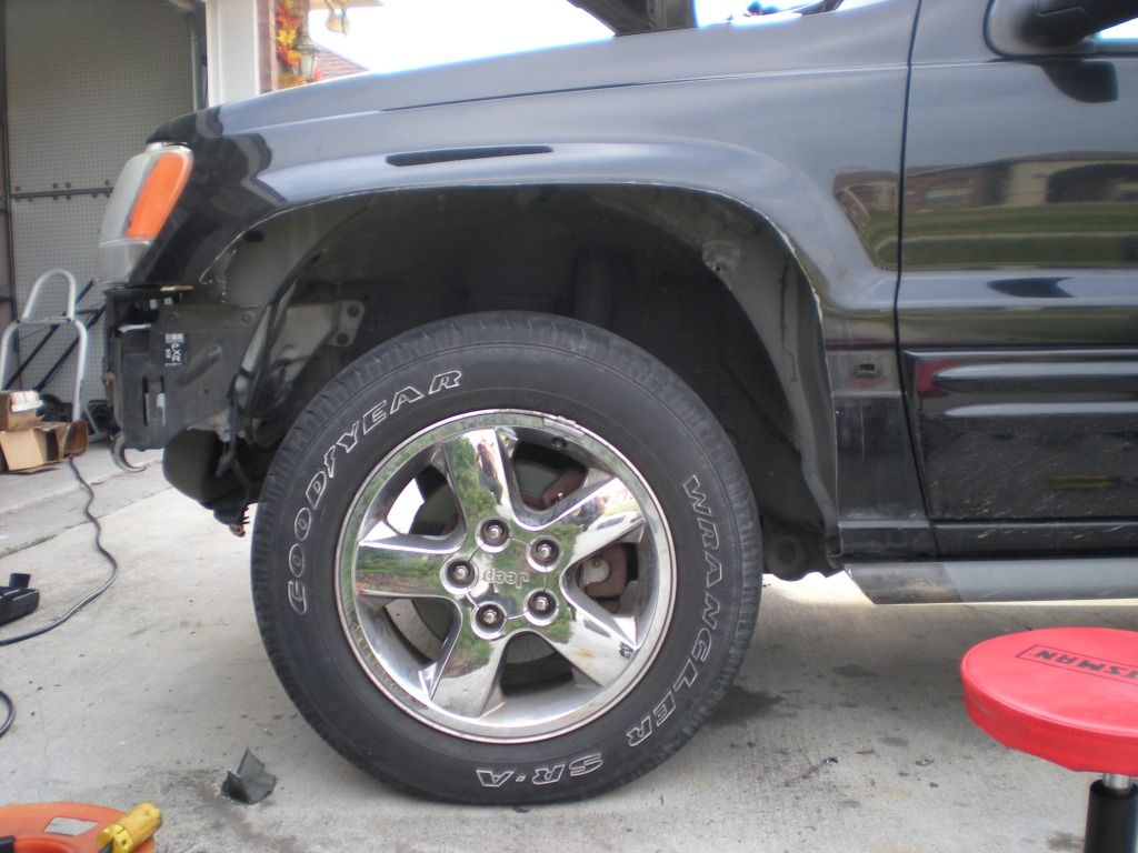

Front Fender Trimming
So today I bit the bullet and started trimming my front fenders. Snapped some pictures of the process as I went. Started like this (obviously).
I taped off the line I wanted to cut. I didn't want to bother with rolling the front fenders, so I just cut where I wanted them to be.
First time ever using an angle grinder, too so I was extra nervous about that. The grinder cuts like butter with a cutoff wheel, but it still wasn't the prettiest or straightest of cuts due to inexperience. The curves were kinda challenging for me. Had to do quite a bit of touch up with a grinder wheel, then deburr with the dremel.
As you can see, the curve isn't perfect and its' still just a little uneven, but I think after I hit it with some Mopar touch-up paint and get the door trim on it, it'll look much better. Here's what I cut off. Took off quite a bit.
Here's the driver's side done.
Put the front bumper fascia back up and taped a line to cut to match the new fender line.
Used tin snips and a sanding block to clean it up afterwards. Passenger side turned out pretty nice. I took it off a little higher than most when I cut the fog lights out so I ended up having to use a coping saw to cut the foam behind the bumper.
The driver's side was a different story. I taped the line I wanted to cut, then like a moron, cut the wrong side of the tape. It's hard to tell in this picture, but the bumper fascia ends about an inch before the fender. Doh! Oh well, I'm planning on replacing it with an LSR front bumper in about 6-9 months, so I guess I can live with it until then. Still pretty mad at myself, though. I got in a hurry with the fascia. Live and learn, I guess.

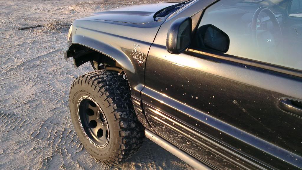

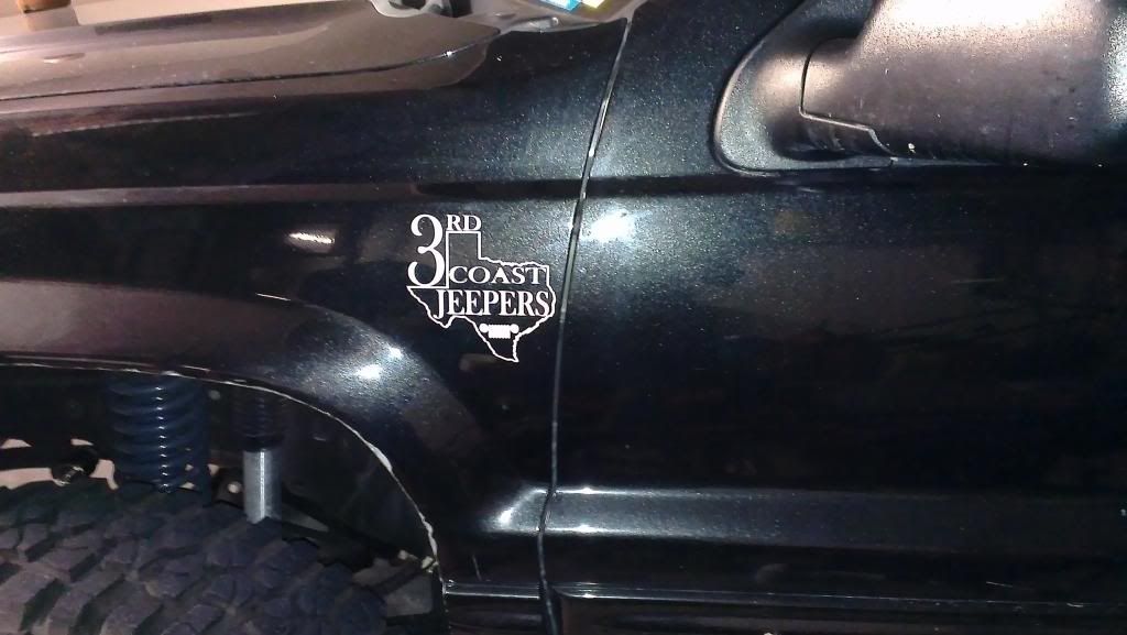

Got a couple more pics while I was down at the bay fishing. Thought they turned out pretty well.
Finally broke down and put some club logos on her, too. I was hesitant, but I like the way they look. Still nice and simple looking. They're still trying to talk me into a windshield banner, too, but I'm not sure about that.
