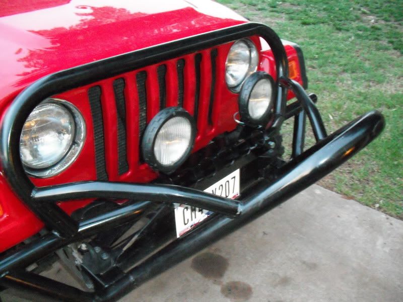

ToysbyTroy Winch STINGER

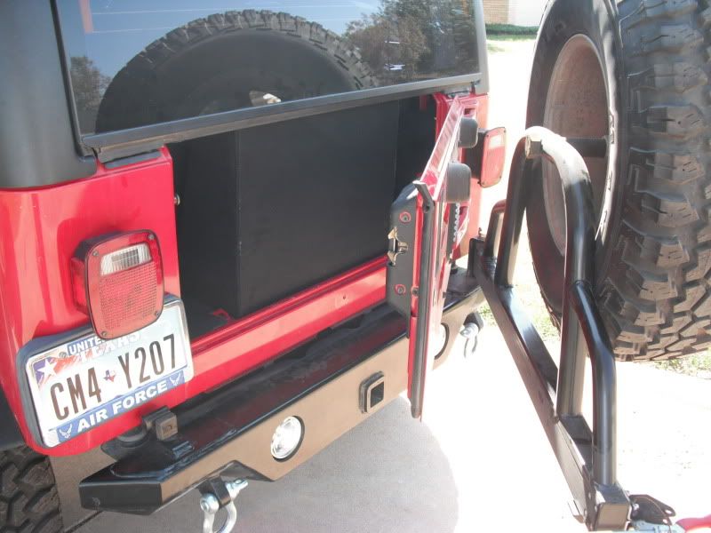

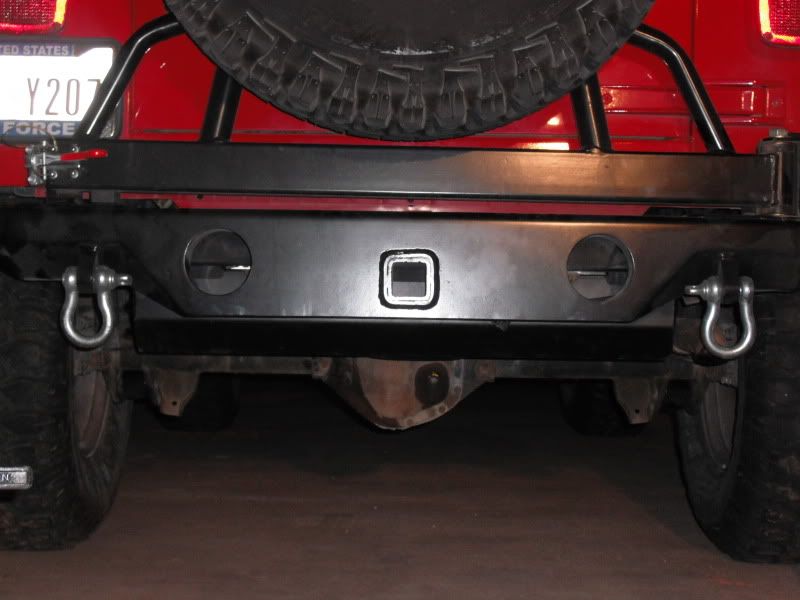

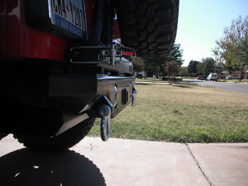

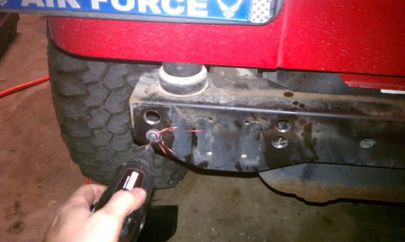

Rear Armor Recovery Tire Carrier
Other
2" shock extensions for 2" more drop
More to come, just pressed for time tonight.

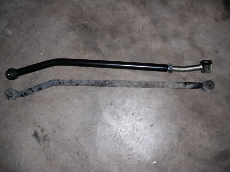

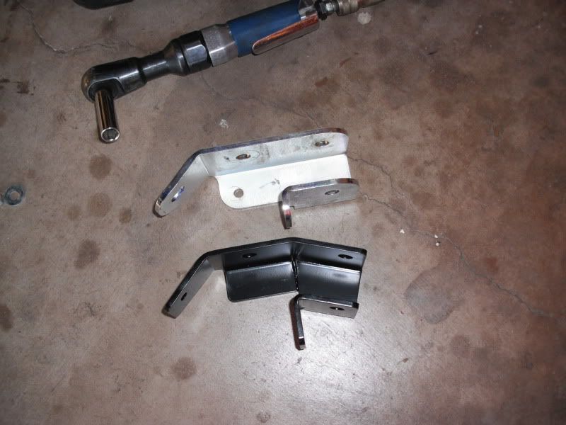

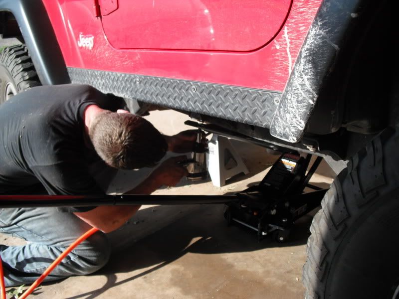

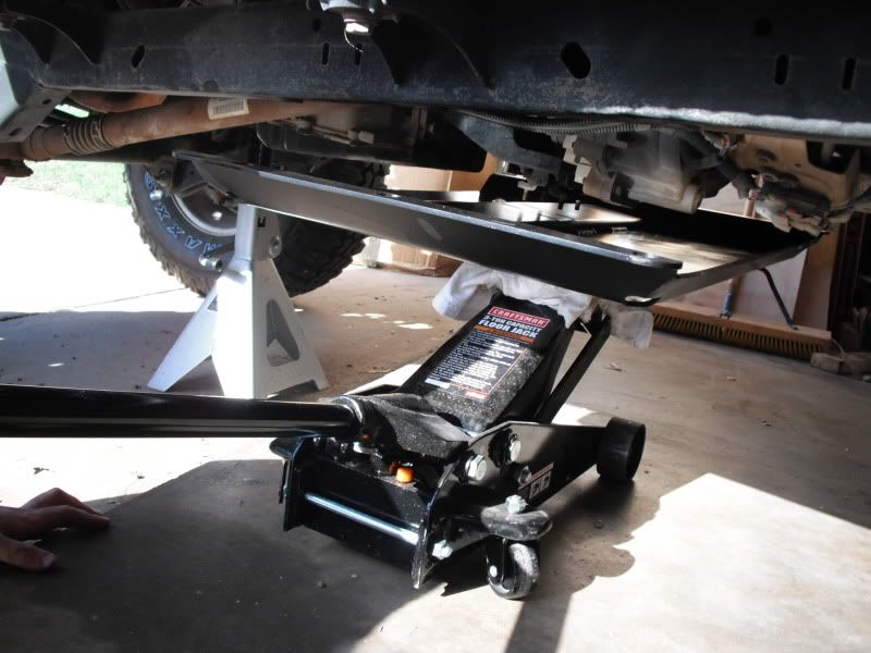

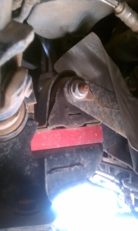

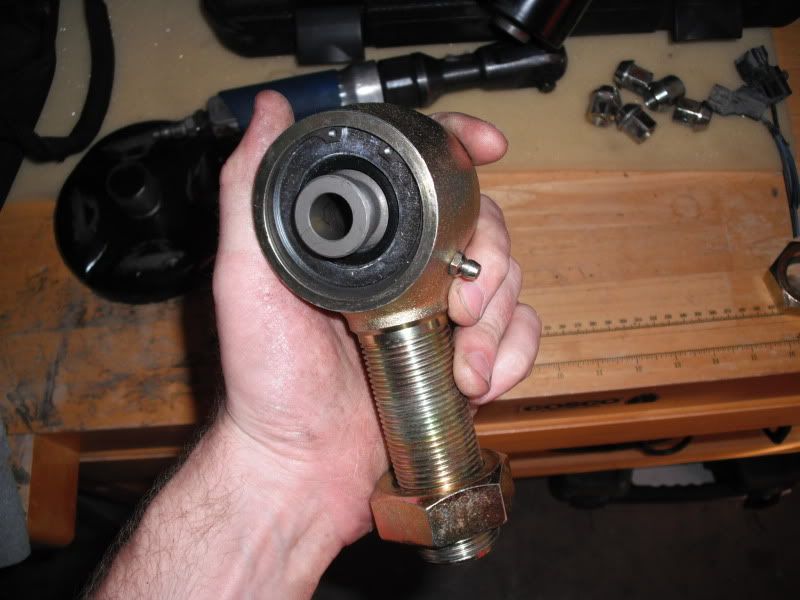

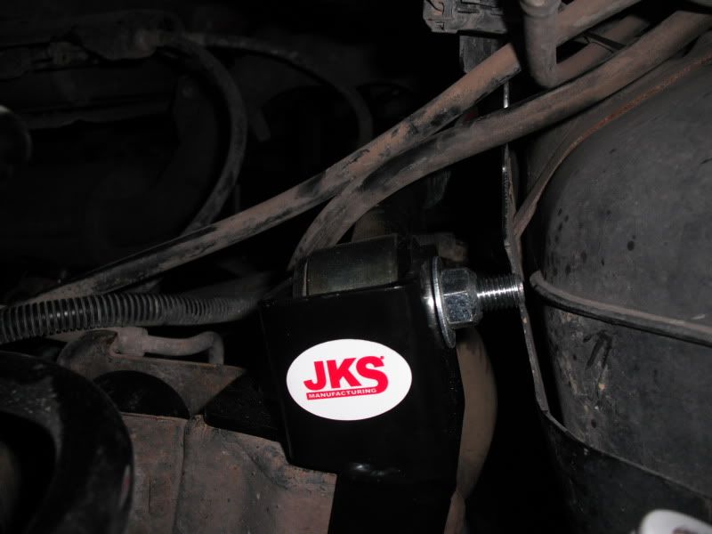

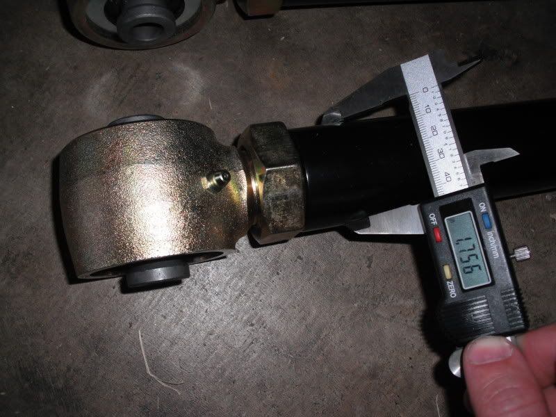

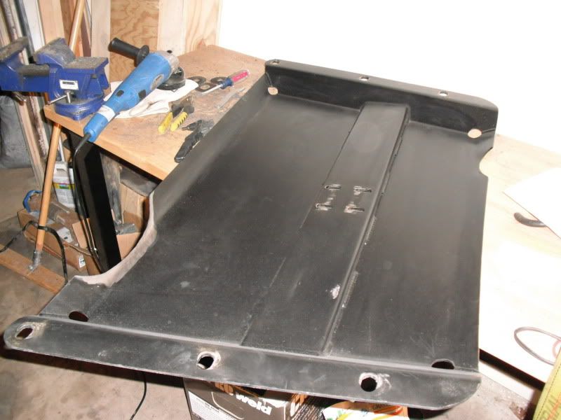

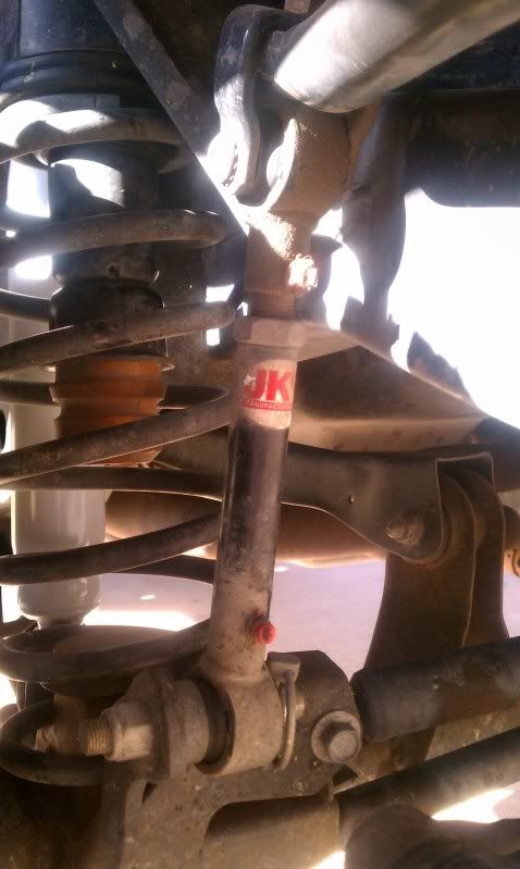

Control Arm Beef
ROKMEN left CURRIE right (uppers)
ROKMEN (lowers) 1.75"!
Tracking Fix
Tummy Tuk
Gas Tank
Drive Shaft 1350 Double Cardan
Tucked the Rubicon air pumps above the driver side frame, isolated with rubber stand-offs
Front Armor Recovery

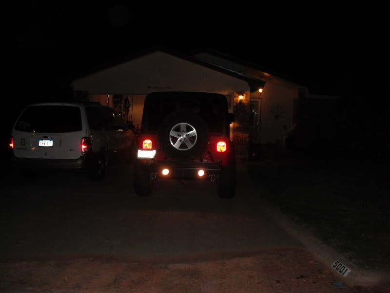

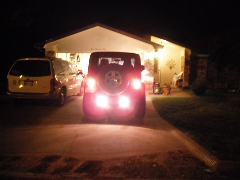

Installed the back up lights on the same fuse as the reverse lights, these lights call for a 15 amp fuse but I have them on the same circuit as the 10 amp and it didnt blow. I dont think the lights are drawing a full 110 watts per set, should be around 10 amps if 10x12=120 watts. Soldered all connections so they dont rust or corrode free.

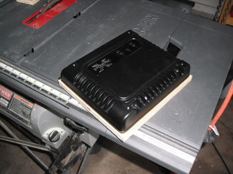

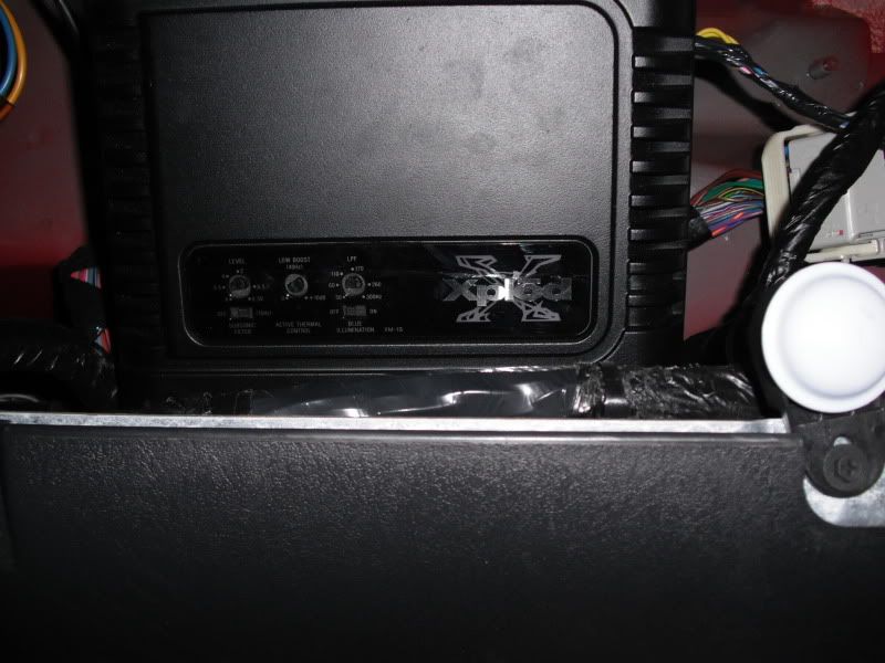

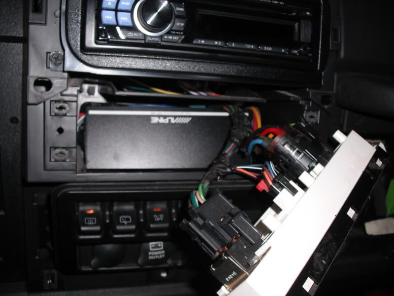

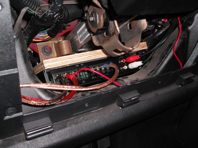

Installed 2 amps in ole Rubi RED. Sony XM-1S and Alpine KTP-445.
Full write up here. http://www.jeepforum.com/forum/f20/i...-pics-1285867/

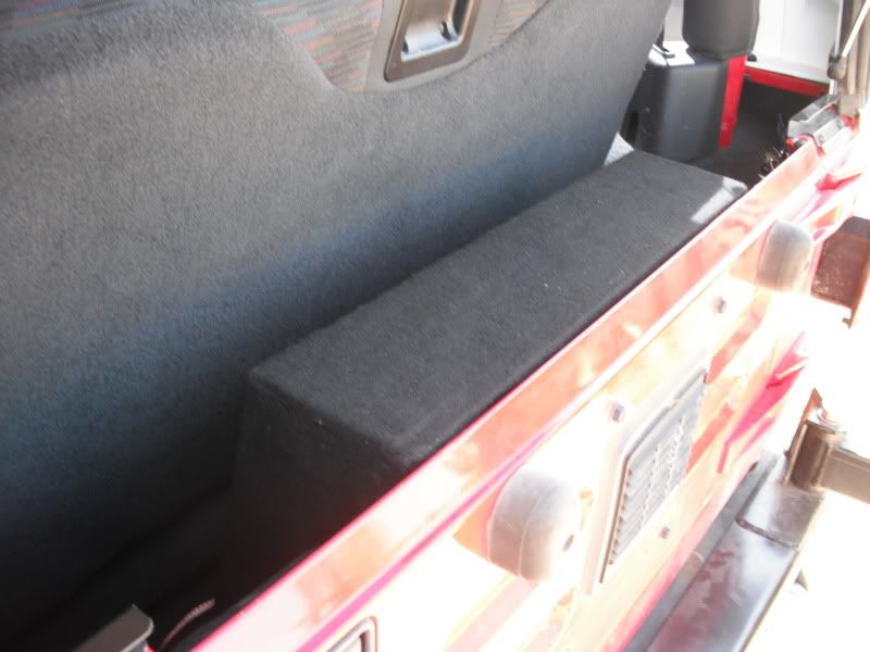

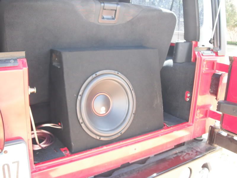

DB Drive k112d4 in a ported .75 cu ft (1 cu ft total with port) ported. Very loud and I got it at a pawn shop for 50 bucks. Just needed to use my pneumatic nailer to fix it up, sealed with new caulk and recarpeted it. Vioala, super cheap and very good quality sound for cheap. It fits perfectly between the baby seat mounts on the back floor and can be removed for extra storage. The amp is out of the way so I can just unhook two wires and take it out for cargo. I figured the air space for 40Hz tuning. It hits hard enough to move my eyes in their sockets. Weird feeling and it doesnt distort with the 500 watts RMS, sub is only rated for 300 RMS. For 50 bucks this sub is incredible.

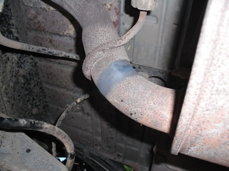

Originally Posted by Rubado View Post
Did you use the UCF low-pro mount for the TT?

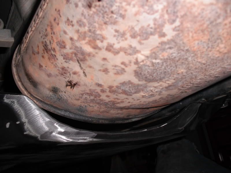

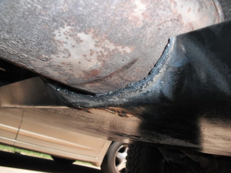

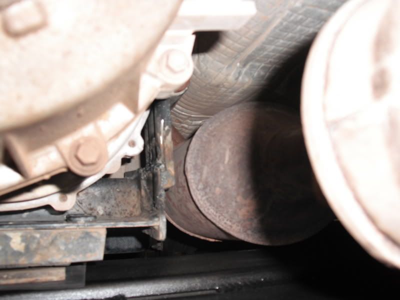

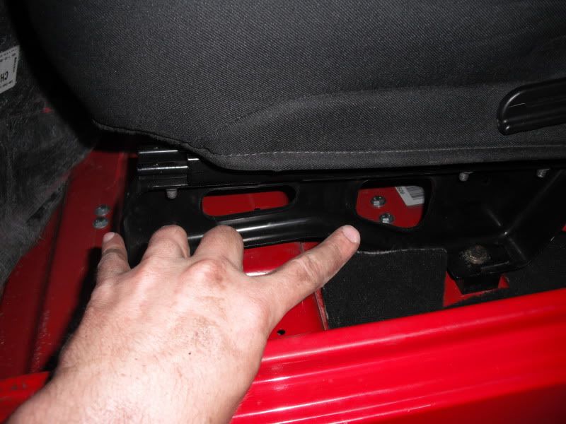

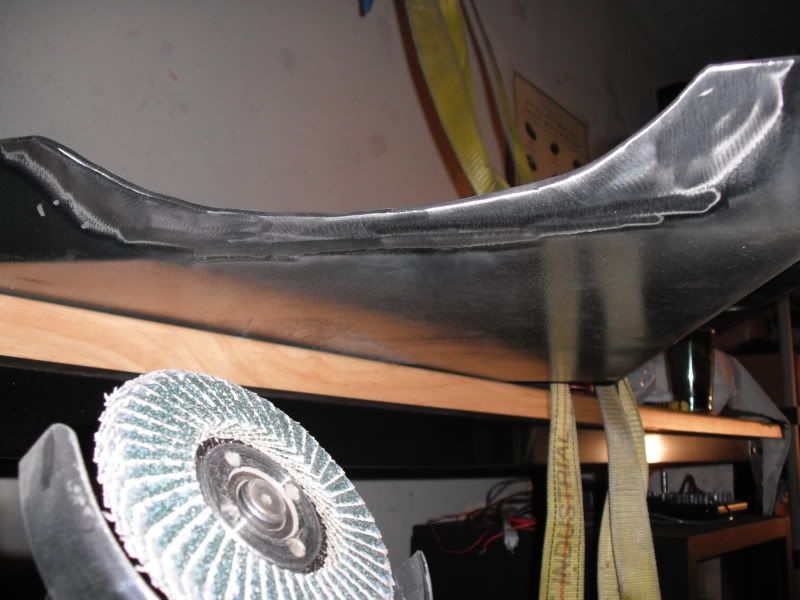

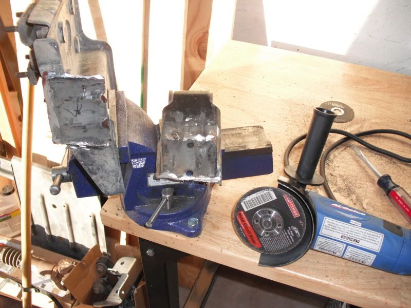

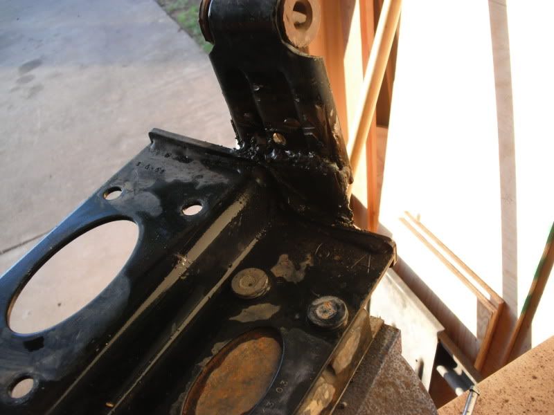

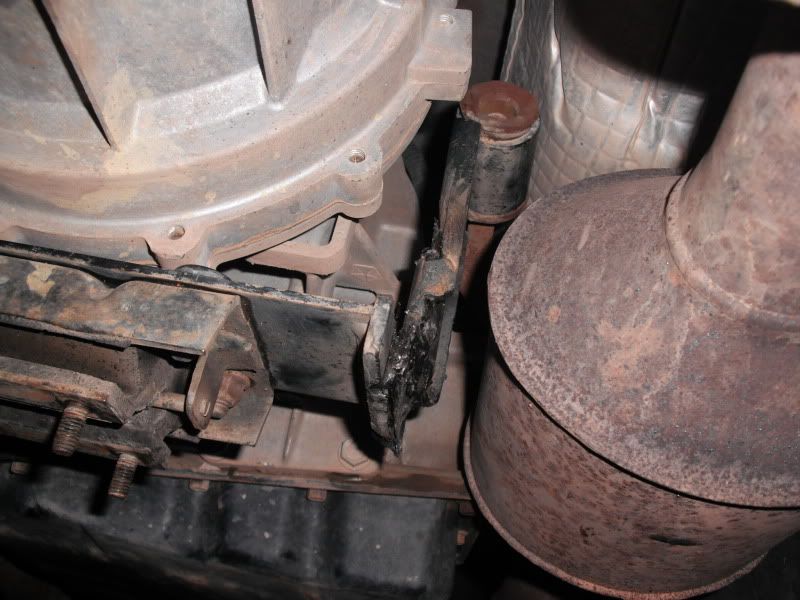

no, in my opinion and experience poly bushings on motor or transmission mounts makes the vehicle shake horibbly especially with a CV double Cardan driveshaft. To keep a nice ride I kept the stock rubber trans mount. I did have to dent the body in one area above the front output on the Tcase, otherwise no issues, I also used an acetilyne torch to modify and heat the exhaust pipe to bring it down to stock location and cut and welded the mount to make the catalytic work on our rigs.
Cut the UCF for my exhuast to fit better
Then heated the pipe with a torch here to bend it down into place.

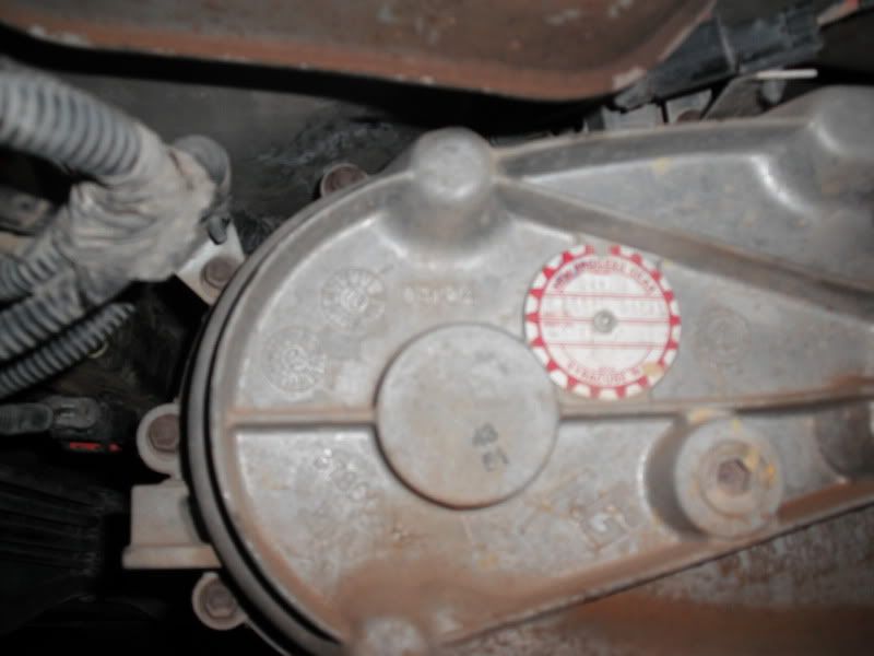

Cut and ground down trans/catalytic mount and moved it down 1 inch.
Cut and smoothed the UCF for my exhaust muffler, things are a bit different in the rubi since the transfer case is a bit bigger.
Here you can see the catalytic sits in its new location with the modified mount and all is well. This took a few days of working on it off and on after work. Be prepared to take the time and make it right. I rewelded this thing twice, once at 2 inch overlap and finally at 1 inch overlap.
Even with a 1 inch body lift and the UCF tummy tuck with the "extra clearance", 2 1/2" skid I still hit the body, you will need to dent the body below the driver seat hidden under a reinforcement panel, it doesnt mess with the cab at all but under the jeep there is a bit of a dent, no biggie, just used a pry bar.
