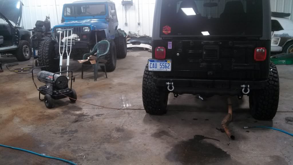

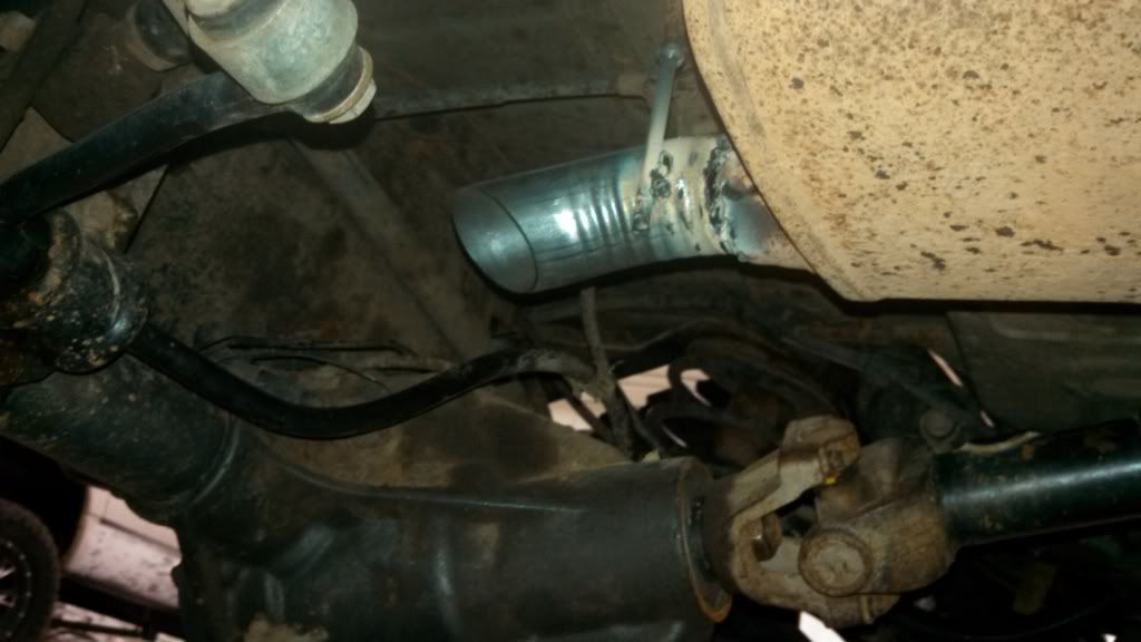

When I installed my Bilsteins, My tailpipe was hitting the shock body. Today I chopped the tailpipe off and welded a downpipe straight to the muffler.

post #772 of 1028 Old 12-20-2013, 11:13 PM
TexasTJ
No Longer DD
TexasTJ's Avatar
Posts: 3,010
Any difference in sound? I may do that if I need clearance for anything. Although I'd turn it side ways so it doesn't blow in the dirt.

post #773 of 1028 Old 12-20-2013, 11:15 PM Thread Starter
Rubicon0311
Location: Kalamazoo
Posts: 3,341
Mine is slightly to the side. There is quite a difference in sound though. I have an aftermarket Magnaflow on mine, so it actually gives it a nice throaty sound. A lot more noise in the cab though. Since it isn't my DD I'm not entirely worried.

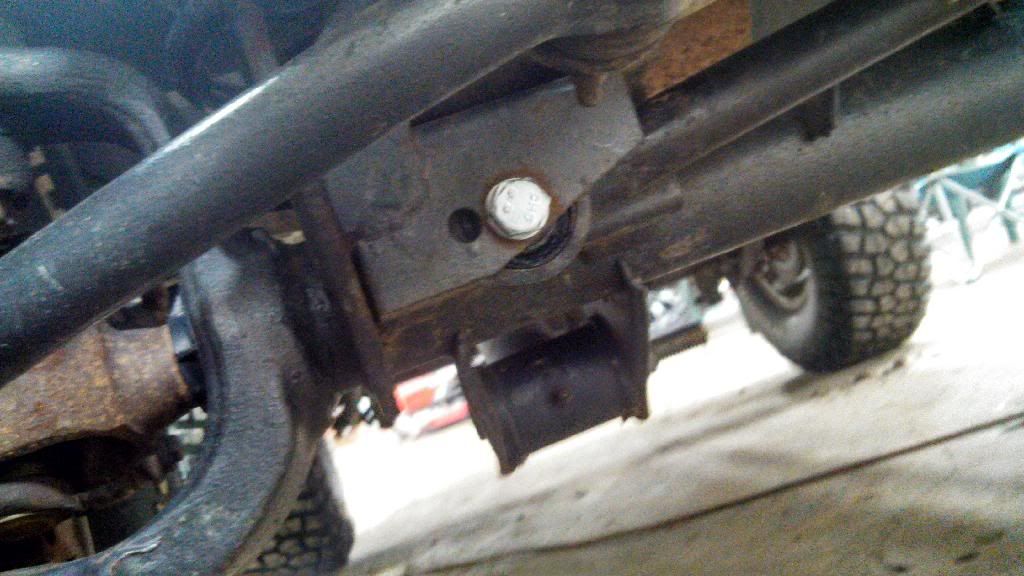

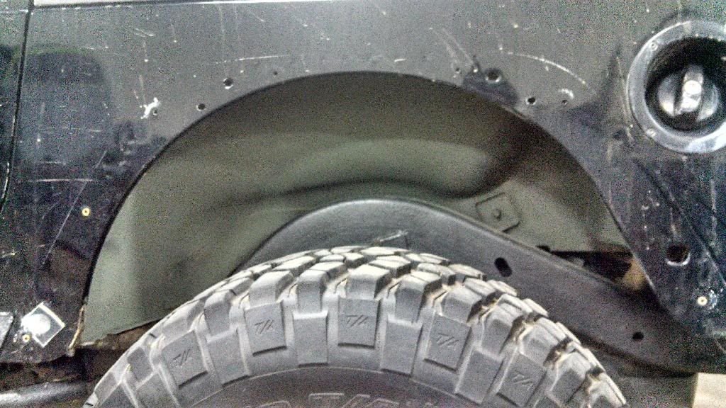

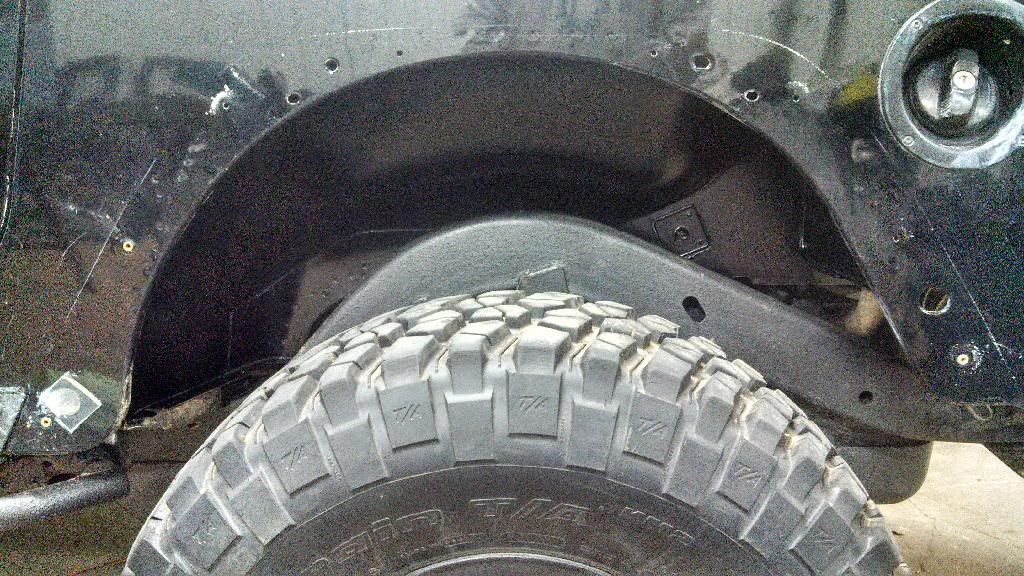

Got some stuff done the past couple days, new track bar bushing, and I tore out the rear inner wheel wells. Nothing was painted behind the wheel wells, so I primed and painted them.
