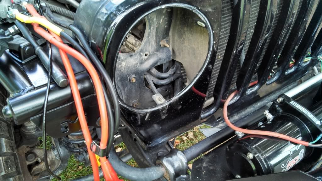

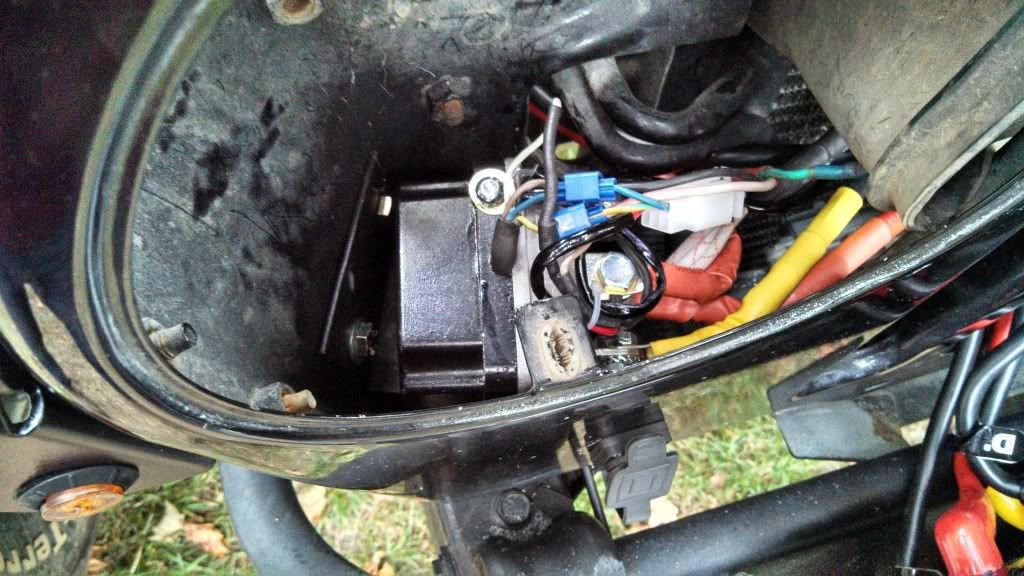

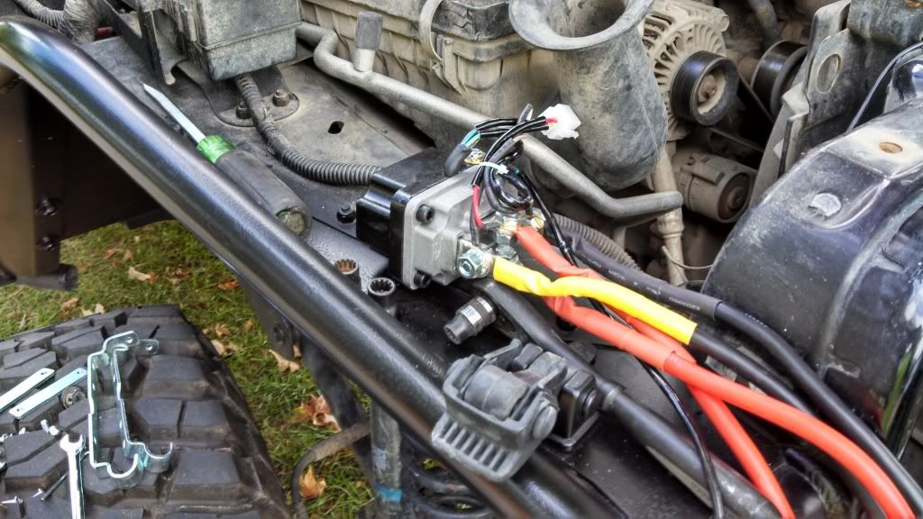

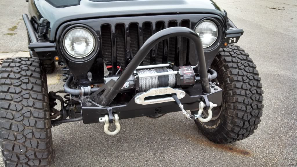

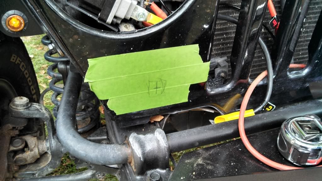

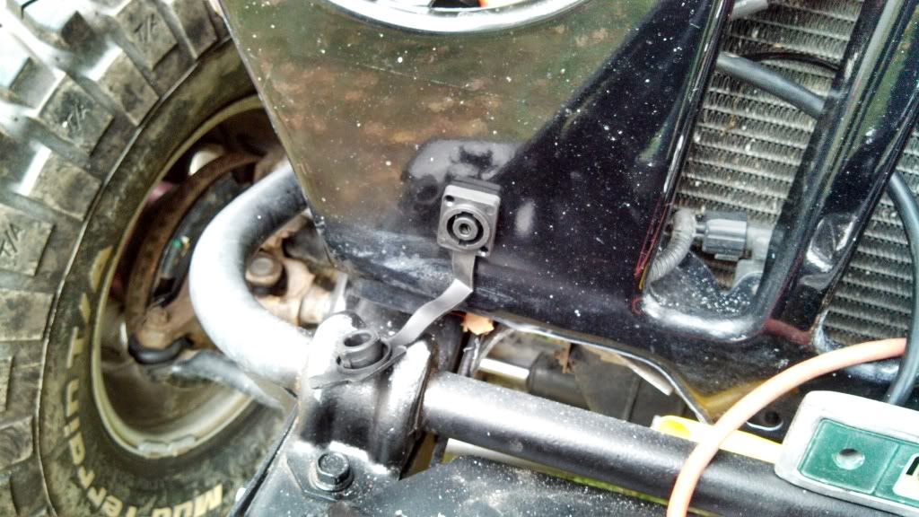

Mounted my new winch today, I decided to relocate the solenoid out of the way. Jake and I found a spot right under the passenger side headlight. We made a custom mounting bracket for the solenoid. I was able to use all the stock wiring for the winch which was great. I then flush mounted the winch controller plug on the front of the grill. It's pretty slick. I still have my in cab winch control, so I'm not too worried about the location of the plug.

You could mount it under the drivers side headlight if you wanted, but you would have to extend the cables. I am not worried too much about the plug location because I have an in cab winch control. I don't need to use the plug.
