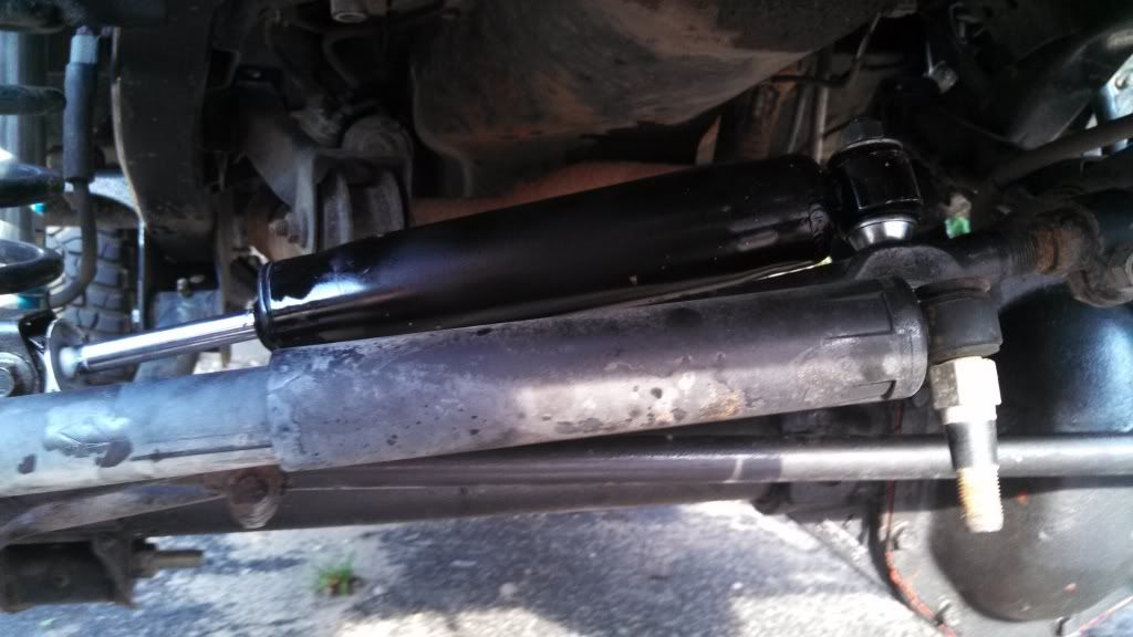

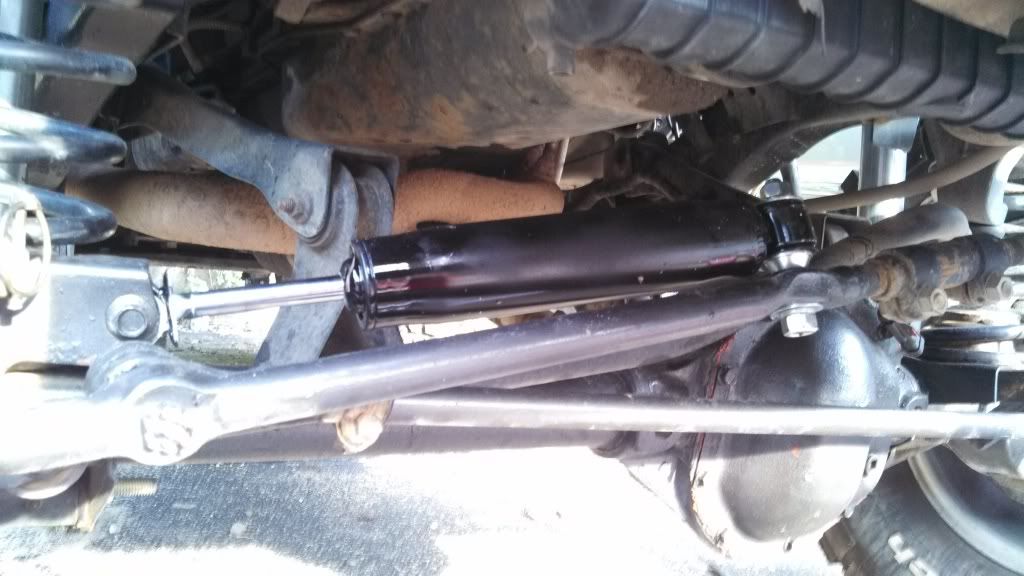

Been dealing with a slight death wobble for awhile now. I had the tires rotated and balanced today, it helped but not completely. I figured that the steering damper was shot since it was still OEM and I am on 35's. So I replaced that today, just a stock Gabrial from work. Much beefier than the old one, Now I need to take it for a spin here shortly to see if that fixed it.
The old one with the new one
Check your ball joints and wheel bearings! Fixed DW on 4 different Jeeps that way.
