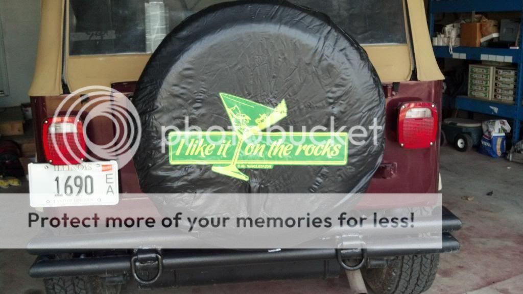

As fluid changes and other basic maintenance items were completed, it was time to start looking at how Trail Ready this old rig was. While inspecting the rear bumper, we realized that the PO had only secured the bumper with 4 bolts, and they were 3/8" grade 5, not 1/2" grade 8!!! Also, there was only 1 support per side.
Off to my buddy the welder, mechanic, extraordinaire for a little reinforcing.
2 c-channels were added to allow all 8 bolt locations to be used
As well as a pair of 15,000 lb rated d-rings
We did find that in 1987, the factory reinforced the corner mount locations for increased rigidity. :-)

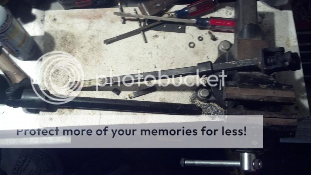

Now for the Oh S*** moment. When the body came down, there was a THUNK/CRACK sound. I had NO clue what had just happened until I walked around front. The steering shaft was frozen solid and did not slip shorter as the body came down. Instead it forced its way straight through the head of the gear box and blew every seal in the steering box. DOH!!!!
Because I'm cheap, and because I don't lose to inanimate objects easily, I decided that I was going to win against the steering shaft. It was coming apart, it was going to get lubricated, and it was going back in the Wrangler!!!
After some work, it finally came apart.
