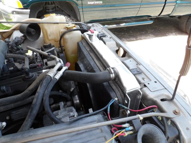

Well I finally got all of my parts in yesterday so today after I got home from work we got to it. Out with the old.
Check that hole out!
Here is the new.
In it goes.
I didn't know where the rubber washers that were included went other than in the mounting of the radiator, so I put them between the radiator and the grill.
Like this.
On the bottom passenger side of the radiator it seems like there is a welded nut missing because when I tried to mount my fan this was the only hole that didn't have a nut. Everything else lined up great though, Drake did a really good job.
This is what we did to finish the fan.
Here is her first drink!
There it is all shiney!
This isn't the end. I have lots of more things I want to do like putting the jeep on a diet with new aluminum armor and some day it's getting a diesel swap. Stay tuned for that.

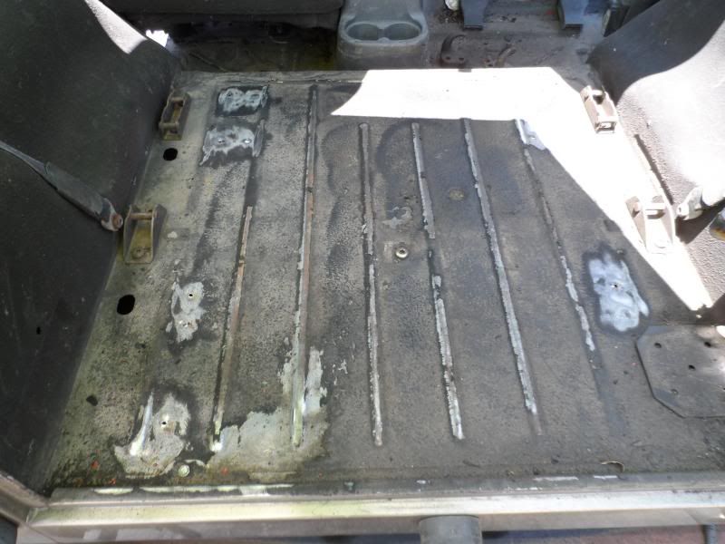

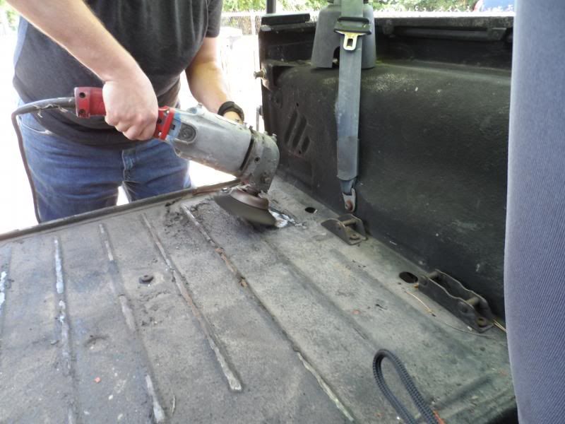

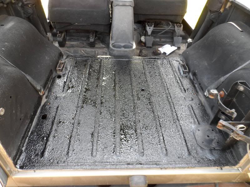

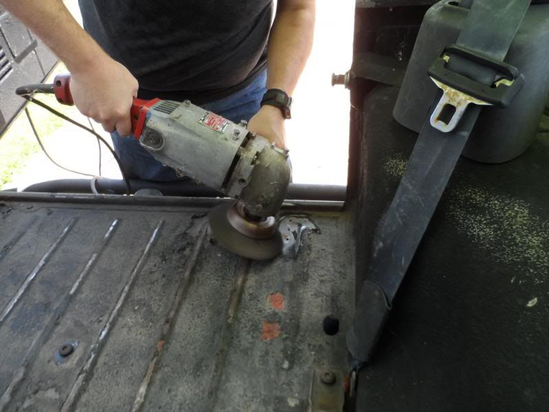

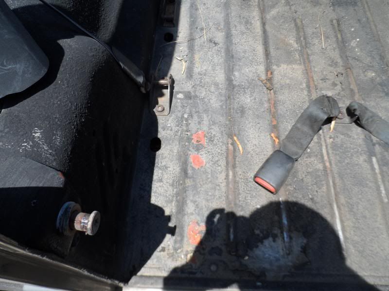

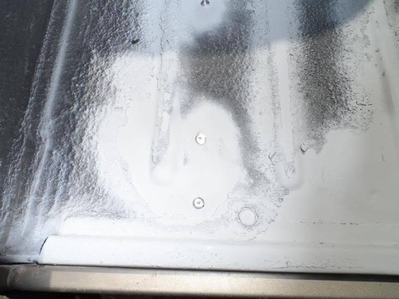

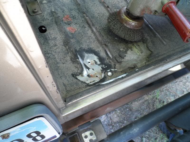

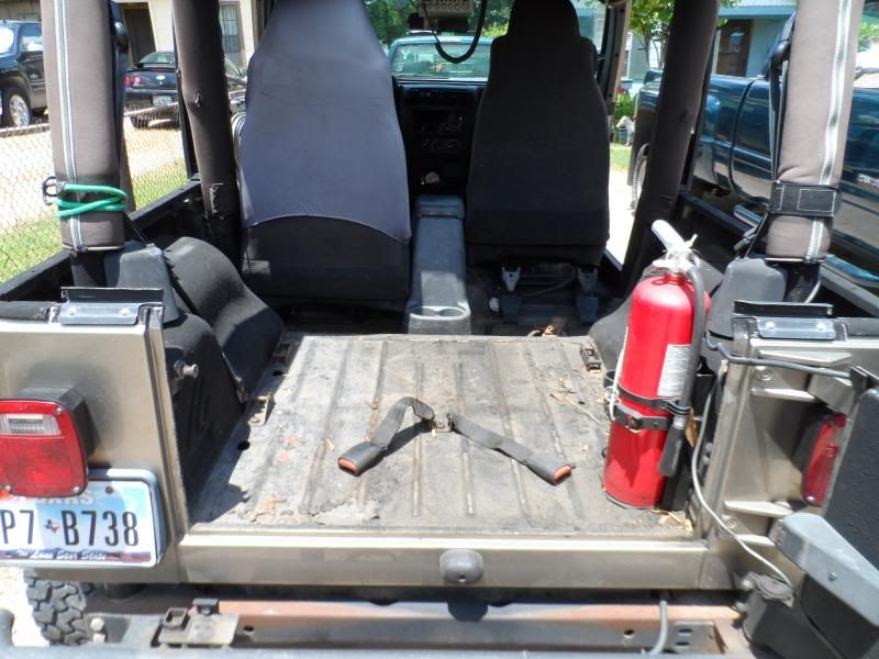

I noticed the back of the jeep was looking a bit rough so I decided to put some more liner down and plug some holes.
I had patched the holes with RTV but that didn't stick to the Hurculiner very well so I decided to patche them with rivets.
So after grinding out all of the holes and loose rubber, I washed the bed really well with a pretty aggressive cleaner.
After that I primed all of the bare metal with grey primer.
Rivets in.
Finally I laid down a fresh coat of Hurculiner. I had just enough left from the first time to redo the bed of the jeep.
