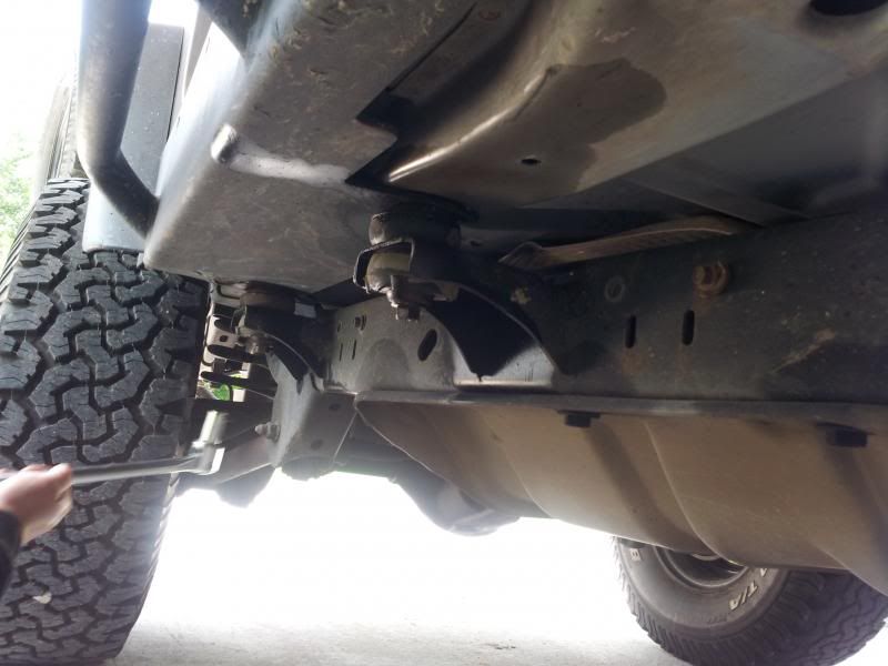

Ok, yesterday I went to Beaumont to work on the jeep with a friend of mine Best4x4. We managed to put in the JKS 1 1/4" body lift and I picked up a new toy at Autozone.
First, the body lift was a whole lot bigger job than we had expected. Every bolt was siezed and bonded to the metal bushings. What should have taken us 45 minutes took 6 hours and trips to ACE and Autozone.
When we put it back together I packed the bolts and bushings with marine grease to keep this from happening again.
What no one seems to tell you when you put a body lift on is that you have to extend the fuel filler line. So we went to Autozone and matched up some rubber radiator hose with similar bends to what I needed. Here is what we came up with.
Dayco part # C71766 $12.99 + Tax
You have to match up the bends you need and cut it to length. The tank end fits really well but the filler end will look a bit loose. It will fit air tight when tightened really well with a hose clamp. I didn't take pictures because it was getting dark.
After that we installed my new toy.
Scan gauge II $159.99 - $20 discount = $139.99 + Tax
It turns out to be a pretty neat tool that tells you a lot about what is going on with your engine.

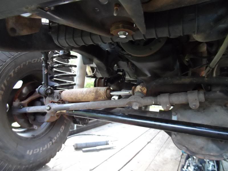

Finally, here is a sneak peek at the new HD tie rod.
I have been rained out today so I'm stuck in the house scheaming what to do next. Hope you guys like the pictures.

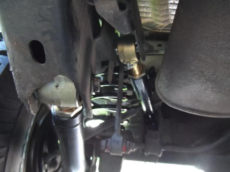

Ok after being rained out 5 days in a row. I have finally gotten to work on the jeep again. First, I traded out the tie rod. The nut on the drive side came with out much trouble.
The draglink end was a bit more reluctant to leave. This didn't work.
This did!
So once that was out, I matched the two rods up to get things close and put the new tie rod in.
The new one is a lot beefier.

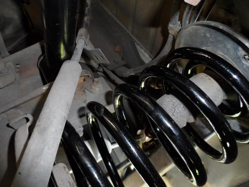

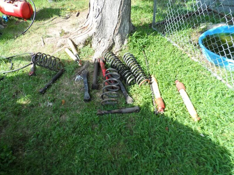

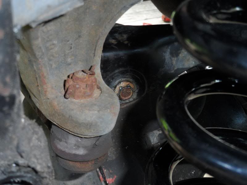

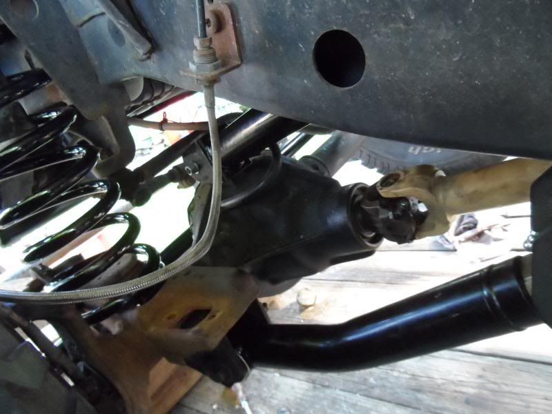

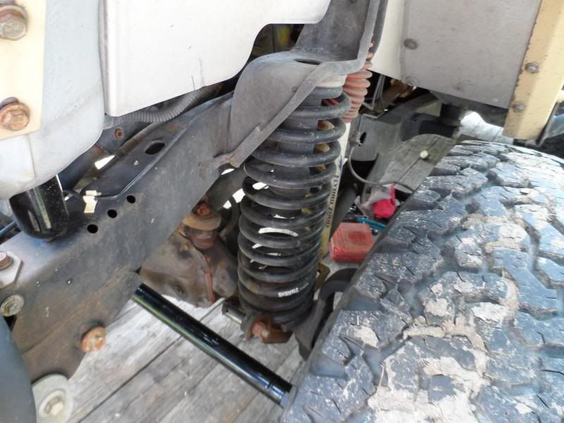

So with that done, we moved on tackeling the front end. We used a floor jack to lift the front end up high enough to get the springs loose.
As with everything else, they fought. The bump stop bolts were rusted pretty good and had to be man handled to get them out. But, eventually the gave up and we got the new springs in.

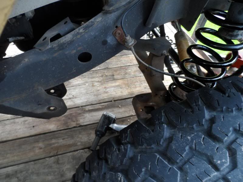

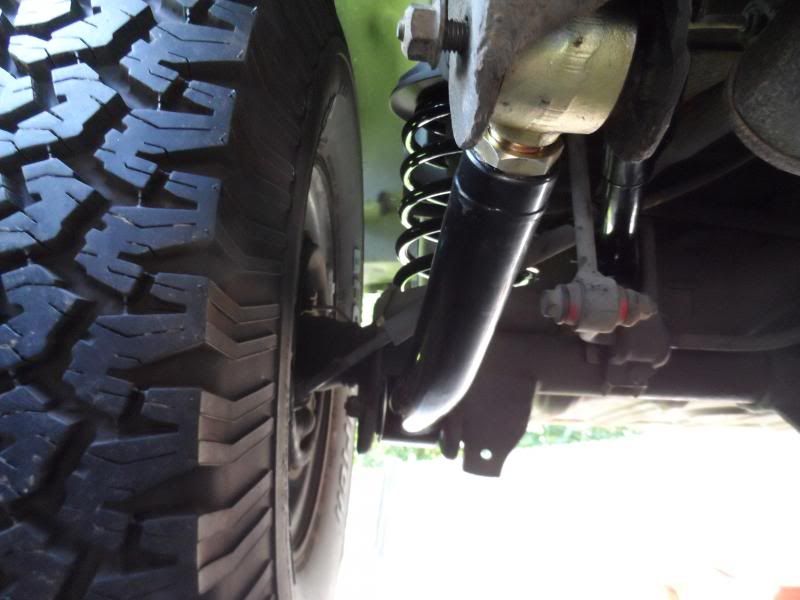

With the springs changed the control arms were next.
And the upper.

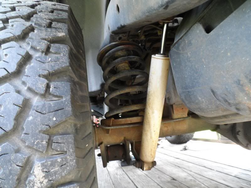

Shocks anyone?

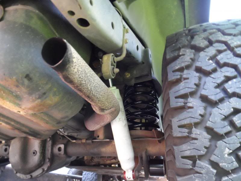

That wrapped it up on the passenger side so we did pretty much the same thing on the driver side.
This bolt on the driver side upper contol arm was a MF! It was frozen really bad but after about an hour we got it out. It was mangled so it had to be replaced.
Another shock.
That was it for today. I'll be back at it tomorrow to do the back. Time for a beer!
