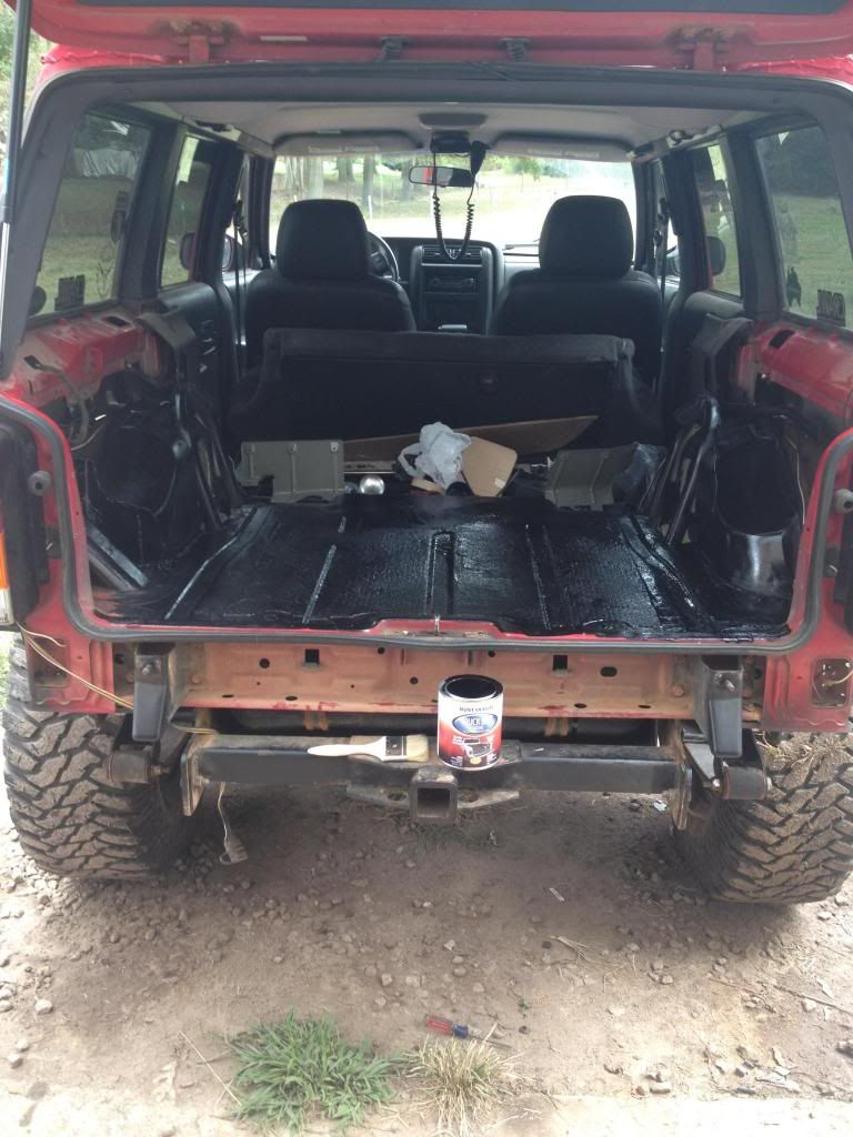

Got the armor templates all made up yesterday and dropped them off at the fab shop.. Unfortunately there is no telling when they'll actually be done... Also got the rear bedlined. Will most likely put a modded form of the carpet back in to help cover up the shock holes. Dropped my rear driveshaft off at Carolina Driveline this morning as well. Hopefully they can just put a longer full spline slip on it to get the extra length.. That will be knocking out 3 birds with one stone. I have been wanting a solid slip on there any way, I need it lengthened and the slip on there now is locked up. But we'll see, they are suppose to be calling me later today on the final verdict..
It should be looking a lot better when I get the interior back together..
