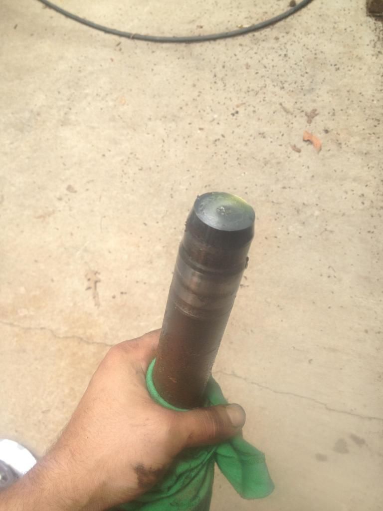

So been a little but since an update. Finally pulled the shaft out of the front. Sheered it right off. Will probably just throw another stock shaft in but have been looking at chromos so we'll see what money allows and when. Still need to fix the brakes. Going to do a 3500 master cylinder swap and that should get my pedal a little harder. Also since my brother has to drive it while he's back in town I picked up some 17s. Still waiting on the forth.. Oh yeah and they came with 40s lol I'll probably throw them on for a photo or 2 but then will be breaking them down to put my old 35" ATs on so it will be a little better on the road. Other then that probably not going to do too much to the Jeep for a little while. Need to recoup a little plus gonna get some work done to the truck.

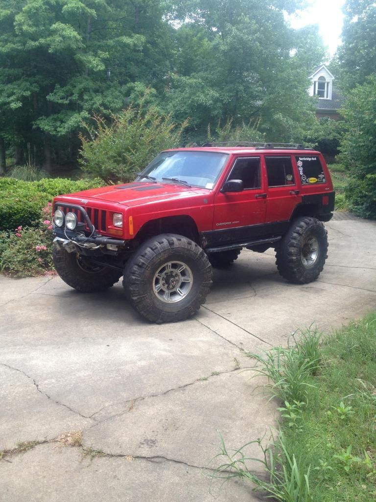

I use to not like those h2 wheels, but the more I see them the more they grow on me.
What's the backspacing and width on them?
Yeah I like them. May end up keeping them for good. Figuring it is about lighter with a 40 then mine are with 37s. Just will need to find some 37s that will fit on them. As for back spacing from what I've read they are 5 5/8" backspacing

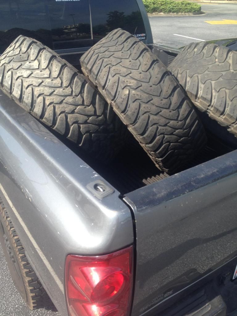

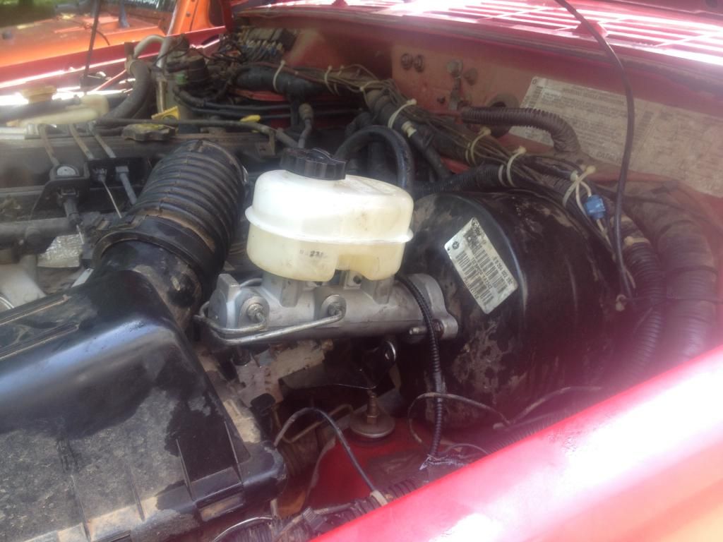

Did the Dodge 3500 Master Cylinder swap today. Didn't take long at all. Other then making a longer push rod and bending some lines bolted right up. I do think I made my new push rod a little short. bought a 1/4x28 2" bolt, cut the head off and rounded it down. Will probably make another a little bit longer. The pedal is hard but is lower then It should be. I think a longer push rod will bring it up a little. I'll also probably make some new lines to the proportioning valve to make it look a little better. The reservoir fits but is really tight. Will see if I can use my old reservoir that is angled for the hood for a better fitment. So far so good. She stops a lot better now so I'm happy.
2014 Cherokee Of The YEAR
Rockdrummer93 is offline
post #930 of 1079 Old 06-08-2014, 01:52 PM Thread Starter
Rockdrummer93
Location: Taylors
Posts: 1,694
So got the new master cylinder worked out.. Works great! Still need to try to figure out a bigger booster now. Might try a ZJ booster with front and rear discs. I've read where they push a little more booster for the rear discs. Bought another set of tires. Set of 35" Toyos I'm going to put on the H2s for a little while. Going to sell the 37s for now. They are just too heavy for my set up. I'll wheel the 35s for a little while till I can afford a set of lighter 37s. Plus that way I should be able to beat on it like a use to without worry. Through the H2s and 40s on yesterday for a local Jeep Cruise in. I love the way they look lol might have to eventually big it to handle them haha the rear end is a little too narrow for them but whatever. Going to have the 35s put on this week. Need to start saving a little more for a trailer and cage later on. So will probably be holding off on the Jeep for a little while but never know lol may come across a sweet deal. We'll see.
