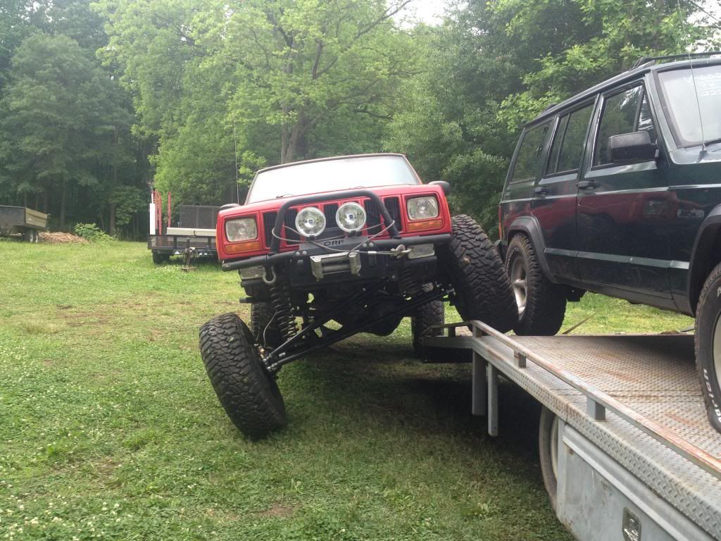

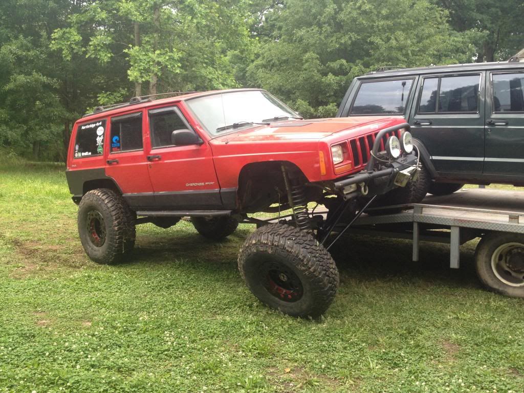

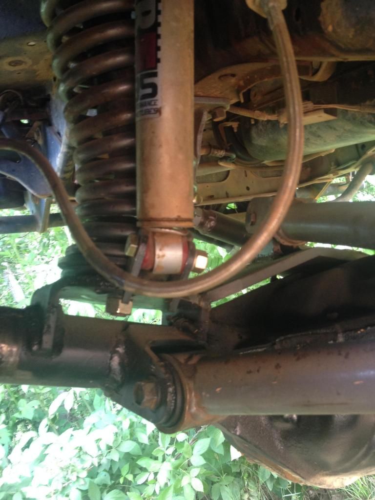

Stretched her legs today. AND.... we have a problem. The driver side upper hits the driveshaft at flex. Gonna have to cut it off and move it over a bit.. Kinda pissed off about it but whataya gonna do you know? Also got her out on the street and finally got her home. Drove alright, not as good as it use to but i still have some work to do with it to have it perfect.

No stress man it will take some tweaking. That's why I got a 4 link cross member to run a three link. I'm going to start with just a upper on the pass side.
Project1 is offline
post #904 of 1075 Old 05-19-2014, 07:38 PM
Project1
Location: Florida
Posts: 2,716
Ya know .. You could very easily ditch the radius arm and just add one link and have a three link. You got great fabs skills. You could do it in one afternoon for like 100$

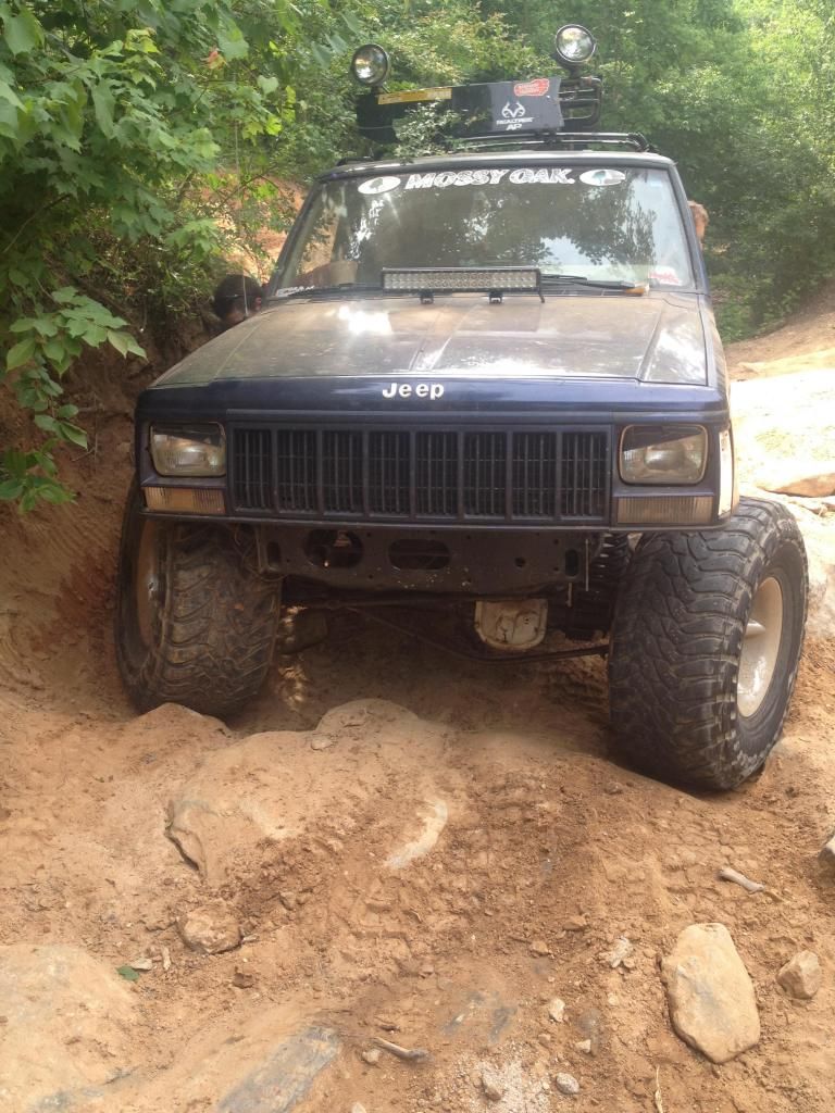

Alright so just got back from Gulches today.. Well my trip was cut a little short. Drove it out there and started to ride some trails. Did a few decent ones then went to the TnT Rock garden to try the left side. Well without a spotter rode up and gave it my all in a bad line and blew something. Still not sure what is but what ever it is the front drive wheel doesn't pull at all. Its either a shaft or the detroit. Gonna pull it apart here soon and figure out what it is. Well since I had 3 wheel drive I kept on with my day. Till a trail later I ripped a sidewall in my passenger front tire. Without a spare limped it to the parking lot. A buddy of mine had a balled 38" that he let me barrow. Kept wheeling a little but nothing too too difficult after that. Great thing is it made it home!! My brother is going to be driving it for a little while since he's come back into town and doesn't have a car so going to pick up some 17s from a friend of mine and put my old 35s off my truck on them so it can drive a little better while he's driving it and give me some time to find another tire/s. Also need to work out some longer bump stops front and rear. Maxing out the shocks which is no good. Over all was a fun trip and learned a lot about the new set up. I'm not aggravated at all about it, I mean this was a test run trip.
Buddy of mine realizing the strength of the factory steering and 35s lol
