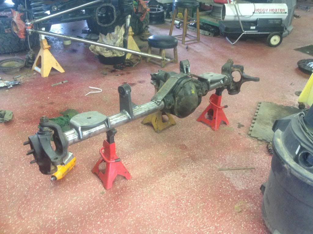

Alright well not much has been going on. Did finish up the HP44 today. Other then the track bar bracket all the welding has been finished. Also through my preload shims on the carrier, pressed the new bearing on and got the carrier in for the last time. Will probably get the axle under the Jeep for the last time tomorrow. Im going to wait till I get everything finished to do the track bar. Because my TnT frame side track bar mount is too far offset Im going to get everything set up and then work that out. May have to buy a new frame mount or if I have the money may just order some front frame stiffeners and do a weld on mount. Still not sure.

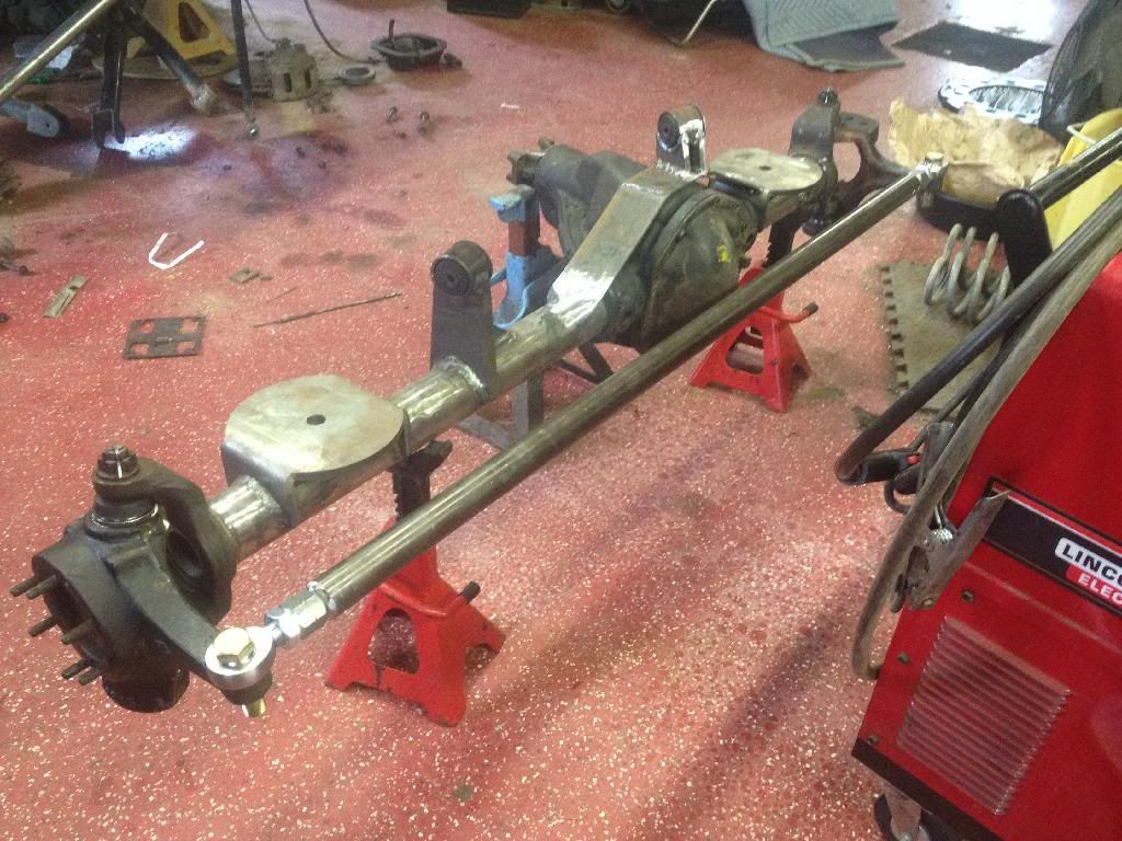

Yeah no prob! Its JCR's 1 ton over knuckle set up. Simple to install just can be a pain and can take some time. The knuckles were the easiest to drill and ream. The pitman arm was another story, Drilling and reaming that was probably the hardest part of the install.. Just took a lot of time and ate up an $80 reamer. You will need a over axle track bar set up to make it complete, too keep your angles right. I went with TnT Offroad's track bar system. It was the easiest to get ahold of. Did have to re drill the frame mount to move the track bar up a little bit to get my angle pretty much parallel with the drag link. I also had to extend my steering stops and trim some of the factory axle brackets to clean the bigger linkages. Thats about the only disadvantage to the set up is a lack of turning radius.

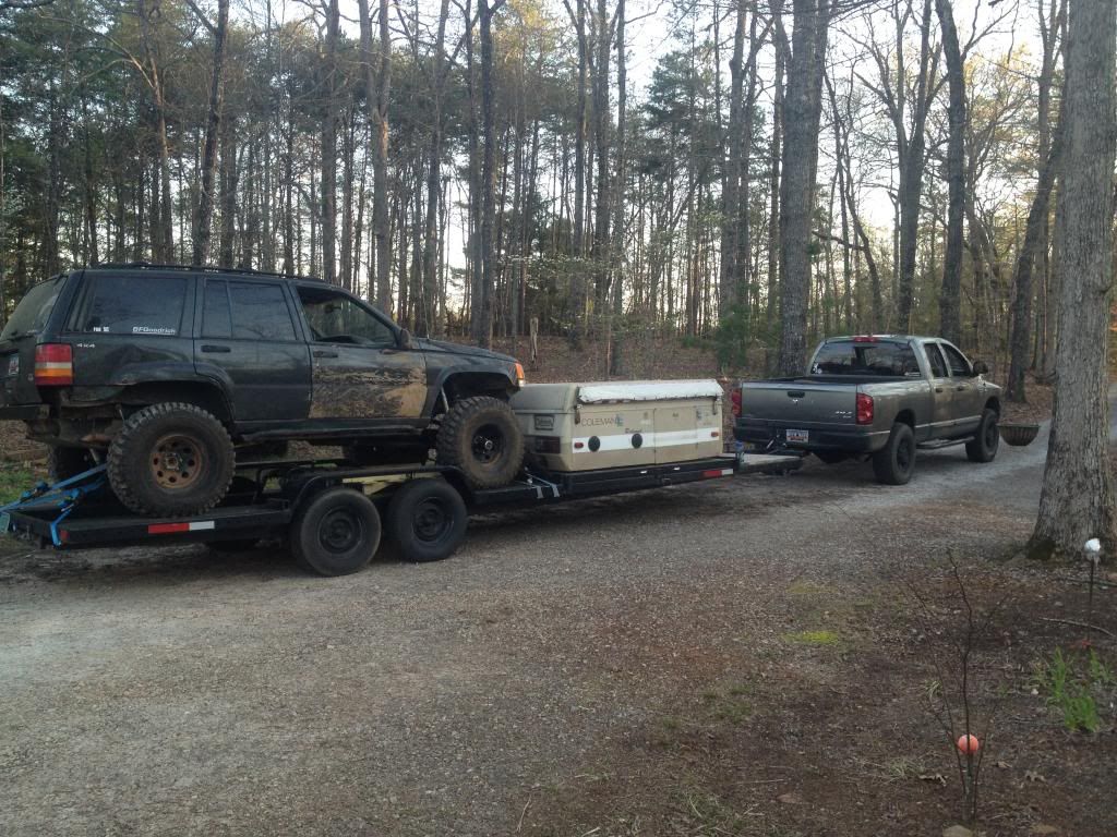

Just got back from Harlan. really glad I didn't rush and take my Jeep. It wouldn't have made it up some of the trails out there. But I am glad I went to get a look at it so I can prepare the Jeep for it. Towed my buddy's 5.9L ZJ up there. The Truck towed great but the transmission I don't think made it. Barely got it home and now even with no load 2nd gear slips pretty bad. So will be taking it to a tranny shop tomorrow to see what my options are. Need to get the Jeep done even more now so I have something else to drive. We'll see what happens and will keep y'all updated.

Got my tie rod fabbed up last weekend. Will try and get the drag link done this weekend. May even get the hubs and tires on and it sitting on it's own weight for once in a few months.. Will see what happens.
