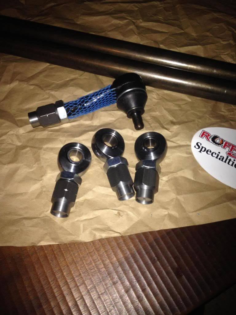

Got 2 of the wheels mounted today.. In attempt to mounting the other 2 I broke three studs so will be pulling those 3 from my factory H1 rims. Held up the track bar mount to see if it would actually work... Well it will but not with my upper mount. SOOO because I can't afford another one right now or before Harlan I will be cutting and re welding my upper mount to work. This will be just a temporary fix till I get some more time to install some front frame stiffeners and a fully weld on bracket. The frame side TB mount I have now from TnT is too offset forward and will cause the TB to bind under articulation. Should be getting that done along with most of the rear axle stuff. Steering came in this evening.. Was on my doorstep as I pulled up from work. Big shout out to Ruffstuff for changing up the kit I ordered for me. Since I already had 1-ton steering and by all means did NOT want to re drill the pitman arm they were able to swap a heim for a drag link end so that it will work with my pitman arm.
