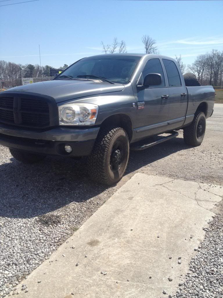

A picture of the new rear brackets. Also on a non Jeep related side note. Got some new tires for the truck. Got a pretty good deal on them plus really needed tires especially since Im going to be towing up to Harlan.

Haha over at Southeastern Freight Lines lol but for the tires I had to barrow that money from my grandparents.. The tires on the truck were pretty much bald, dry rot all over and a nail in one... A buddy of mine had this set pretty much new and I couldn't pass it up and he couldn't wait for me to get the money.
