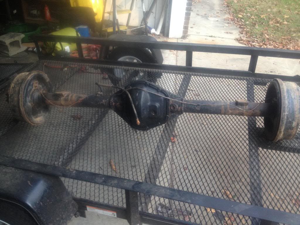

Well found a deal I couldn't pass up today. Really didn't want to buy it but would have beat myself up if I didn't. Dana 60 out of a 73 Dodge w200, 4.88s and Lockrite. I plan on having it converted to semi float and cut down to 65" wms to match the HP44. Probably won't touch it till the spring when Im more ready to take on another axle swap..

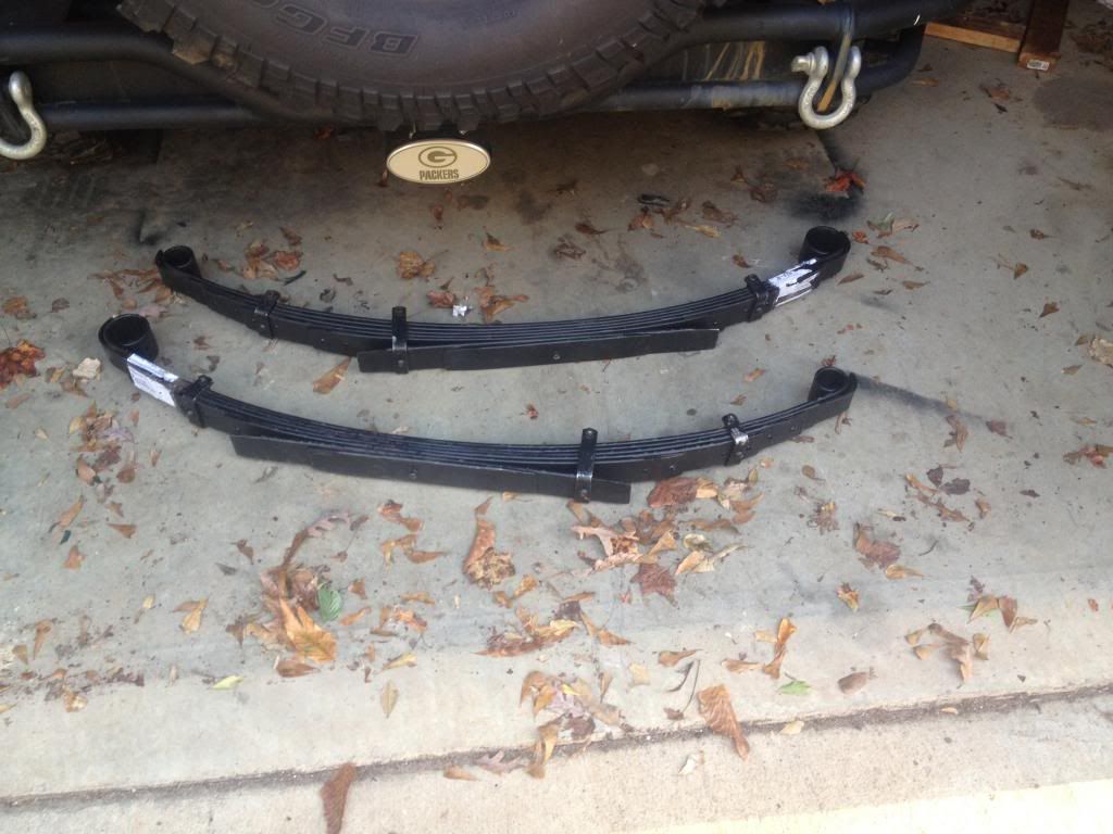

Ordered my new springs today.. Should have them by the end of the week and on soon after that. Should be sitting around 5.5-5.75" of lift which is where I've wanted it since the beginning. Was over at the foothills and now have a new decision to make. I measured my 60 today and it measures out to around 65" WMS so it already matches my HP44. I can either convert the HP44 to 8 lug or convert the 60 to 5 lug. Converting the 44 to 8 lug will be the cheaper option since the 60 is already geared and locked. I'm just not sure I want 8 lug. If I convert the 60 to 5 lug I'd be using f150 8.8 rear brakes so would have a factory like working parking brake and discs.. I don't know still have a lot of thinking and saving todo. What do y'all think would be the better option?

New springs came yesterday.. Need to get a bushing kit. Should have them on this weekend! Still debating if I even mess with the front or not. Will see how it sits when I replace the springs and go from there.

I'm not too worried about the wheels right now.. I can easily find a set on Craigslist and was planning on going to 17s anyway with 37s. The only problem is if I go 8 lug I'll have to get a set of tires aswell because it will be hard finding a set of 8 lug 15s to use my tires.. I'm most likely going to see what kind of money I have to work with when I do the swap.. I mean it most likely will cost about the same regardless because the money it will take to semi float the 60 and run 5 lug will probably cost the same to find a set of 8 lug wheels and 35s or 37s on Craigslist.

Got the springs on today. They sit a little higher then I had hoped. Sits about the same as the old springs. Hope they will settle out some. Haven't really drove it around to really get a feel for them yet.
