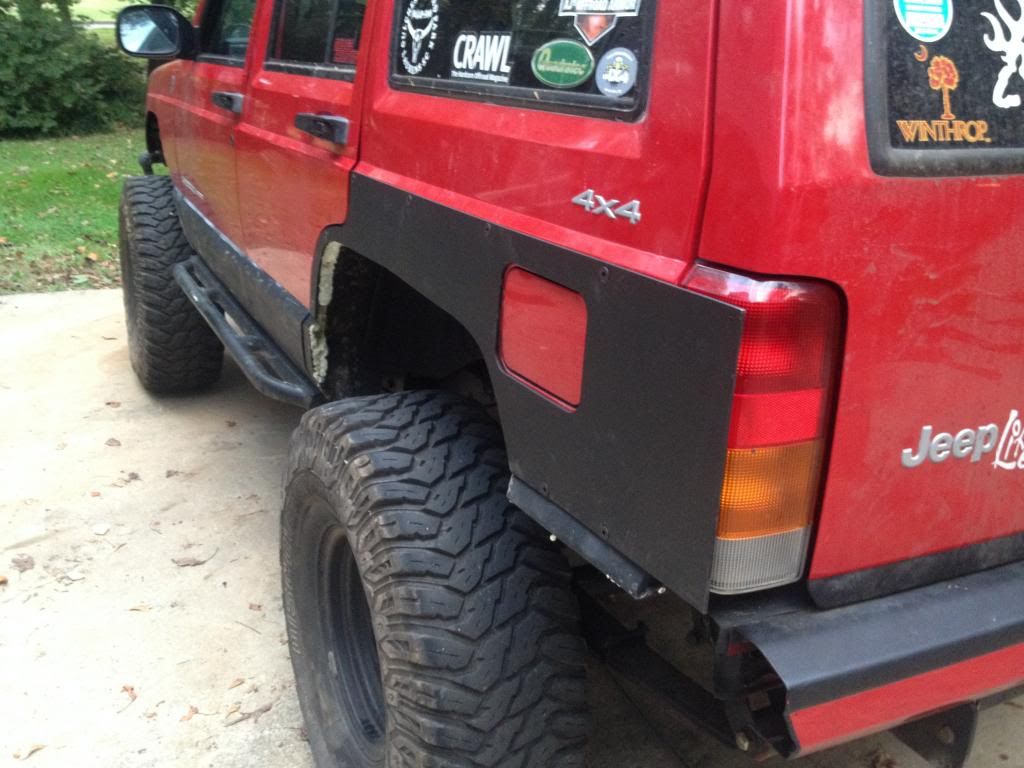

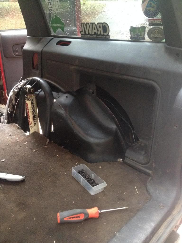

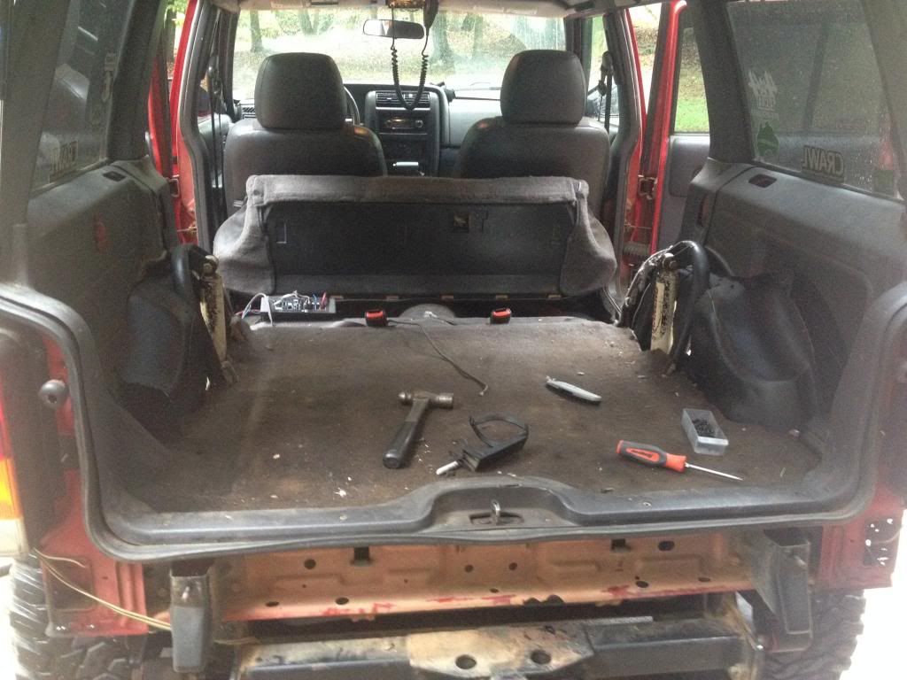

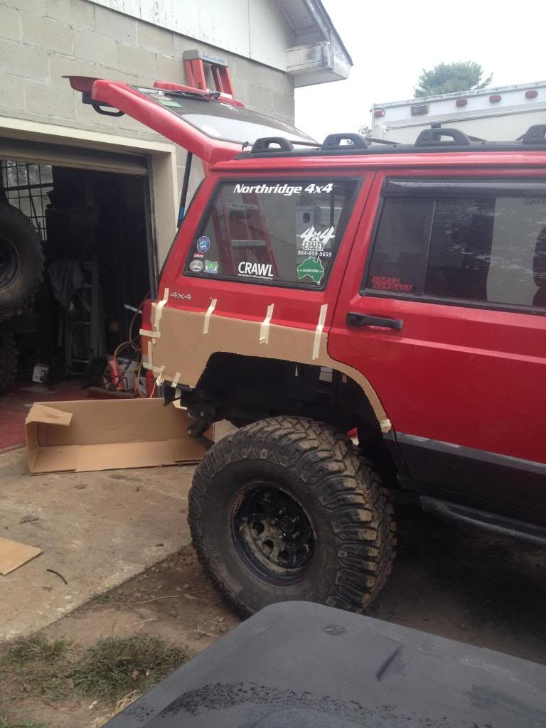

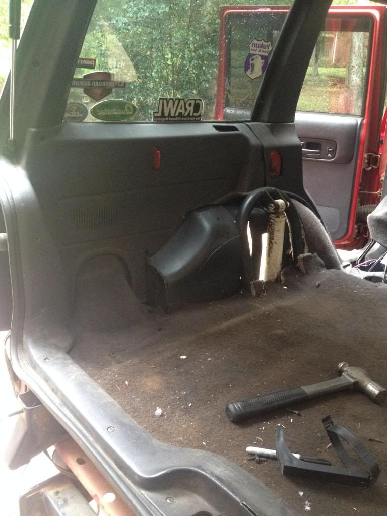

Got the armor templates all made up yesterday and dropped them off at the fab shop.. Unfortunately there is no telling when they'll actually be done... Also got the rear bedlined. Will most likely put a modded form of the carpet back in to help cover up the shock holes. Dropped my rear driveshaft off at Carolina Driveline this morning as well. Hopefully they can just put a longer full spline slip on it to get the extra length.. That will be knocking out 3 birds with one stone. I have been wanting a solid slip on there any way, I need it lengthened and the slip on there now is locked up. But we'll see, they are suppose to be calling me later today on the final verdict..
It should be looking a lot better when I get the interior back together..
Looks good, but couldn't you have just got some plate and cut it yourself?

I could have but the place I was going to get my steel from didn't have what I needed and wasn't going to have it for a few weeks and the place I'm having it done is cutting them with their CNC so the edges will be a lot cleaner

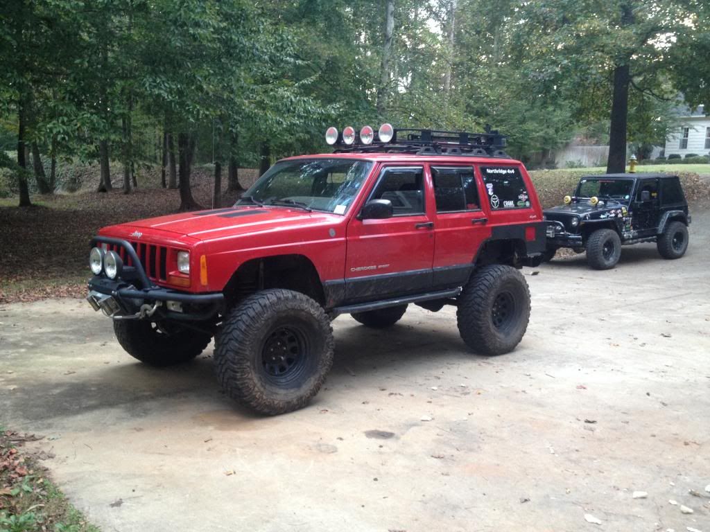

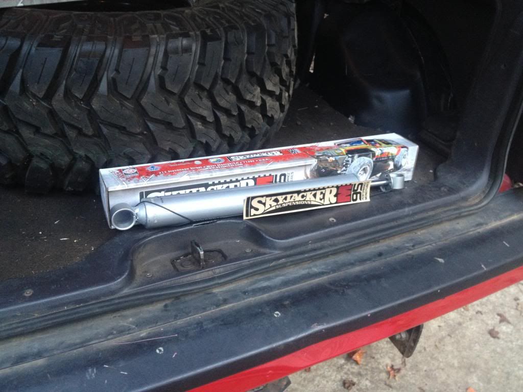

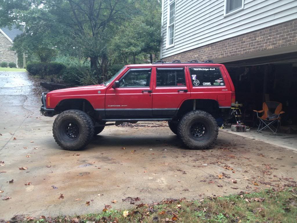

Got the driveshaft back today. Luckily enough for me they were able to get the length I needed out of just installing a longer full spline slip. Got it installed and and put in some old Ranchos that came off an F250 to get it home. The bushings in those shocks are shot but other then that it did pretty well.. Took it and tried to flex it out to get some proper shock lengths but couldn't stuff the rear wheel any higher.. Got some measurements and ordered some that will work. Also got some of the interior back in. Looks a lot cleaner on the inside just need the armor to clean up the outside.

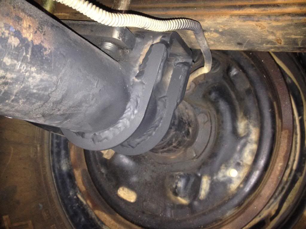

Ok so its been a little while since I've updated last. Been waiting on the fab shop to get my armor done. I went and dropped the XJ off yesterday to get the shock hoops braced and to get my old shock mounts cut off. Went back today to check up on it and the brace was done and they had just started cutting my armor. They also were able to cut some axle straps for my new leaf pads. To act as a u-bolts and help stiffen up the leaf brackets on the axle tube. My shocks also came in too. So will be putting in a full days work tomorrow after classes. Try and get everything done before thursday night. Going down to Durhamtown friday!

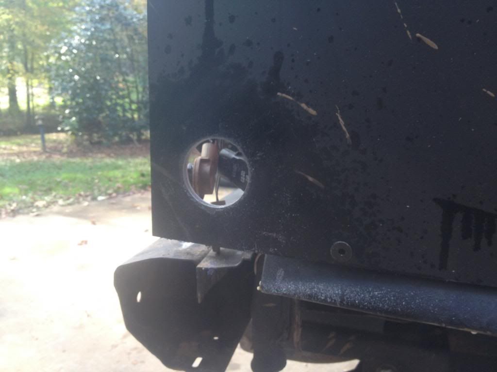

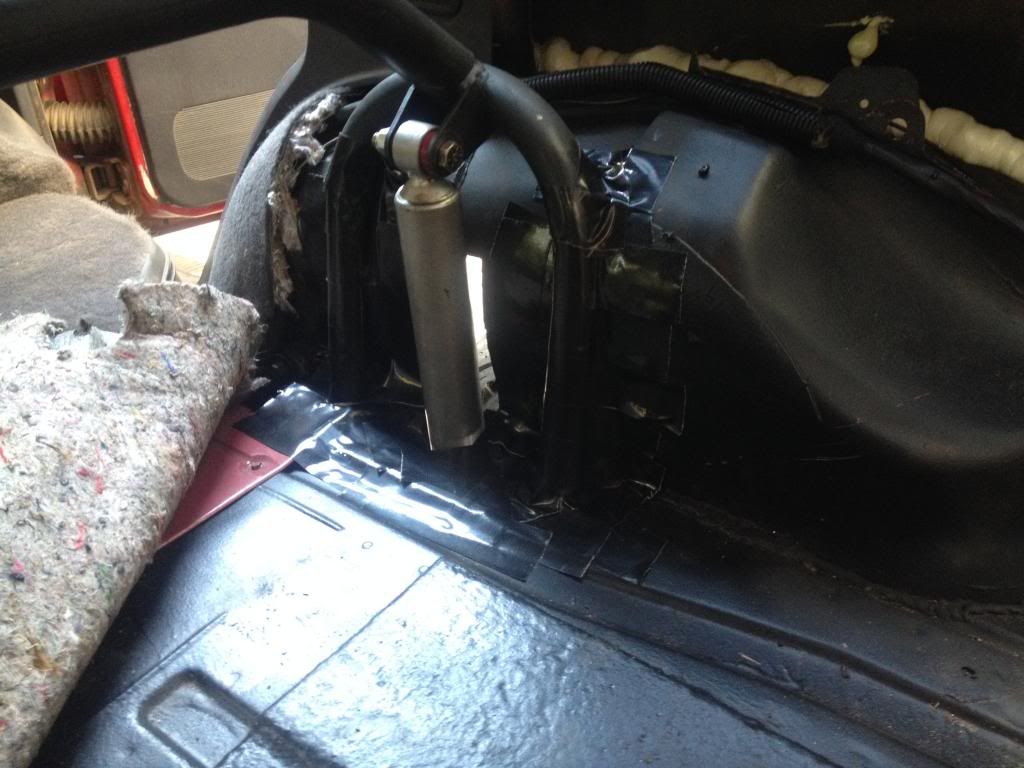

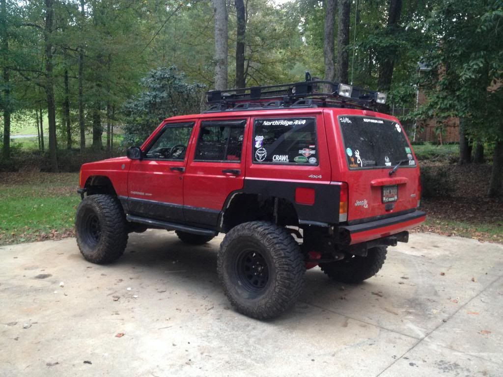

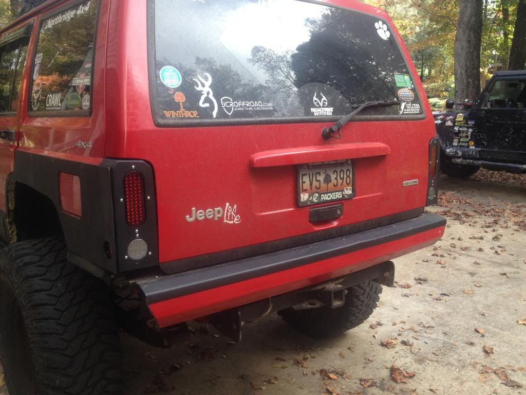

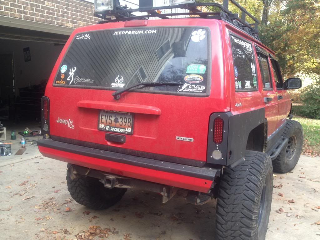

Ok so Im pretty much done with this project! My taillights come in tomorrow but I won't be here to get them. I'll probably get those on Saturday night or Sunday. Also will come up with a permeant cover for the holes for shock hoops and shocks to seal the inside up. Right now I just duct taped what I could lol. Also installed my pre 96 left side hand brake cable. With the stretch the factory one was too short so got a pre 96 cable and put it in. it was a little too long though had to cut the tip off and crimp and new one.. Works like a charm now.

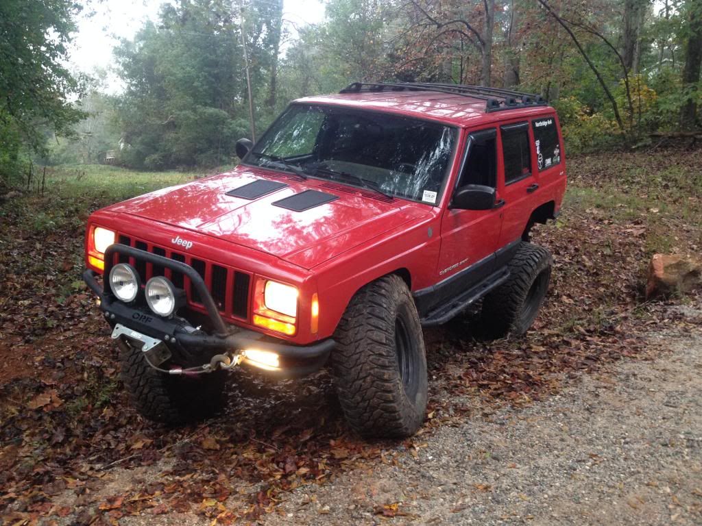

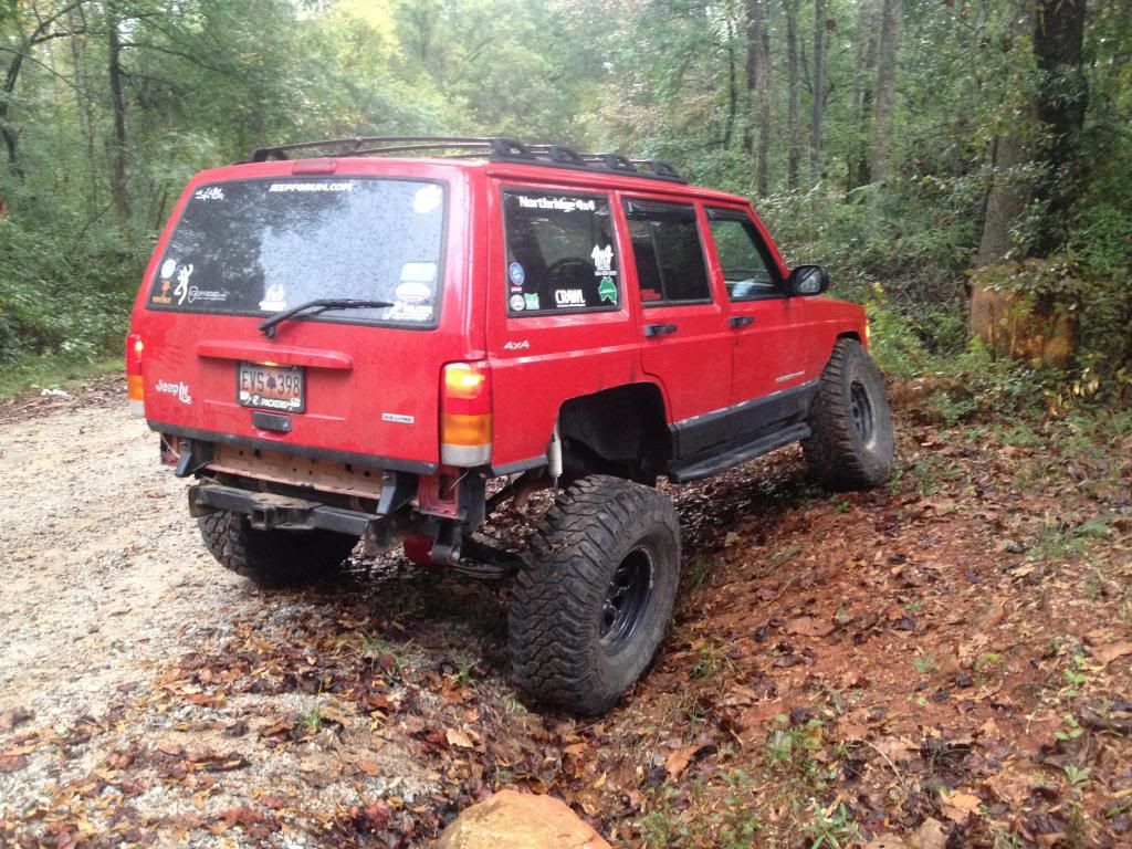

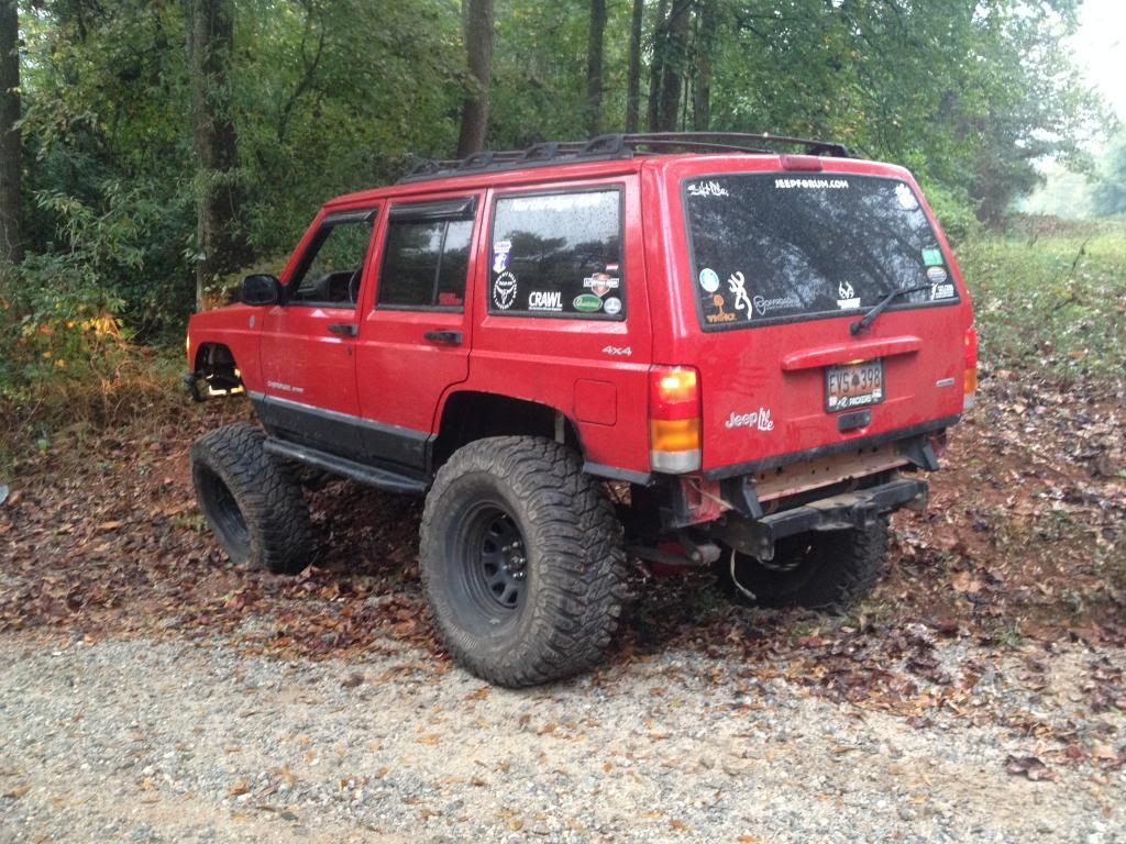

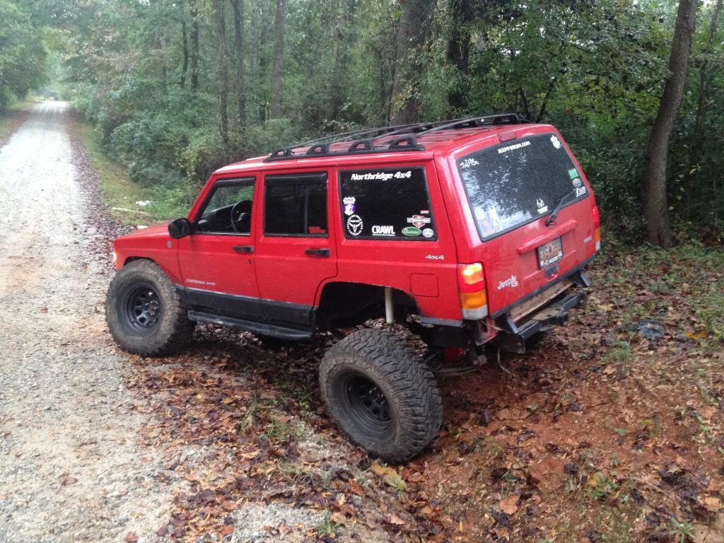

Got back from Durhamtown today. Had a blast! Stretch did great and the shock hoops are night and day from the stock position!! So far I'm very pleased with it all. LED housings came in Friday night. Still don't have the LEDs so will install as soon as I do. Don't have many pictures this weekend. If I find any I'll post them up
2014 Cherokee Of The YEAR
Rockdrummer93 is online now
post #735 of 1075 Old 11-06-2013, 02:00 PM Thread Starter
Rockdrummer93
Location: Taylors
Posts: 1,679

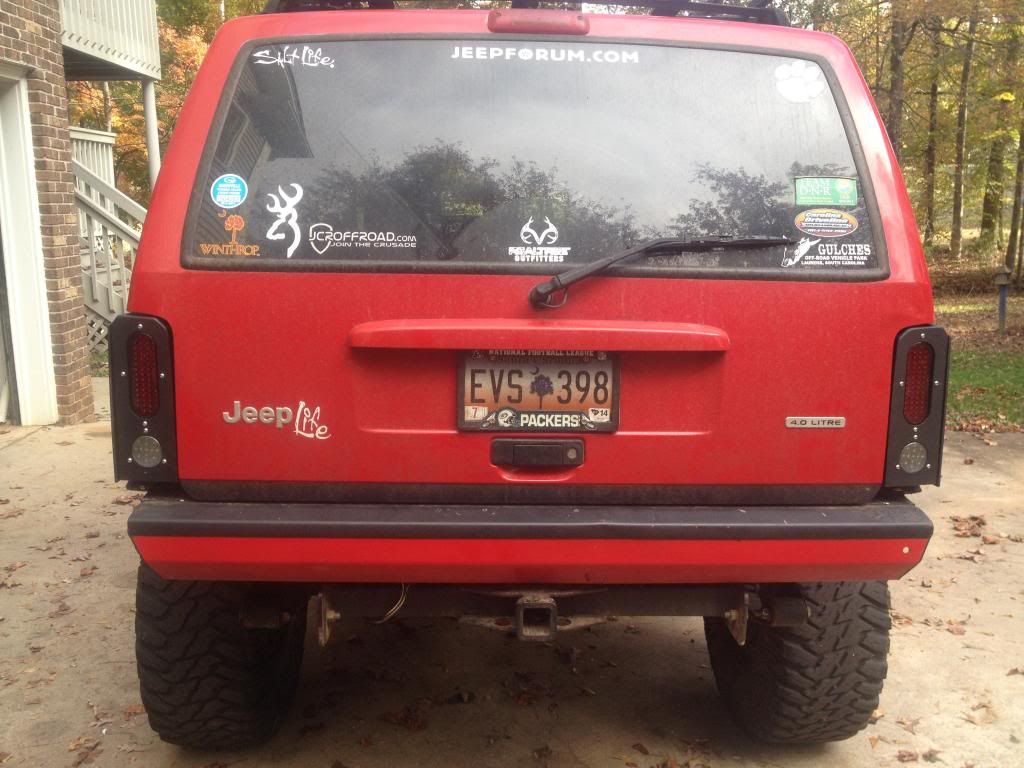

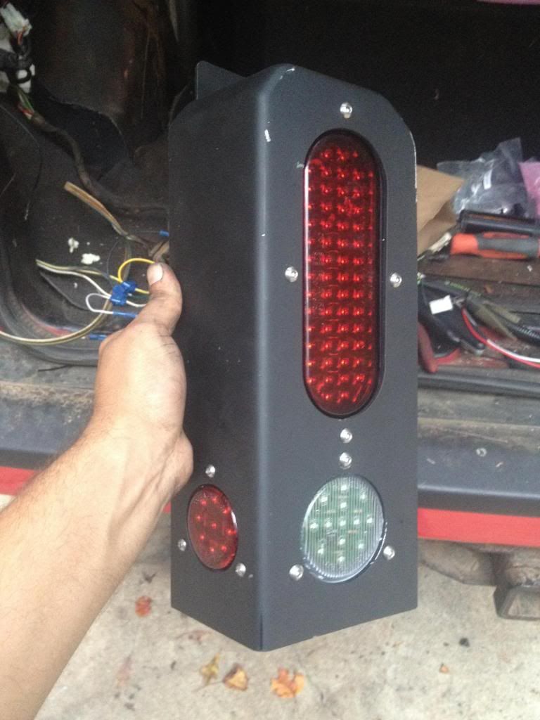

Ok so I know its been a little while since my last post.. Ran into some issues with the taillights since I got the housings. Well to start turns out the LEDs were not sent with the housings but from SuperbrightLEDs direct, so I had to wait on them for a few more days. When I received them almost a week later I went to wire everything up and they sent me the wrong connectors so had to call SuperbrightLEDs and have them send me the right ones.. Got them yesterday and started back at it. Got the driver side all hooked up and did a test before moving to the passenger side and everything worked. Get the passenger side hooked up and no brake lights, everything else worked except the brake. There was power being sent to the converter and the third was lighting up just no the LEDs. At that point I was fed up and quit with it for the night. Called the manufacture of the taillight converter I had and turns out it wouldn't work with LEDs. They gave me the part number to one that would work so ran out to the auto parts store and luckily they had one, grabbed it and finished it up.. FINALLY I get everything to work right and get it all back together, even replaced the flasher relay to one without the bulb out circuit, to stop the fast flash. Really happy with how they turned out. Also got my new left side axle shaft so hopefully can stop the leaking. I had nicked the one thats on there so cant keep it sealed. Plus now I have good spare. Probably going to stop for a little while now and start saving for the axle swap next spring. But we'll see.
