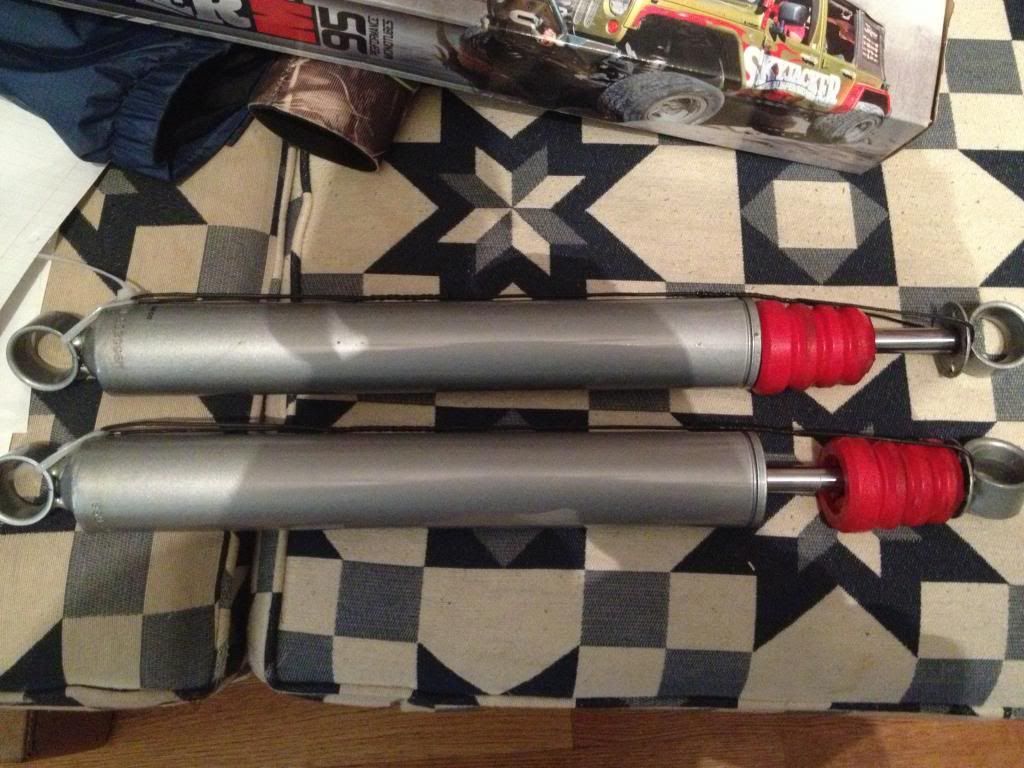

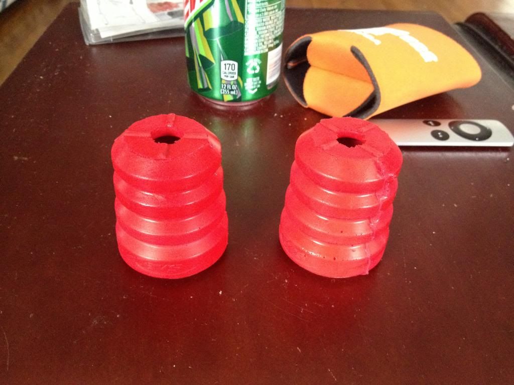

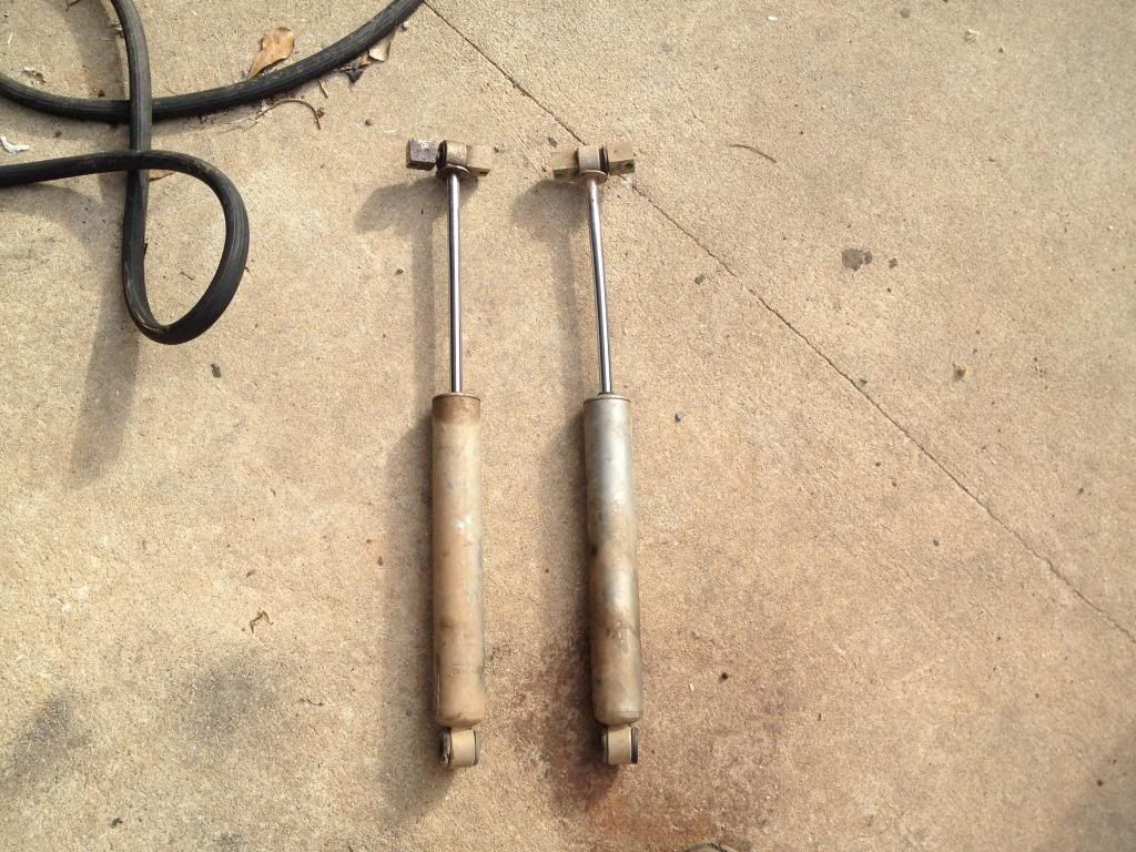

Daystar shock stops came in today. Glad I was still able to find a set. Spent about an hour to get them on because I was too stubborn to buy the little tool. truth is you don't need it unless your doing a lot of them.

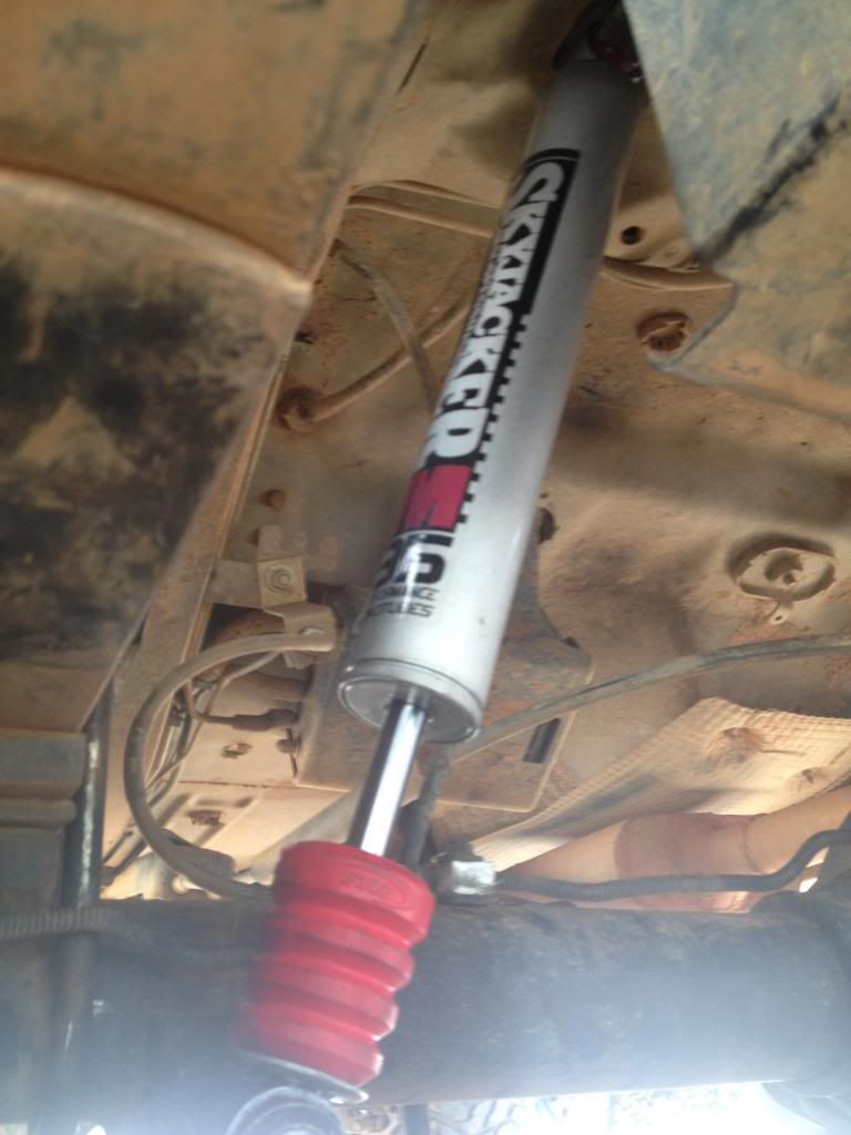

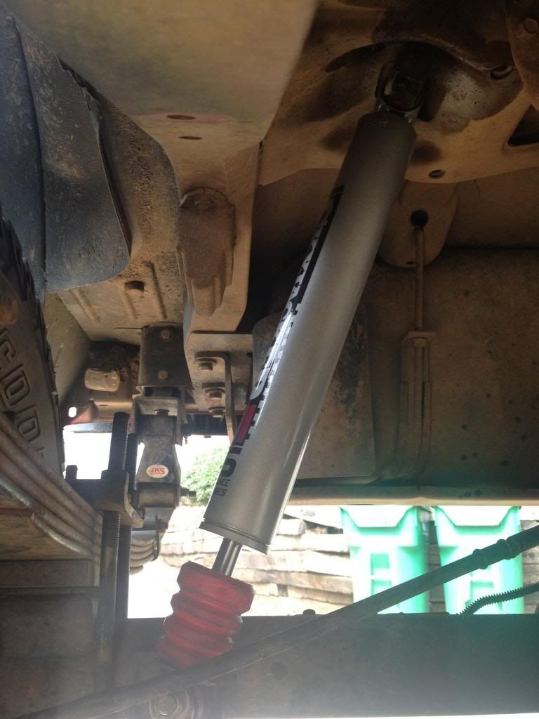

Got the shocks installed today. I noticed that my front mounted shock (right side) has less up travel then the rear mounted shock (left side). after some investigation I noticed that when the high clearance shock mounts where installed they were mounted flat with the pinion and with the pinion rocked back the rear mounted one is lower then the front. Went by foothills and talked to the guy there and he said he could roll the front one down a little or just install TJ style shock mounts. Im just going to let them figure it out next week and while they have it just have him fix the breather nipple as well.

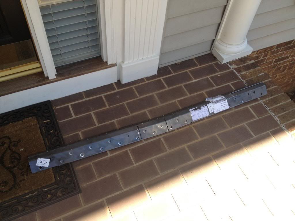

Took the Jeep to Foothills 4x4 today to get the shock mount moved. While they had it they moved the breather nipple. I also broke down and ordered the frame stiffeners, went with H.D. Engineering. Going to try and install them the week after next, though we'll see.

Frame stiffeners came in today. Will probably get to them next week. Hopefully will have them on and ready for Uwharrie.
