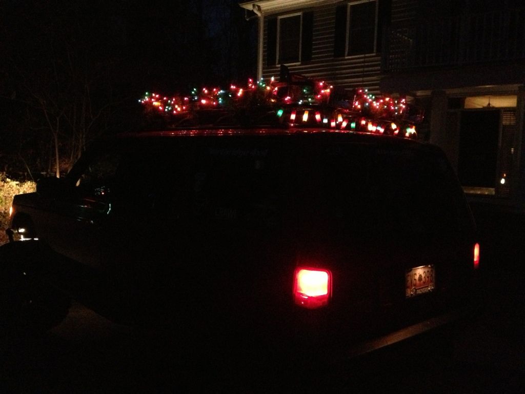

Got the Christmas lights working tonight.

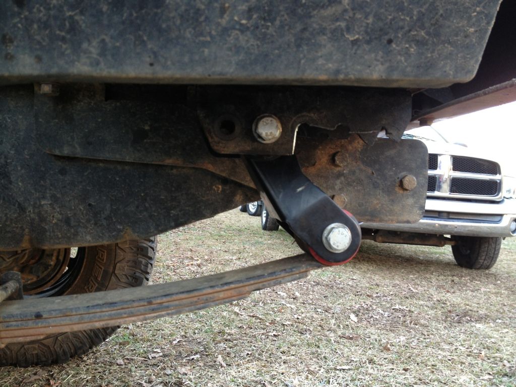

Got the new shackles on today. Started with the first hole and when I went to sit it down and it just flattened out with no shackle angle. So moved it back a hole and it sat like it should. It sits a little higher then it did before but not too bad. It rides a bit smoother and I've got ton more flex.
Sittin on its own weight:

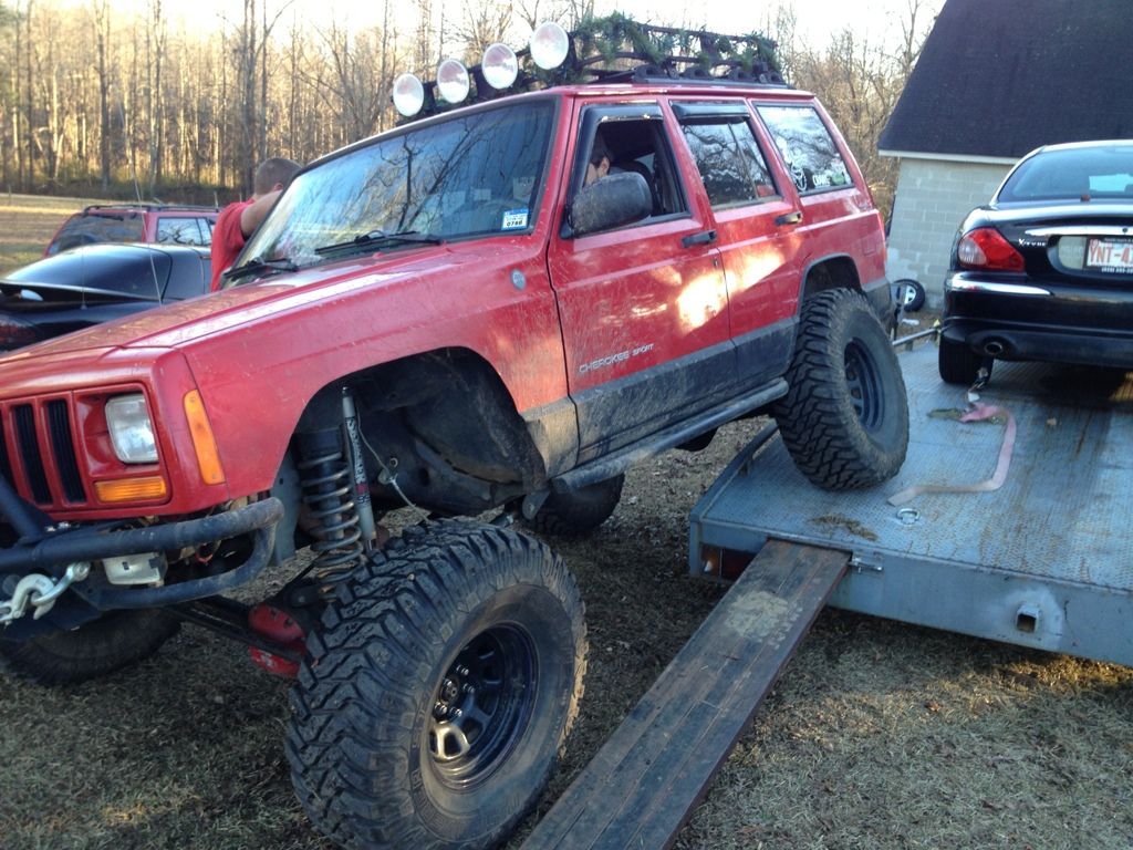

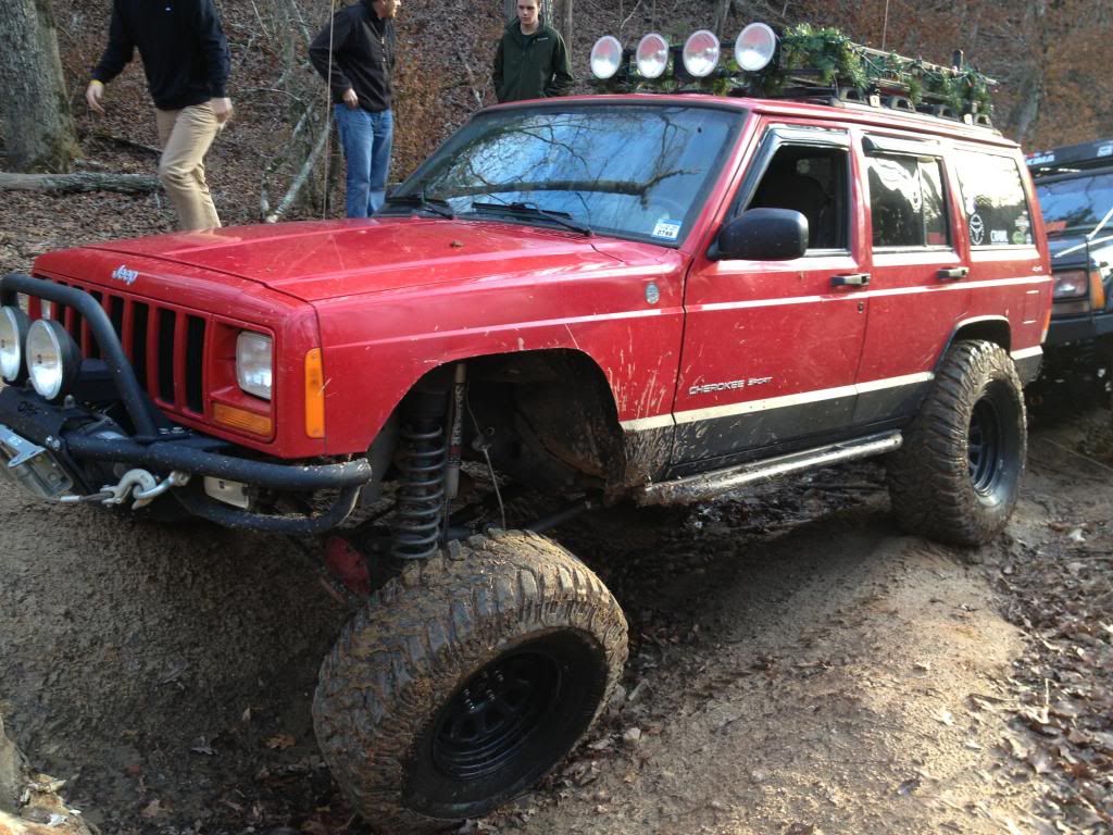

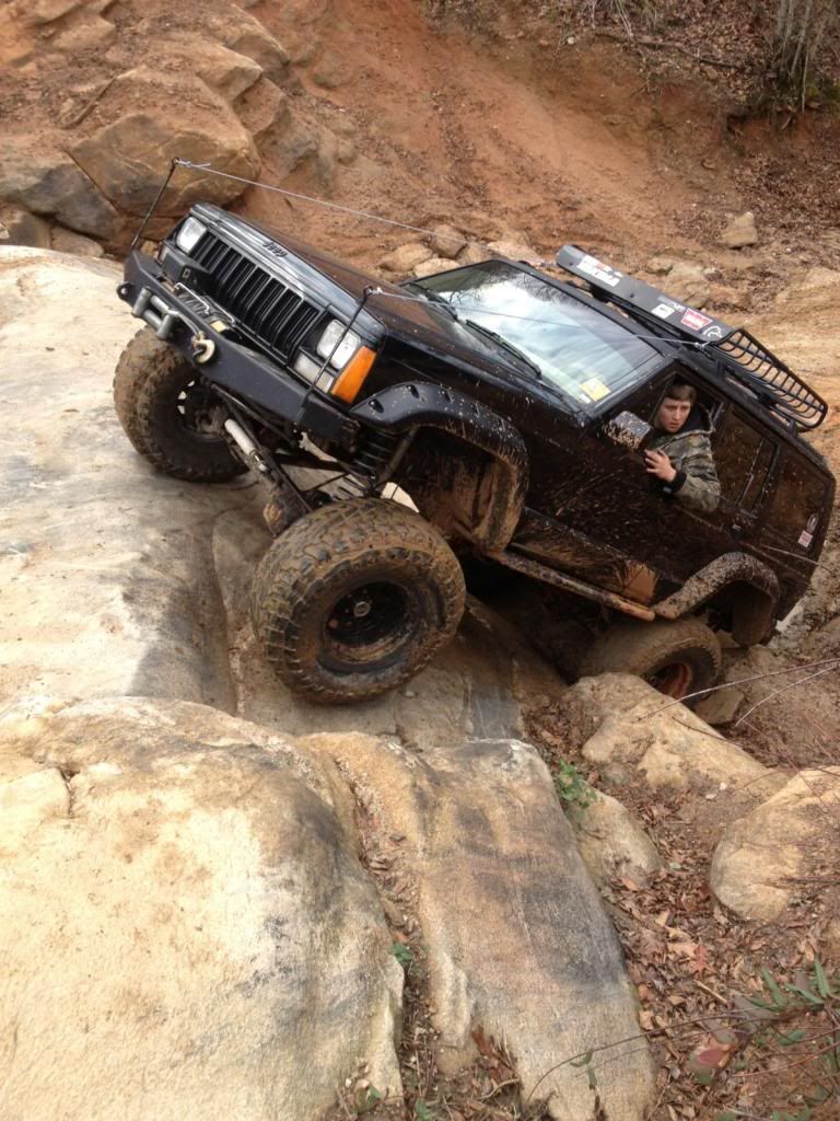

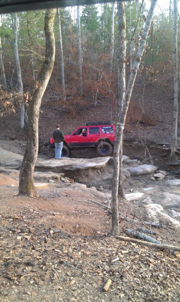

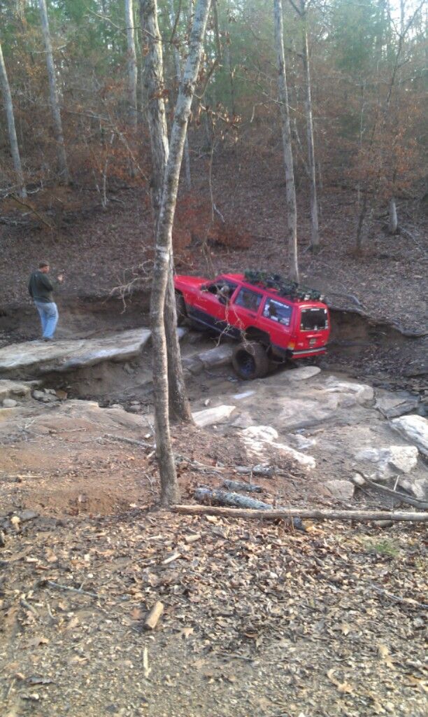

Went to Gulches last Thursday and Friday for our annual Christmas trip. Had a blast! Didn't do too many trails. Watched some Toyota guys almost break some stuff, then walked up the very trail they were trying. Me and my buddy Chase (cherokeecrawler) realized that we need to come up with some way to keep our shackles from swinging too far forward and bending/breaking our leaves after it almost happened to chase going up TnT rock garden. We were able to winch him up and bring his shackle back before it caused any damage. Here are some pictures.
Where Chase unloaded his leaf pack:
