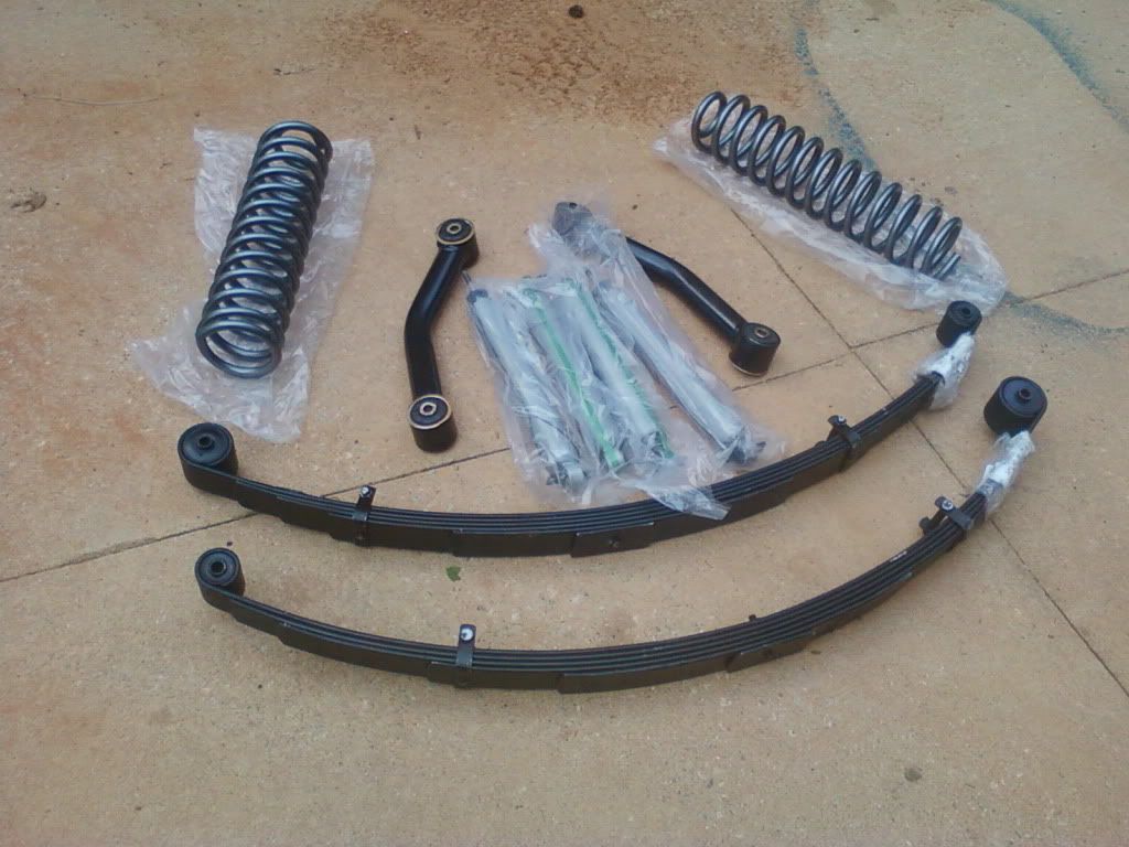

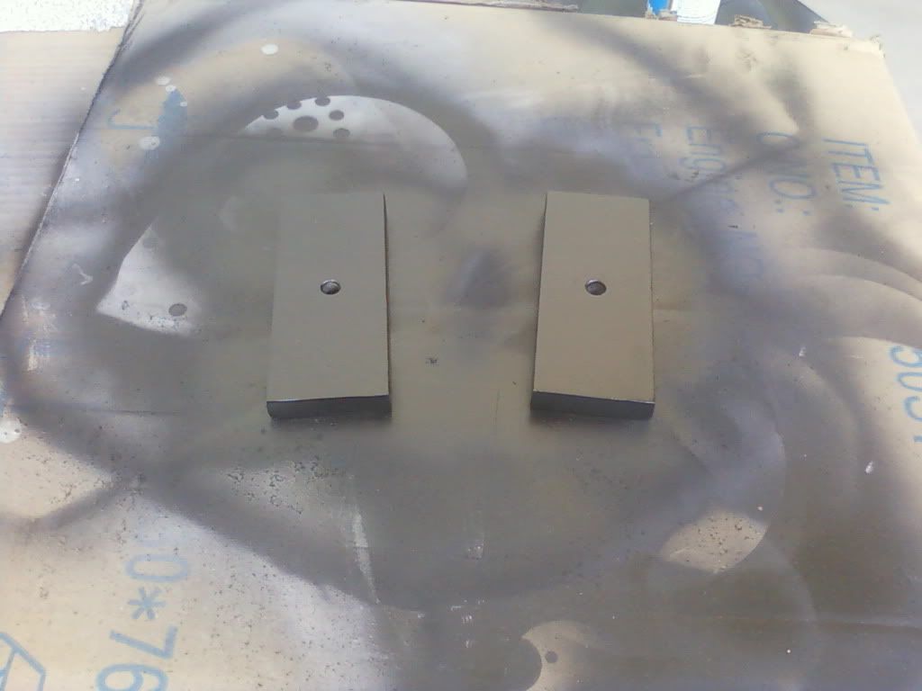

New lift came in today.. Hopefully will have it installed by the end of the day tomorrow.. I also cleaned up and painted my old half inch lift blocks and will be installing them as well with the 3/4" puck that I never installed.. that way I should come out to 5" of lift!

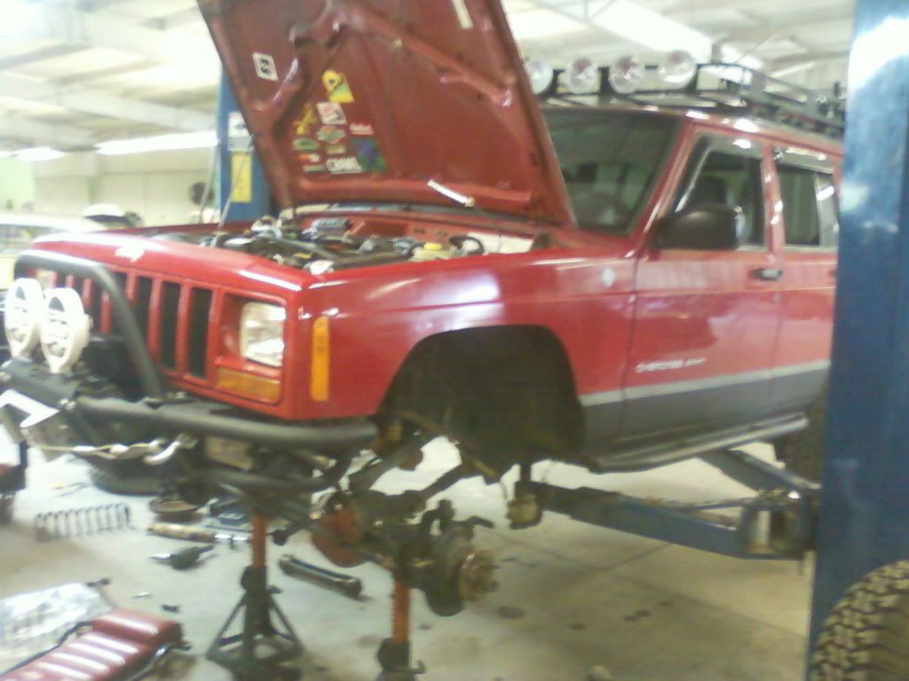

Well started on the lift today at work.. got the front done but the rear will have to wait till tomorrow But my boss let me drive the shop truck home so I didnt have to wait on a ride to get home..

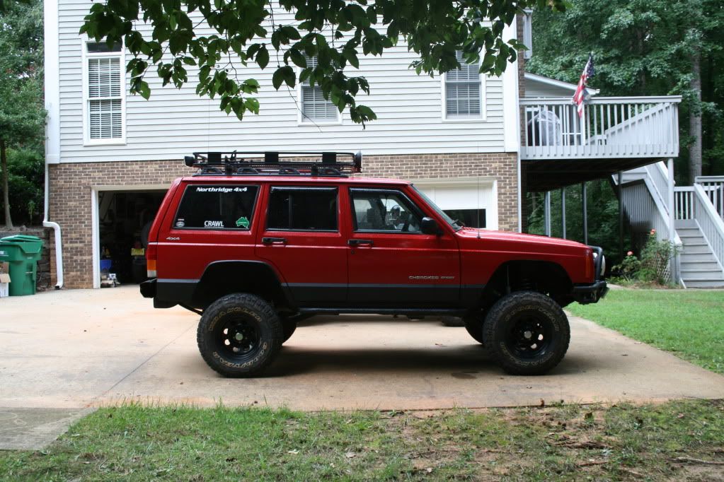

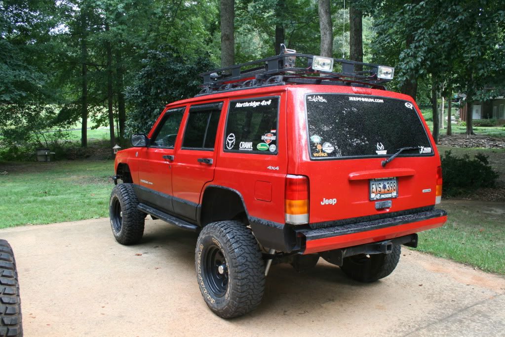

Well finished the lift today!! I am very please.. Rides very well.. I did have a little complication when installing everything though.. After getting everything on I couldn't get the track bar to align to save my life.. So I had to go out and buy an adjustable track bar.. lucky for me there is a local 4x4 shop here that had one in stock..
