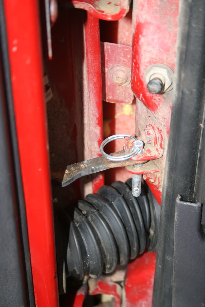

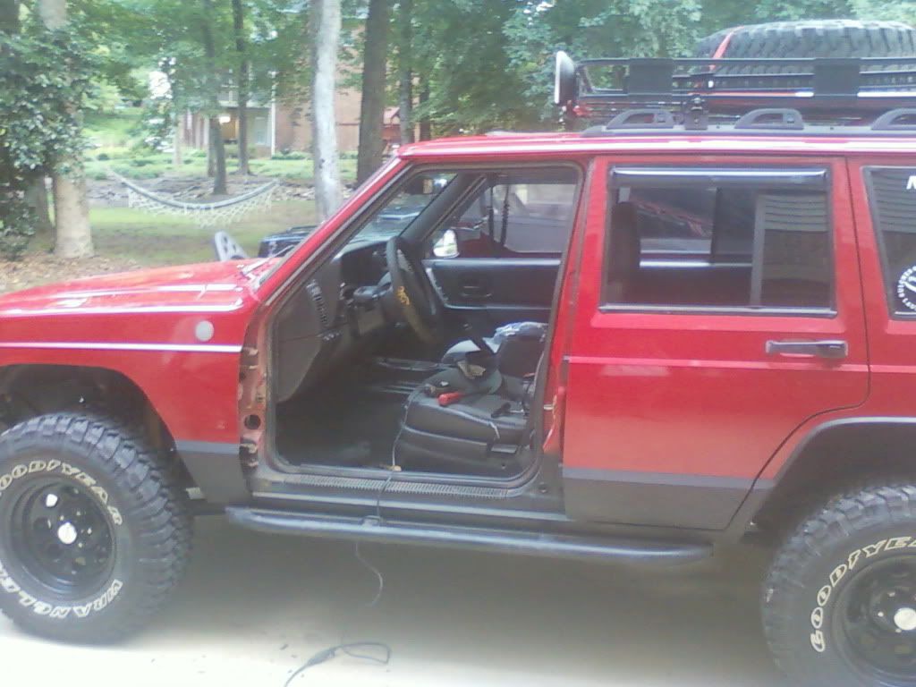

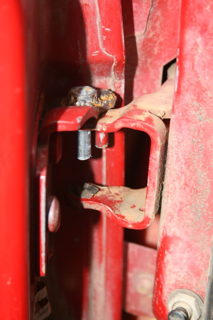

Well went doorless the other day.. Basically I got bored . took the hinges to the shop I worked at and modified them for easy removal. For a first time welder I believe my welds were pretty good.

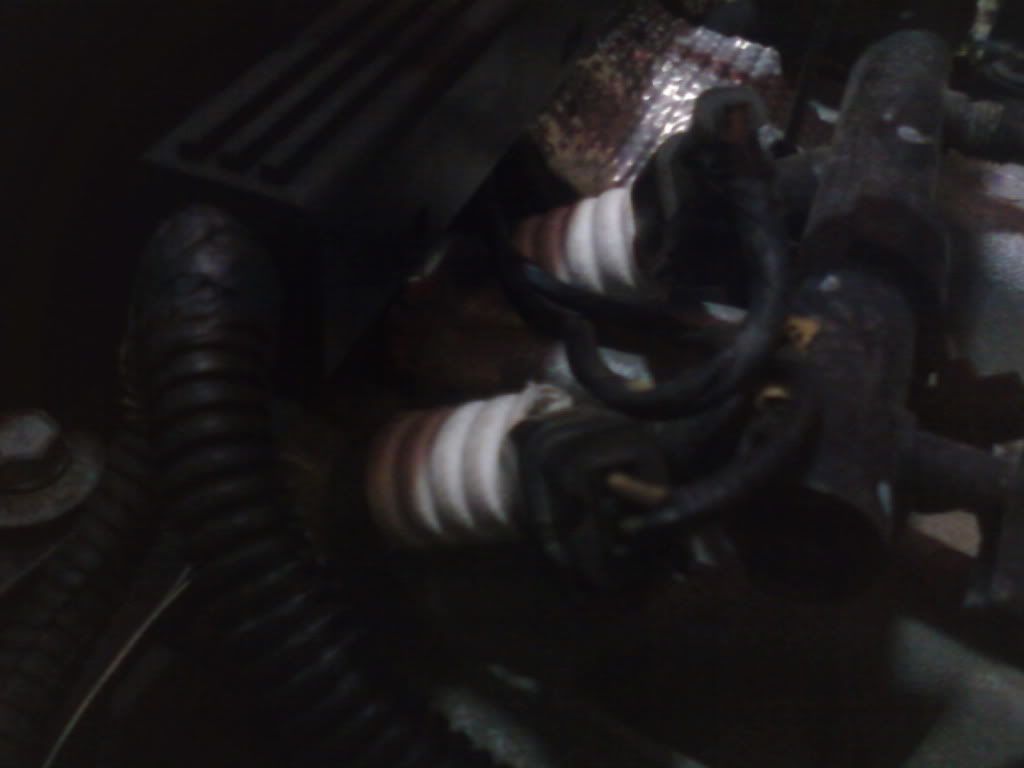

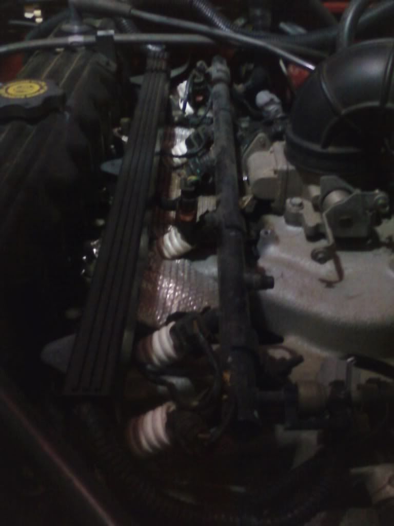

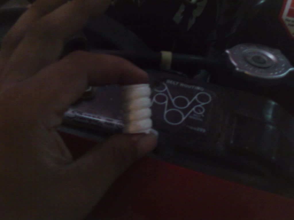

Well had the rough idle in hot soak problem for a while now.. but lately it has been getting real bad to the point where it was very hard to even keep the Jeep running.. So I did some research and found out that Mopar makes an injector heat shield. They said I only had to do wrap the one that was misfiring, but for $6 a pop I went ahead and wrap all 6 injectors
