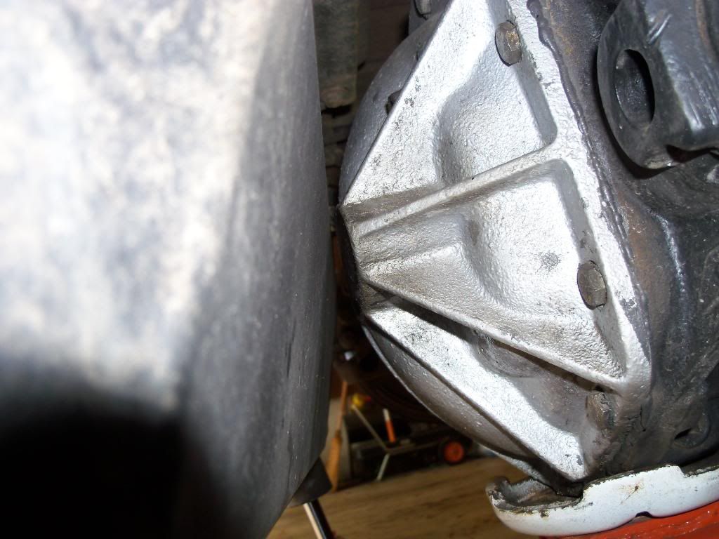

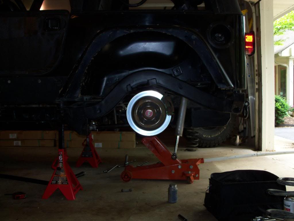

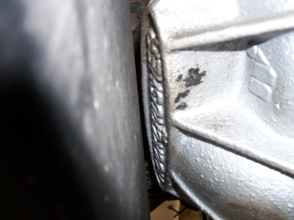

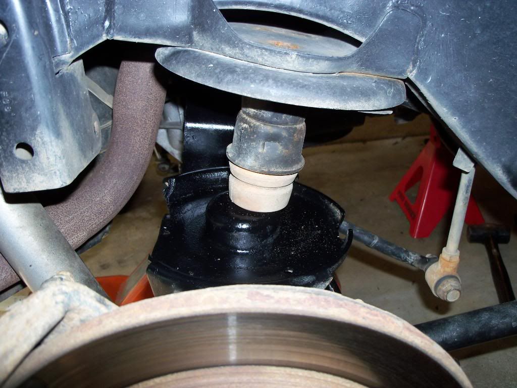

A couple more random pictures from last week. I adjusted the lowers out to ~16.25" (and lengthened the uppers for pinion angle). This is as long as I can go with the current amount of up travel and the constraint of the gas tank skid.
Full bump on both sides. I finally got around to cutting and grinding the old track bar mount down but didn't take a pic.
Diff-gas tank skid clearance. ~1/8"
I went ahead and did all that while dropping the gas tank to replace the emissions lines. Now time to go finish up the corners.

post #807 of 6555 Old 06-06-2010, 10:47 AM
TJdualsport
Location: OC
Posts: 2,894
wow that diff cover came close. lookin good man.

post #808 of 6555 Old 06-06-2010, 11:04 AM
Bennettj13
Location: Pendleton
Posts: 5,366
The dif cover isn't close until you are denting the skid but then again my gas tank smiles at me, so who knows.
