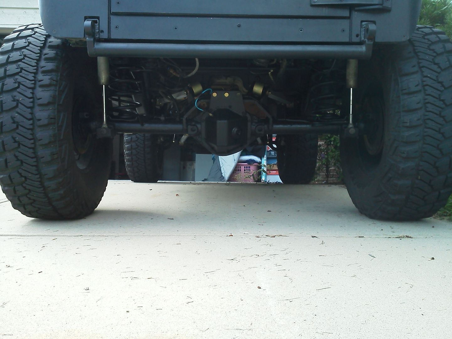

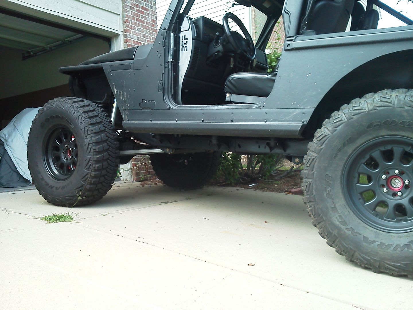

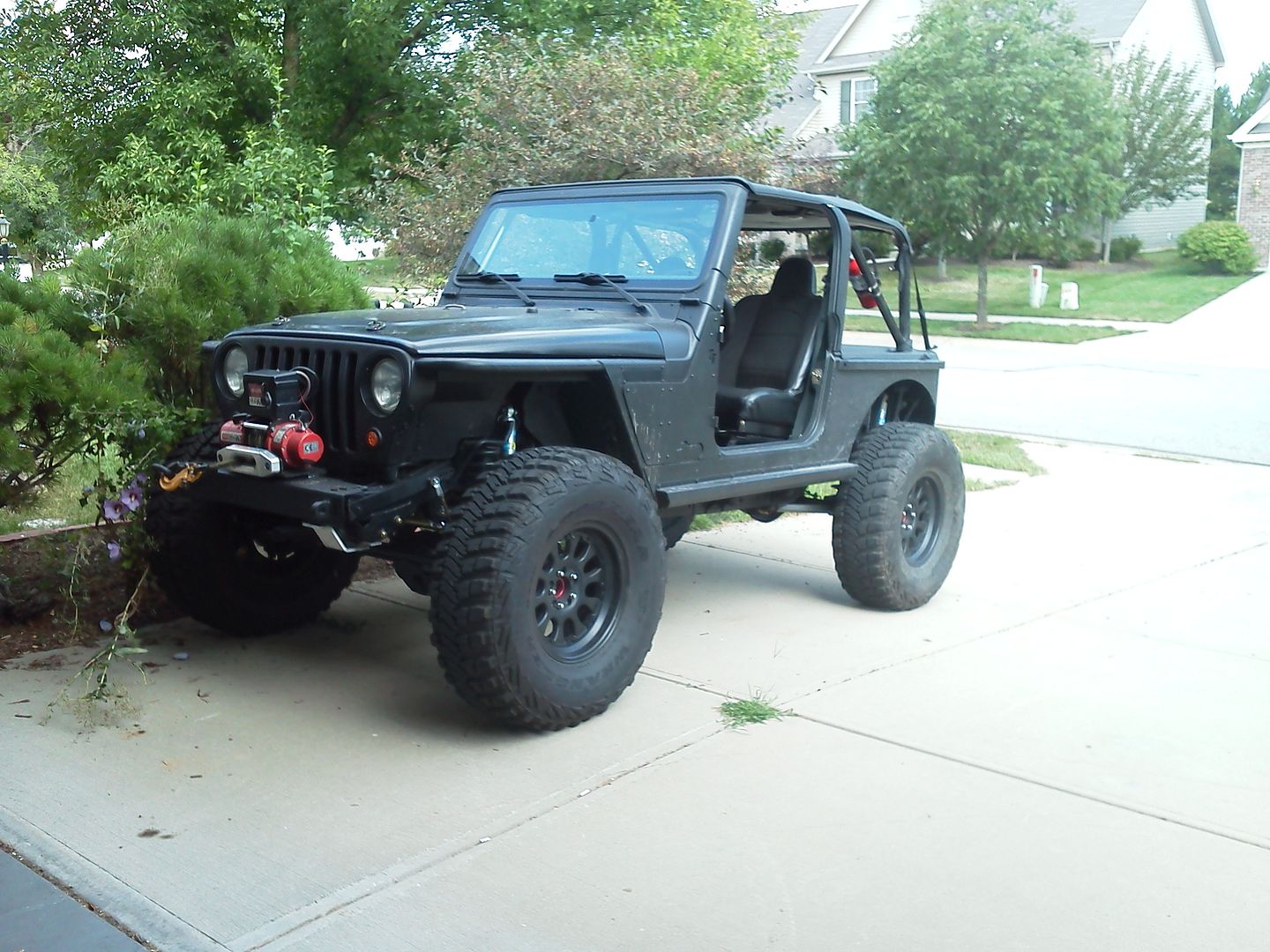

New aluminum links are in and the axles, bump stops and everything are now adjusted and optimized. 5.5" of up travel in the front, 6.5" in the rear. That's full hard bump with 1/2" or less shock shaft remaining. Not bad for a TJ with 20" under the frame and the factory track bar mount up front.

Posts: 4,468
Holy **** it's like I just spotted Sasquatch!!!
An actually picture of your jeep that isn't horribly dark or blurry...looks awesome!
20" under the frame on 37's? I'm close to that (not counting the skid) on 33's. that's impressive! Are you still running the 3" springs?
