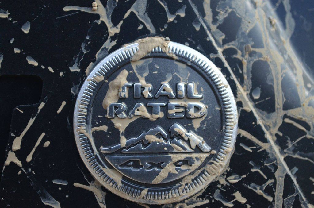

No, I'm running an invisible antenna that's mounted back in my glove box. The hole in the panel and tub is plugged and I put a Trail Rated badge over it. It's in the same location as stock, only on the passenger side instead of the driver. I always think it's funny when I see a highly modified TJ with the badge intact so I thought I'd play along, as well.

Right? It provides that nice extra touch of subtle class.....like going to a black tie event without your watch, which one should simply not do.
