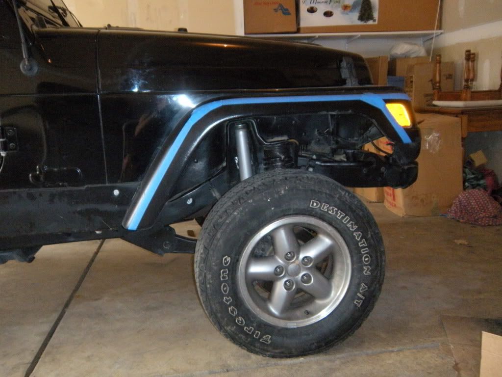

All I have now is the RC 2.5" with 31s, along with JKS sway bar links and track bars front and rear. I've added 1" up front to level it out, but that crazy flex picture is without them, at Interlake, no rubbing, enough bumpstop JUST to prevent rubbing (1" if I remember correctly). Those springs are nuts....slightly softer than your normal jeep spring, but long. It's like a slinky. I'm not running a BL yet, but will install the 1.25" JKS for the 35s. I have 7" between the edge of the fender flare and edge of the tire now. With 35s, I'll have 5" between them, so I'll add the BL in order to prevent rubbing. I'll also be trimming the edges of the fenders off by 1.75". With tires, I plan on jacking one end up to see if I can make the tire rub...If it does, then I'll add some bump stop. I'm planning on keeping the jeep nice and low with lots of diff and belly clearance. I'm very confident that it will work incredibly well. Up travel will be kept, ideally, at 4", since really, that's all that's needed. Down travel and clearance are more important to me, and the 2.2 shocks provided with the kit have some serious travel and built in bumpstops, allowing them to "bottom out" with no harm done. Wonderful shocks.

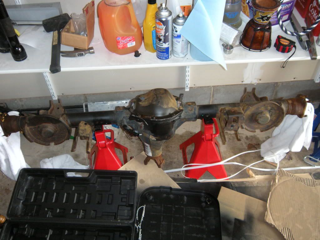

UPDATE: Work has begun. The Jeep will be parked until the job is complete. I'll be driving my dad's Ford Ranger until things are finished. Next on the list is finally pulling a HP D30, getting the axles sandblasted by a local guy with GREAT prices, and then hauling them down to Sunfire Offroad for some 4.88 gears. The Currie arms were ordered today and the tires will be ordered after gearing. I can't wait to be done with this!

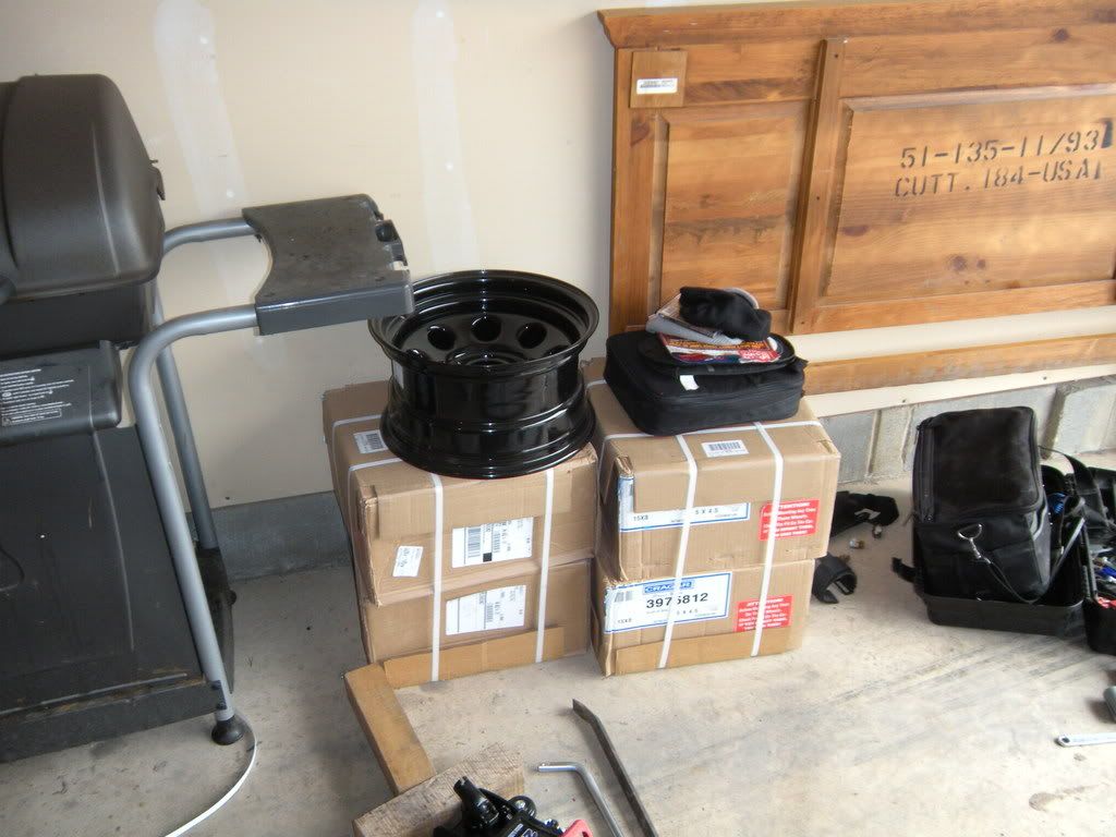

The Cragar soft 8's. Simple, cheap, look good.

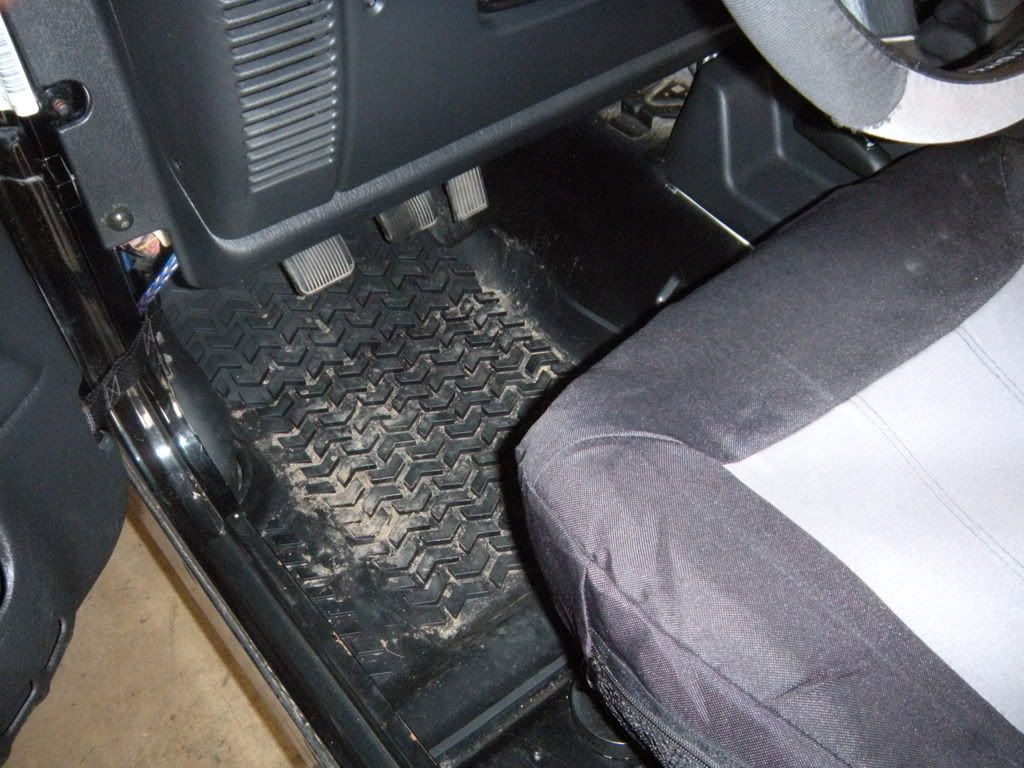

The quadratec floor mats...just in case anyone was wondering.

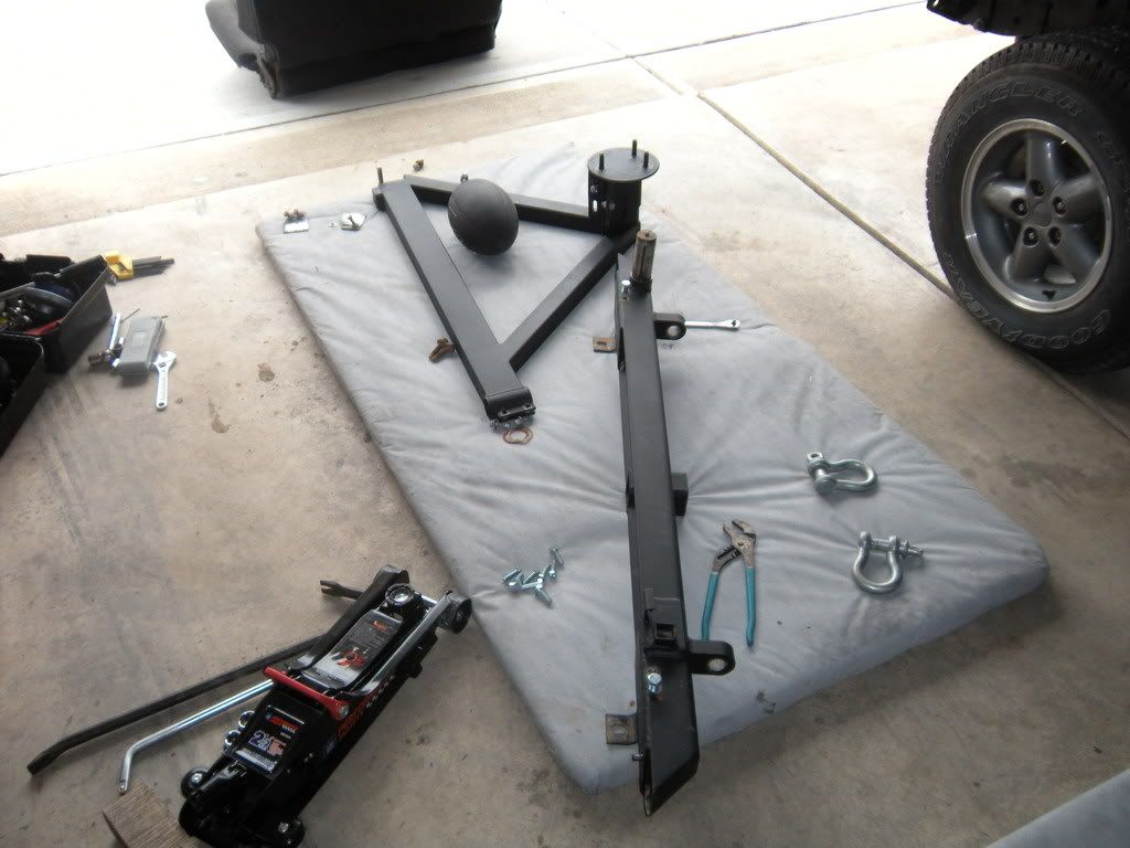

The powedercoating is already coming off of the Smittybilt tire carrier/bumper (my only complaint...doesn't help that I banged it on some rocks quite hard at Interlake) so I'm going to have it sandblasted then will prime/paint it. Should look very good. Overall a very functional, tough bumper for a great price....and it looks really good, too.

27" tires on 2.5"/1.25" BL....and yes, those are 1" spacers up front.
The Rubi 44.
The warzone.

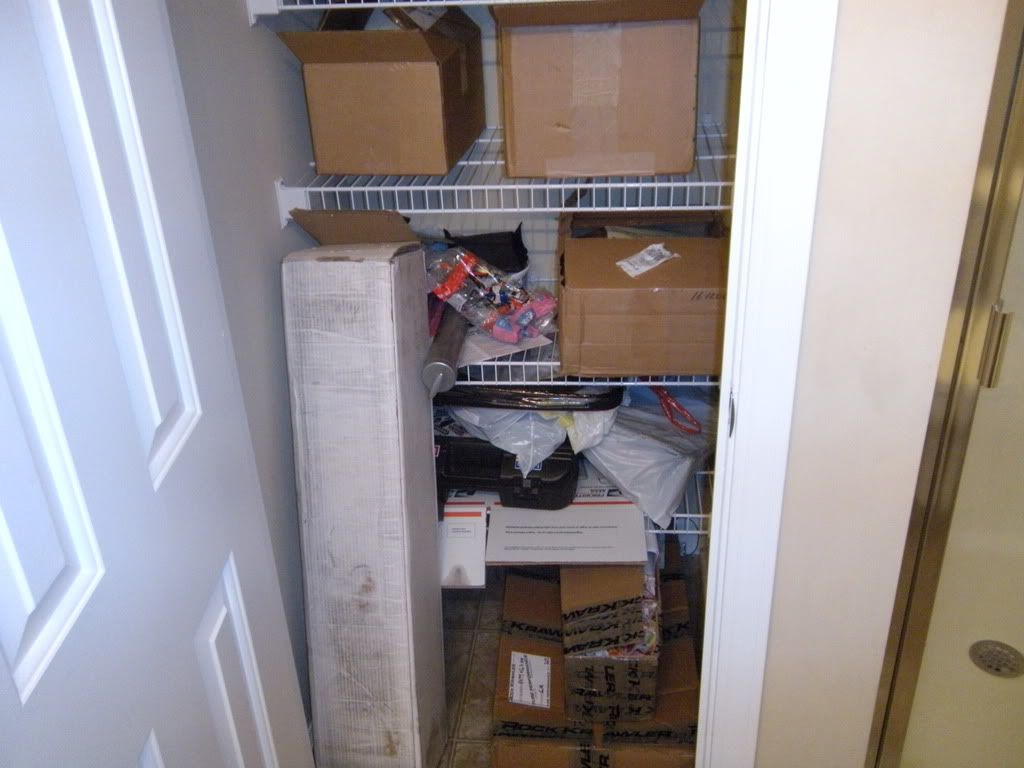

The closet....Superior & JB conversions & Rock Krawler, OH MY!!

that closet is modded better than my jeep......for now
